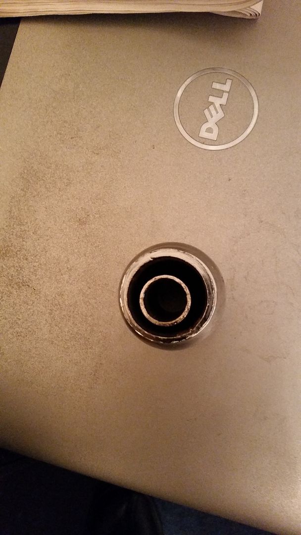

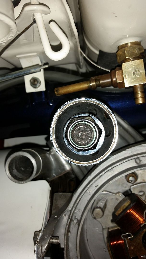

Firstly I know I should have checked more thoroughly but here goes.
Bought a pair of silent blocks from a supplier I have had parts from in the past without problem and when fitting the inner of one of them actually pushed out of the outer shell which I complained about and they sent a replacement without argument. Built the rest up as I was waiting and noticed the rear wheel was out of alignment. Checked rear hub and cone were ok then noticed the silentblock seemed out of centre the same way the rear wheel was out. Feeling a bit relieved I got out the replacement from the supplier ( which I hadn't unpacked ) :-(. More shite for the pile in the corner.

Postby Warkton Tornado No.1 » Wed Dec 16, 2015 11:47 pm
Way off track, but the photo made me smile. Not in a 'mocking' way....
Firstly the brass tap. I bet it's been 'ported' like virtually all of my old taps that......well, I've just kept them!
Secondly, though, the fully retarded '& then some' stator!
Jeez! We must be enthusiasts!
