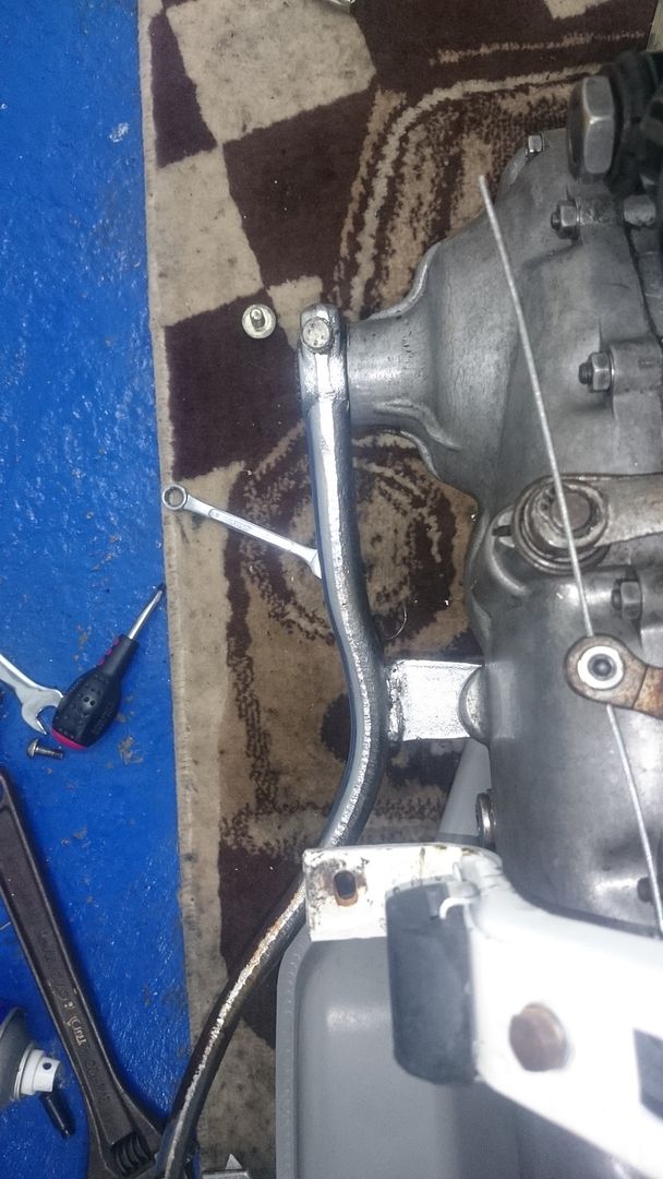

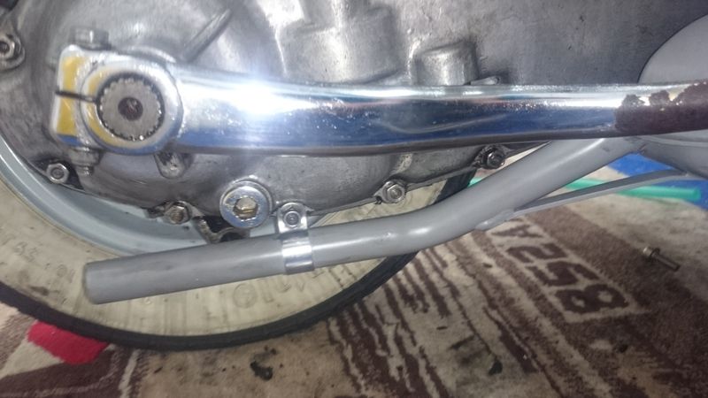

Hi.
Just fitted a Scootopia Ancillotti exhaust and the kickstart tab is catching the tailpipe. I've tried adjusting the exhaust but it's pretty rigid in that area with no room for adjustment.
Looking at the kickstart it looks like it could have been bent inwards by a fall, maybe.
Has anyone had any success being these kickstarts outwards in situ or will I break the shaft. Or would it be easier to buy new? Or is it meant to be that shape?
No ideas if the kickstart is aftermarket or original but it does sit very close to the rearboards.
Heres the pics.

Re: Kickstand hitting the exhaust
Postby CHRIS in MARGATE » Mon Dec 28, 2015 11:44 am

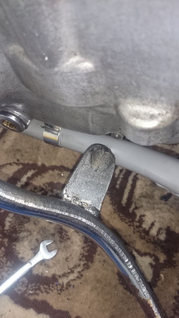

DO NOT TRY TO BEND IN SITU !!!
You could mark up the tab with a pencil and then take the offending area off if it's not too big OR take kickstart off and find somebody to shape it out a little.
When you put it back you have to engage the splines just above the return point..you'll see.
CHRIS in MARGATE
Posts: 4080
Postby HxPaul » Mon Dec 28, 2015 11:49 am
Its the correct shape.I'm afraid its quite a normal problem.Every kickstart pedal I've had I've had to cut about 1/2" off the tab so that it doesn't hit the tailpipe.

Postby Kristof Lammy pie » Mon Dec 28, 2015 1:26 pm
Many thanks guys. I will whip it off and maybe bend it a little and take a bit of the tab off with a Dremel.
Postby Kristof Lammy pie » Mon Dec 28, 2015 3:08 pm
All sorted, took the kickstart off and removed 1/2" off the tab. Works a treat.

Postby rossclark » Tue Dec 29, 2015 10:26 pm
Looks a lot like the pipe needs rotated more toward the engine side where it exits the box. It would then fit closer to the underside of the engine rather than angle in where the KS tab goes
