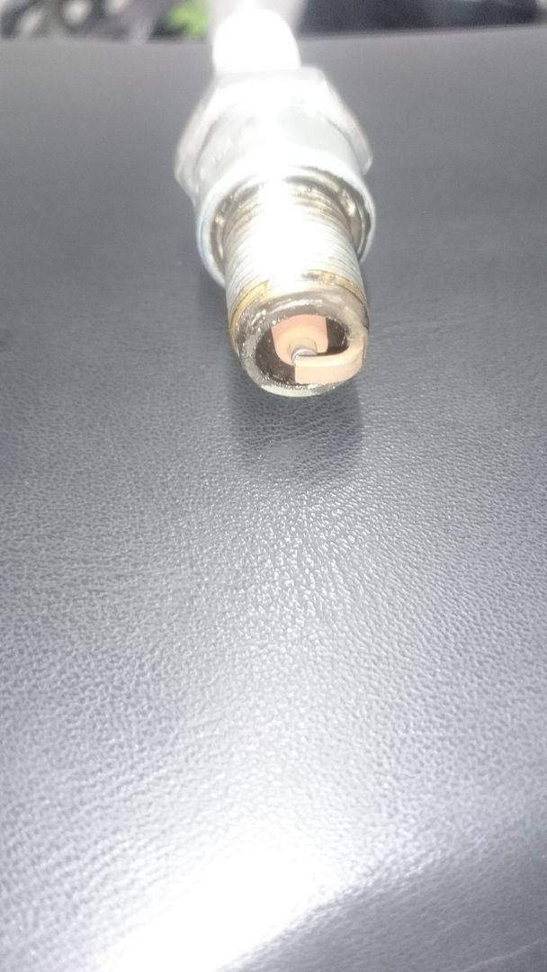

Postby Kristof Lammy pie » Sun Feb 21, 2016 4:20 pm
This is the plug now.

That spark plug is too white indicating too lean a mixture. Nothing to do with oil. It is the petrol/air mixture that is weak caused by wrong jetting or an air leak. Left as is it WILL do it again.

CHRIS in MARGATE wrote:That spark plug is too white indicating too lean a mixture. Nothing to do with oil. It is the petrol/air mixture that is weak caused by wrong jetting or an air leak. Left as is it WILL do it again.
Got to be honest. I haven't had it apart I just bought it set up from Waddo, so I would be surprised it's set up wrongly!
Also wouldn't the spark plug be the result of the seizure?

Kristof Lammy pie wrote:This is the plug now.
that looks rather on the lean side Kris.The engine has been running lean and too hot
if you are running-in its much safer to run a litle rich for the first few hundred miles .You ought to consider increasing the size of your main jet and perhaps your atomiser bore too.
Its tempting to think it best to increase the % of oil to lubricate a new engine but in fact more oil means less fuel and a weaker mixture which in turn increases the temperature .
Did you check the piston to bore tolerance befor putting the engine back together / providing that was all right I'd just keep running it but avoid labouring the engine like going up long hills or staying at a constant speed or high revs for long periods.

The theory of additional or less oil to weaken or richen the petrol/air mixture is well proven and can be used to fine tune your engine but you need to be experienced and understand the effect.
Stick with your 3%, that's fine but you must try and richen the petrol/air mix. It's the air that burns too hot; the petrol has more of a cooling effect.
Keep checking the plug and aim for mocha colour

whenever I read 'mocha' it makes me hanker after a nice coffee ;)
As the engine has/is seizing I think I might advocate erring on a slightly richer plug colour whilst running in . More like a digestive biscuit colour to go with the mocha coffee ooooooohh :D

Sorry that I've not contributed to this thread but, IMO, questions that still need addressing are carburation settings & spark plug manufacture & part number.

I agree,the fuel mixture could do with being richer,but that plug is far from being white.
