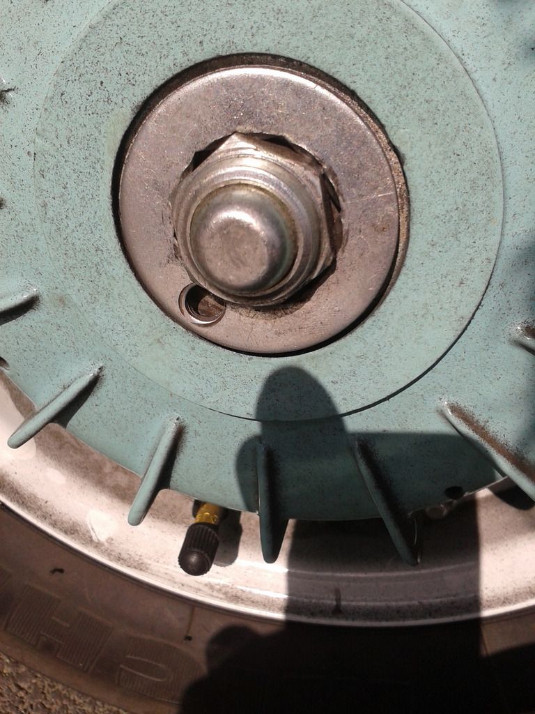

Went for a ride today, still running in (450km so far) so taking it easy on 30mph roads, the Li started stalling in 3rd and 4th and it seemed smokier than normal, so slowed right down and headed for home. Finally stopped completely.
Pushed the bike onto the pavement and found it very hard to push, like it was in gear or brakes are on.
Top end is not seized and plug is fine.
Panels off and the rear hub is well loose - the locking screw has come out and the hub locking plate screw hole is some 10mm anti-clockwise from the hub screw hole.
Wobbles loads sideways and ticks when turned... had to semi-carry it home.
I haven't a 27mm socket but will get one tomorrow. Don't have a hub puller either, though doubt I'll need one.
Is the ticking the sound of broken bearings? Worried that the driveshaft and hub splines etc are now shot.
A lot of stress for one screw... which was nice and tight when I checked it.
Any advice greatly appreciated, as I am not an overly confident mechanic. A bit concerned that the wheel could've come off.

Re: rear hub mishap, advice please
Postby MickYork » Sat May 14, 2016 6:20 pm
Hard to make a call until the hub is off, but a bit puzzling that somethings preventing the hub from spinning. Suspect part of the brake unit may be damaged and fouling the hub..........but all guess work till the hub's off. Splines in the hub/layshaft may be damaged but would hope the layshaft itself is ok.

Postby rossclark » Sat May 14, 2016 6:27 pm
I'd suspect looking at that that the splines on the hub have gone or that the centre boss beneath the locking ring has.
Postby roli150lam » Sat May 14, 2016 8:00 pm
Looking at your photo,the hole and thread seem to be in line?it looks like the locking screw has dug in to the locking ring tho.

Postby Andie » Sat May 14, 2016 9:58 pm
roli150lam wrote:Looking at your photo,the hole and thread seem to be in line?it looks like the locking screw has dug in to the locking ring tho.
Thanks but no, the locking ring hole is at least 10mm from the hub hole.Locking ring is well buckled too. Photos are just from my phone when it happened, so not the best.

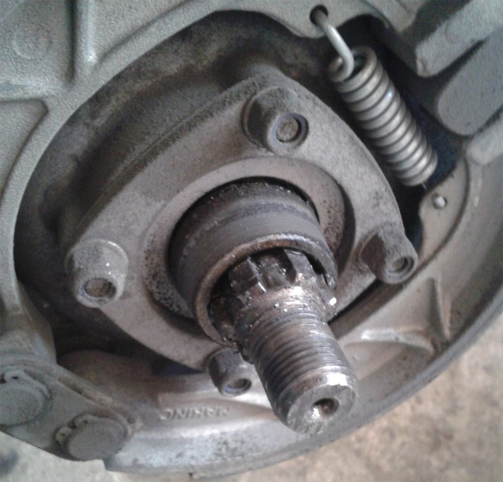

Postby Andie » Sun May 15, 2016 1:57 pm

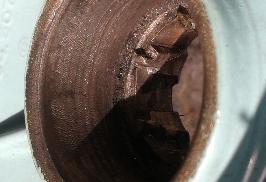

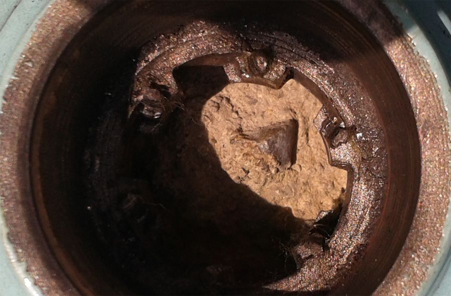

took the hub off this morning- didn't need a socket or puller as nut came off by hand!
layshaft looks OK, though covered in swarf - Image
the Hub is chewed up.
on refitting to check the wheel spins, I'm hoping the slight horizontal up/down give is the chewed hub and not a layshaft bearing problem.

Postby Digger » Sun May 15, 2016 6:28 pm
Andrew
That's exactly the same as my hub was.
Don't ditch as you can convert it into a brake show trimming tool. :D

I hope you do not mind a couple of ‘smartass’ observations whilst you are still, inevitably, ‘licking your wounds’ which, thankfully, are no threat to your health?
The M6 nyloc nuts on the rear hub seal plate are serving very little purpose as the nylon locking portions are not engaged with the studs.
The conical part of the hub shows signs of ‘chatter’ which confirms that the hub was loose for some time. That is not a ‘told you so’ remark but just to remind anybody that ‘best practice’ is to lap in the cone to the hub using grinding paste.
In fact, I am not advocating that other’s do this, but if the hub & cone are matched in such a manner, & there are no defects such as cracks to the splined part of the hub, then such hubs may be re-used with caution if you have faith in your own capability & a good understanding of the concept of the taper drive. The splines are there merely as a locating method until the torque via the correct method is achieved.
Unfortunately, in your instance, the splines in the hub appear to be showing signs of cracking & there appears to be a crack in the conical surface itself.
I wish you better luck with the replacement.
Postby johnnyXS » Sun May 22, 2016 2:09 pm
does anyone else think that the hub splines show insufficient bearing on the layshaft ?
It looks like the layshaft hasn't been pulled through sufficiently or the layshaft shimming is wrong somewhere?
Maybe its just me but I would have expected the splines of the hub to engage on the splines of the layshaft at least 3/4 engagement yet that hub looks like they engaged about 1/3rd ?
Could the original cone be poorly dimensioned not allowing the hub to engage fully with the layshaft?
