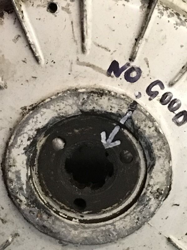

Postby Stevepshipley » Sat May 28, 2016 1:21 pm
Following the debate about what actually secures the hub and is it just down to the cone and correct torque. This hubs been at the back of my garage cos I thought it was paggered.....
Can I, would you use this ????

Postby Warkton Tornado No.1 » Sat May 28, 2016 3:58 pm
If that was 'all' that was wrong, the conical surface & proper, hard cone were well matched via lapping in, then I would give it a go.
I can take no responsibility for your decision, actions or competence so don’t come running to me if you fall off & break both legs! :roll:
I strongly recommend that you torque it up, & fix the locking plate & run it a few miles cautiously as it is an old hub in any case.
Then I would remove it just to test that the ‘fit’ had been maintained & carefully examine every aspect of it.
If all seemed well, I would then re-fit it & run it.

Postby Stevepshipley » Sat May 28, 2016 4:09 pm
It was off a 62 Spanish S2 that I restored, I was fascinated by the debate around cone fit and torque. Instead of throwing it away I'll keep it as a spare.
Of course I won't come back to you WT, but I am pleased you commented - ta
