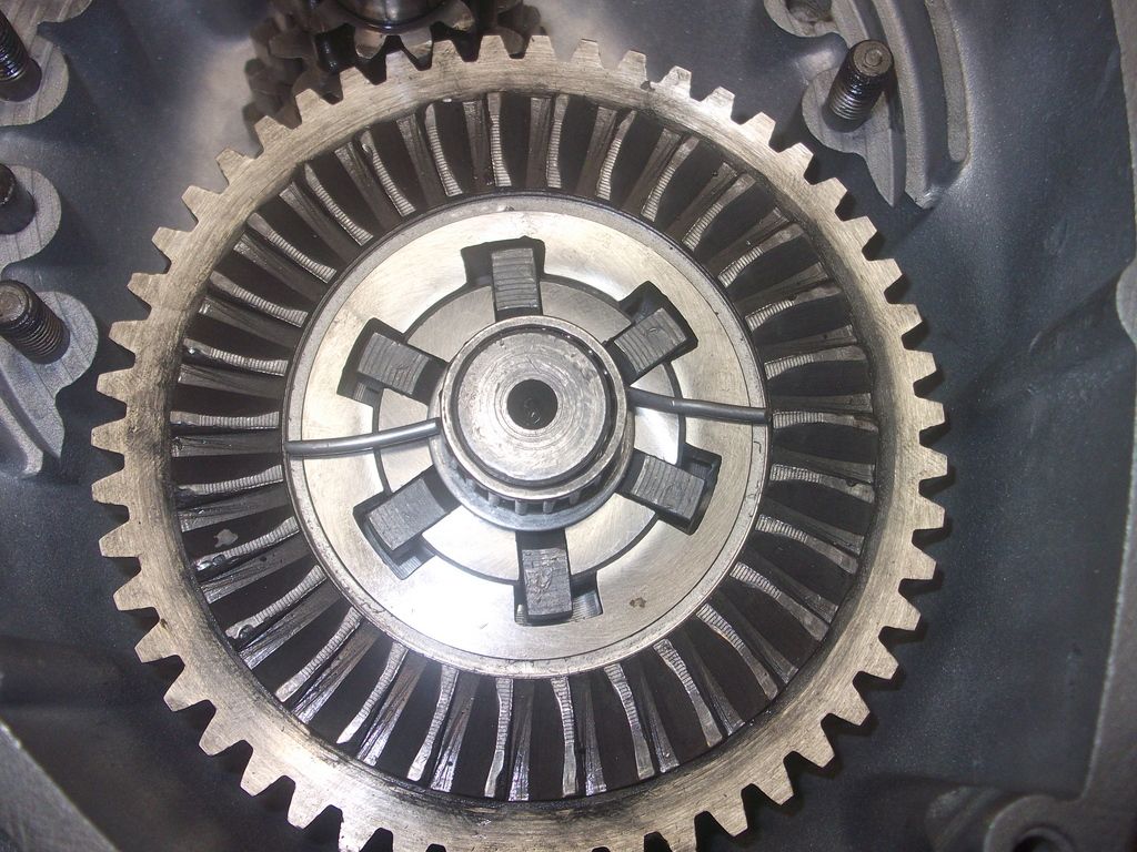

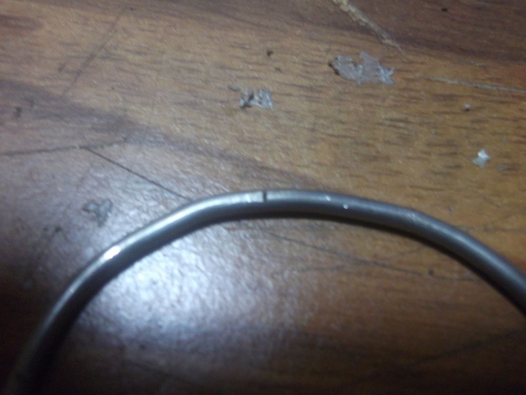

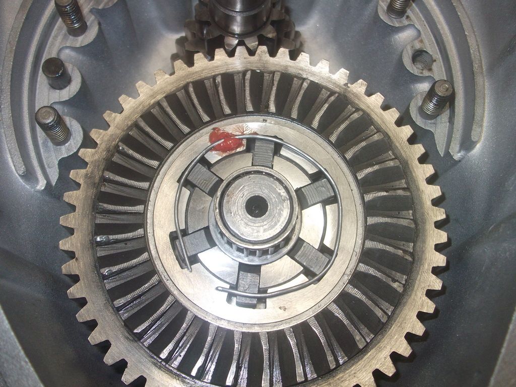

In case it's some use to someone this is how I measured my shim gap.
First technique I tried was no good as the solder just got jammed between the layshaft race and the layshaft itself.
So I did this. Held it in place with a blob of grease.
As my gap was just under 1.8 and my solder is 2.0mm the crushed part is only just visible. This technique has the limitation of needing the solder to be just a little thicker than the gap, but it's still useful at times.
