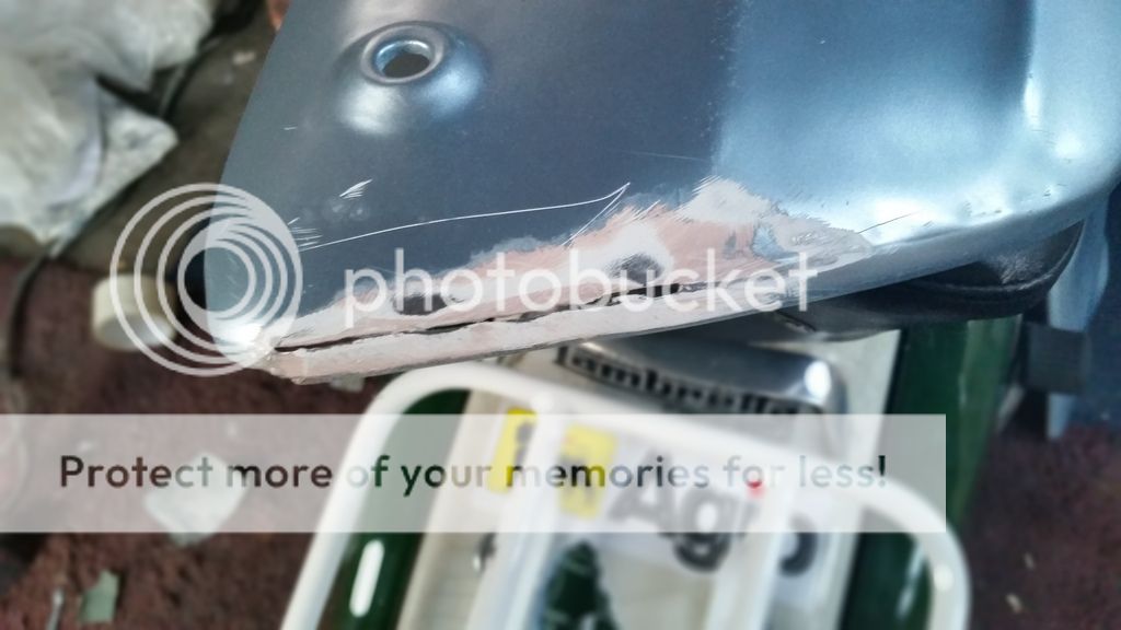

Any idea if this is repairable? Back end of a SX panel , looks like its been cut as opposed to broken :? :? Would brazing work?
PS panel does actually fit

Anything is repairable - you just need to find someone with the necessary skills.
Can't see anything too tricky there.

As Digger says
Strip it back to bare metal as it looks as though theres some filler in there as invariably the hole will be bigger than it looks at the moment. Any competant welder should be able to fabricate a small section and butt weld it in place, once ground back the repair should be pretty much invisible.
