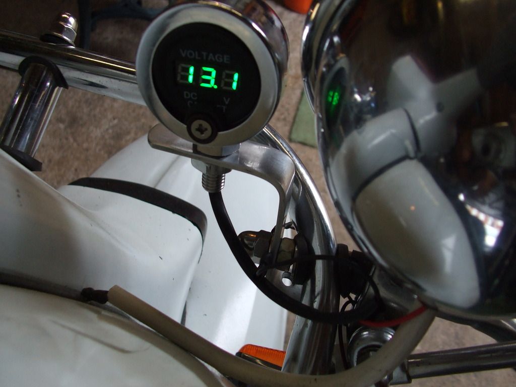

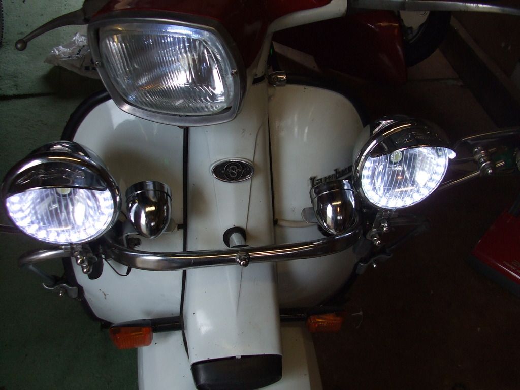

Agree with Coaster.The wassell is a worthwhile improvement no dimming of lights when you brake and no need for LED rear lights .I also have conventional 23watt indicator bulbs.
Voltage goes up to indicated 13.8 when running with lights on.(front spots have 27 LEDs in each spotlamp (as daytime running lights )

Postby kennystag » Sat Jan 28, 2017 10:34 am
Hi Clive,
I love your volt meter.
Stag
8-)
