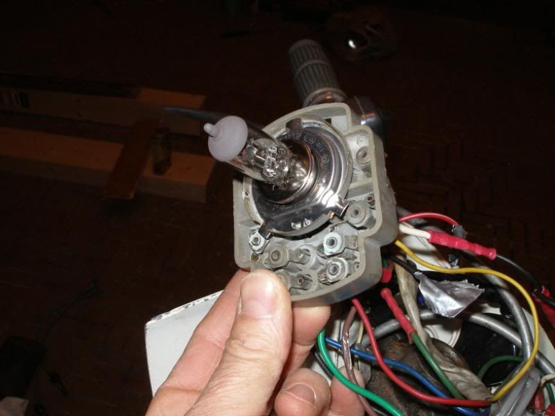

I've seen a few conversions using modified H4 lamps in Lambretta headsets, but is there an option where a complete (unmodified) H4 lamp can be fitted?
If not, why not?
(Or can you but the H4 lamp-holders?)

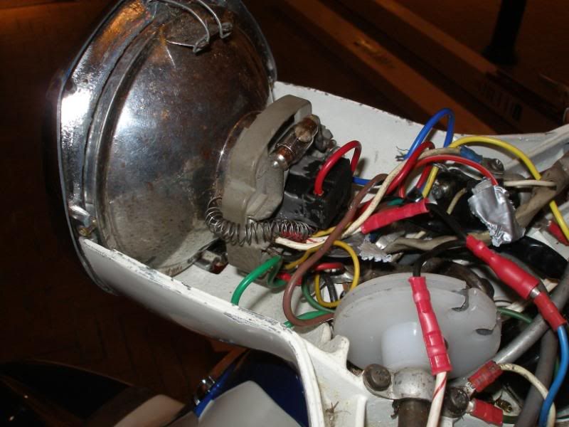

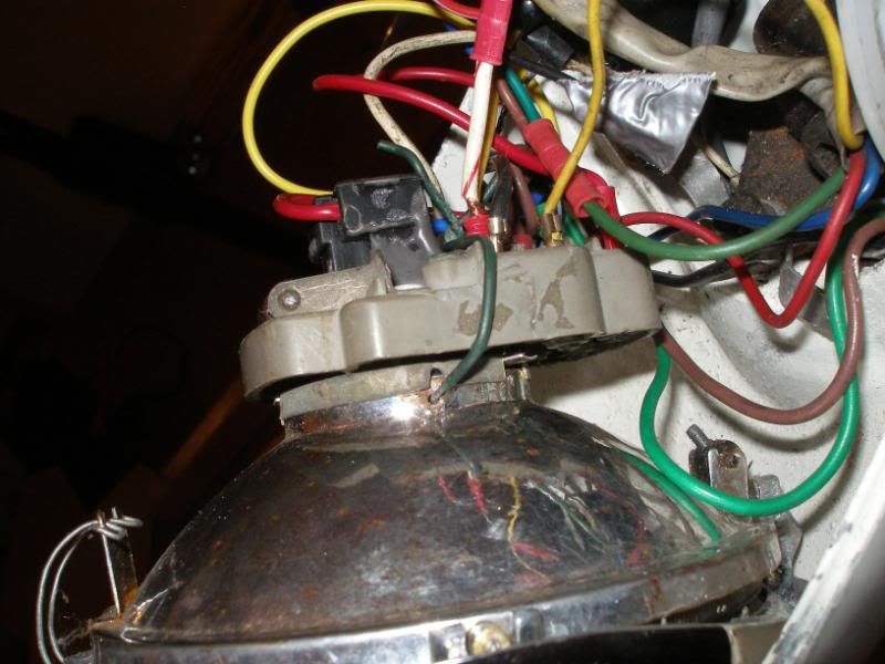

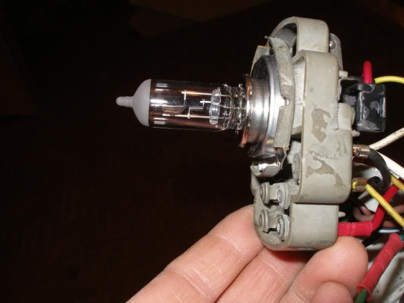

It depends on the make of the lamp holder Martin but I don't think I had to do anything to the lamps in LiS or the Jet, I just needed to cut some slots in the metal surround part of the holder for the 3 tabs on the lamp to sit in. The hole in the plastic part needed opening up a fair bit as the H4 base is bigger. Here's some pics from when I did mine several years ago, ignore the method of retaining the holder, I made a proper clip for it after the photos were taken.
I used JB weld to secure the H4 connector which came from Halfords
