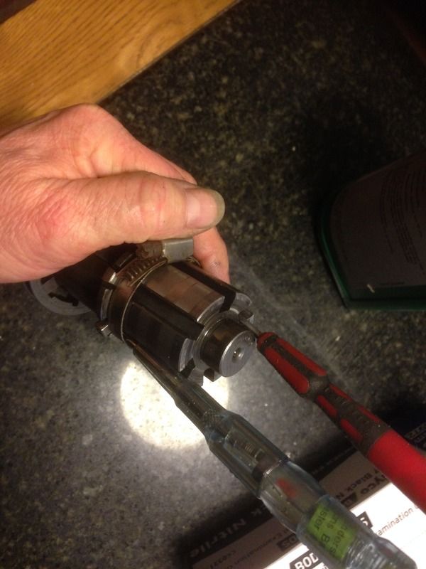

I dn't have any measurements Adam but I did re-assemble my gearbox on Sunday so the experience is still fresh in my mind ;) My spring is an original Italian LiS one and with the spring and both ball bearings in place the balls were just beyond the outside circumference of the layshaft but were easily pressed inside the Jubilee Clip I use to hold them in place while manoeuvrings the sliding dog. Once the Jubilee Clip is in place it takes very little leverage with a couple of electrical screwdrivers to compress the balls enough to get the dog to slide over them if the makes sense? I reckon I would have struggled with a kick start piston spring :?
The gearbox has very nice feel, not too stiff and it doesn't jump out of gear

Coaster - It seems as though you had to go to considerable lengths to fit yours, whereas I typically find I can manage by hand. Interesting to hear that yours functions reasonably though, not too tough.

When struggling with the springs and ball bearings I found that screwdriver bits fitted into the grooves and then it was easy to compress the springs.

Adam_Winstone wrote:...Coaster - It seems as though you had to go to considerable lengths to fit yours, whereas I typically find I can manage by hand. Interesting to hear that yours functions reasonably though, not too tough.
My selector only has the minimal ramp so it won't ride over the balls without assistance.
