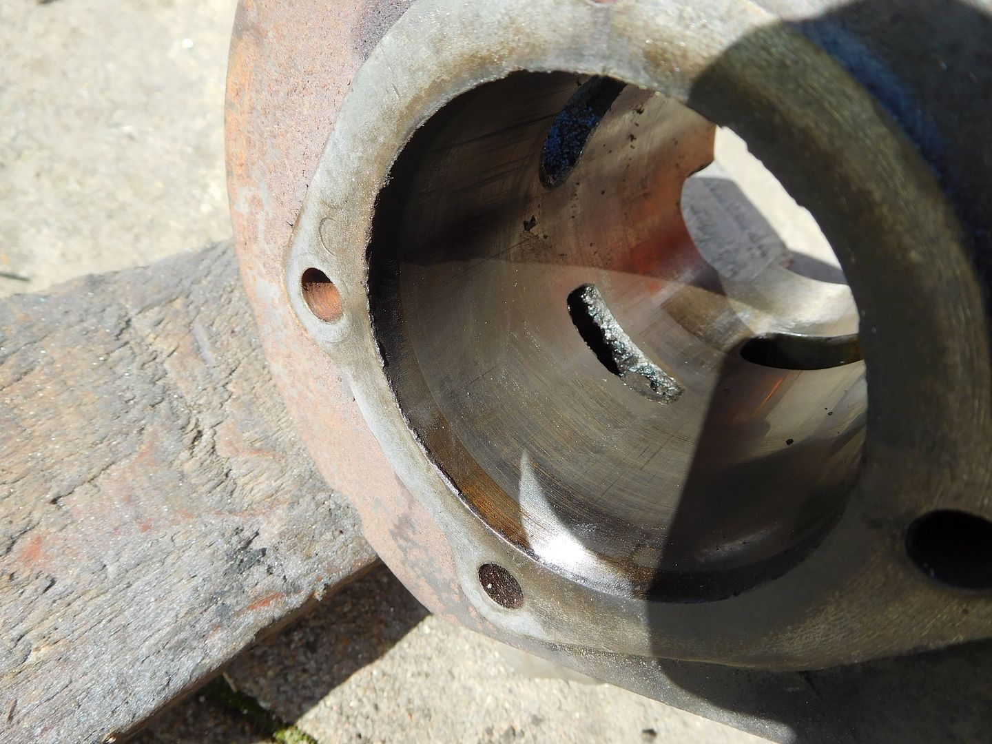

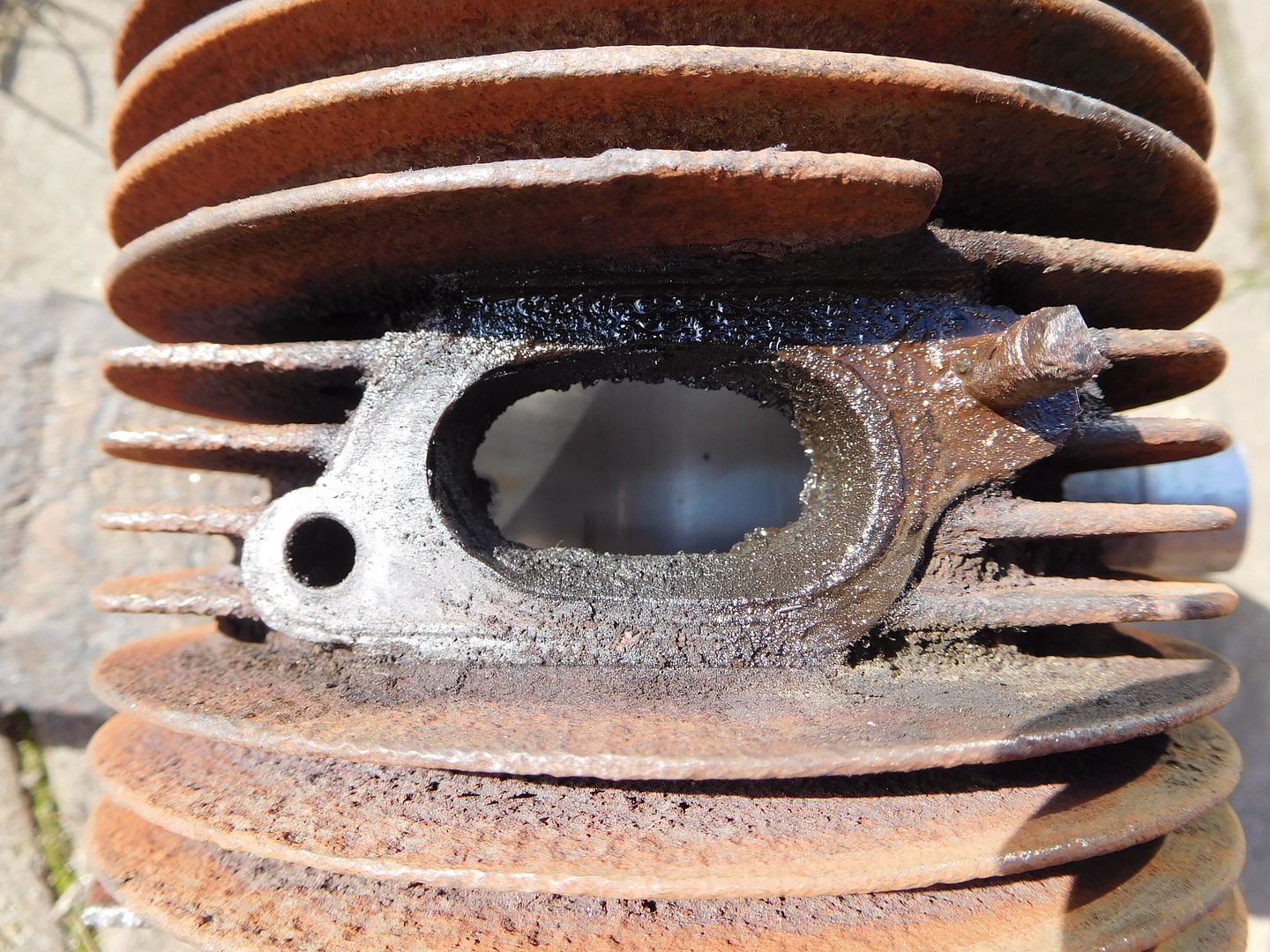

Postby rossclark » Wed May 03, 2017 8:26 pm

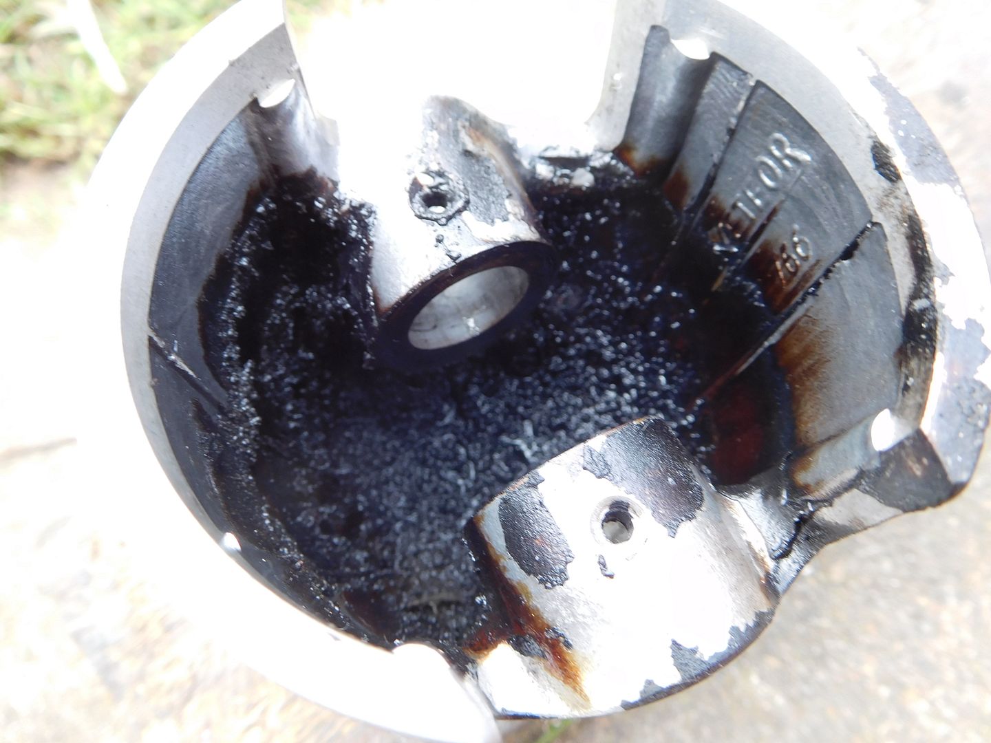

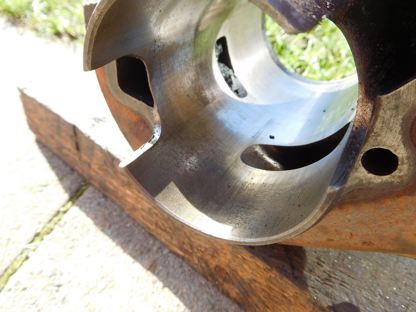

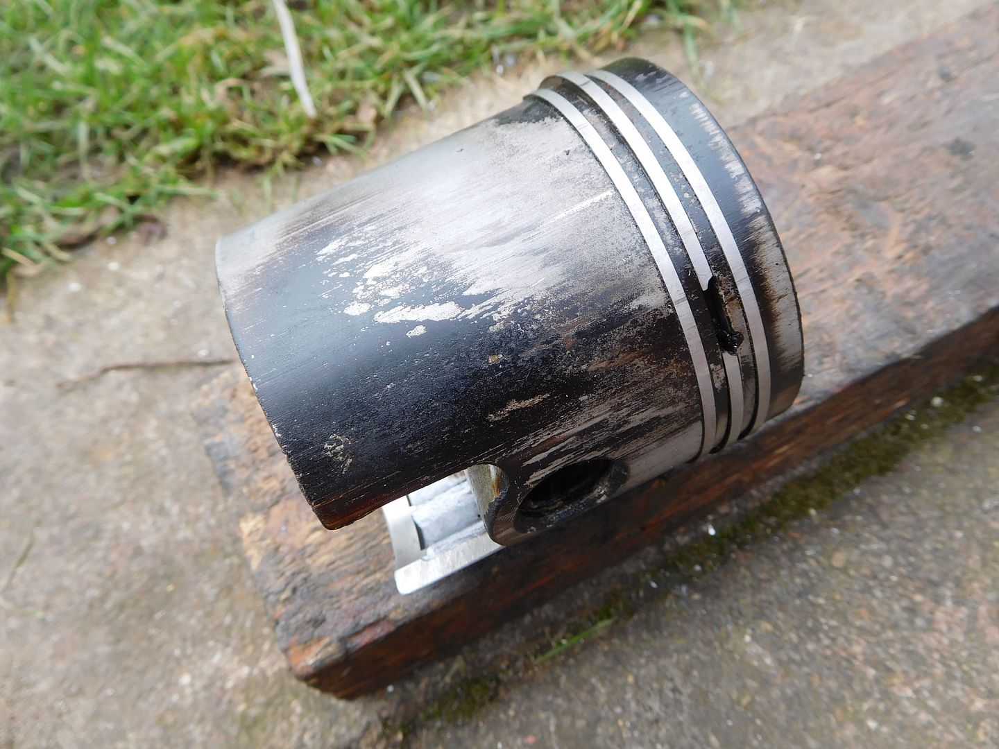

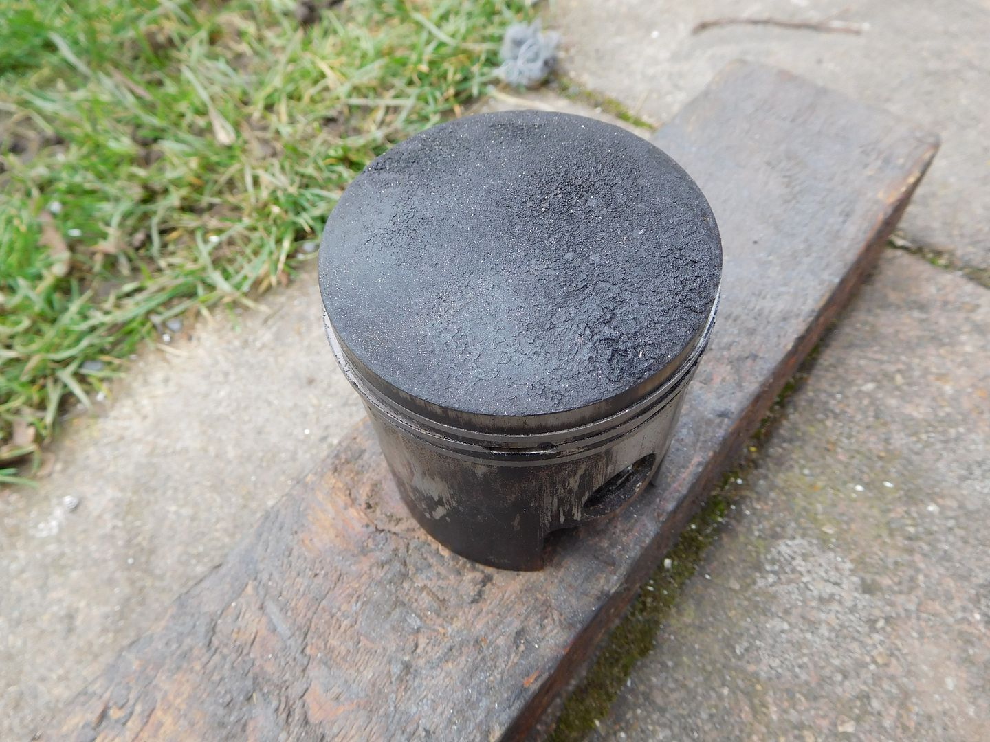

I've stripped down the engine in my recent Lince acquisition. The inside of the crank case, bottom of the piston, barrel spigot - everything in the top and bottom end is heavily carbonised, there are carbon deposits blocking the transfers, even, like lumps of coal... :shock:

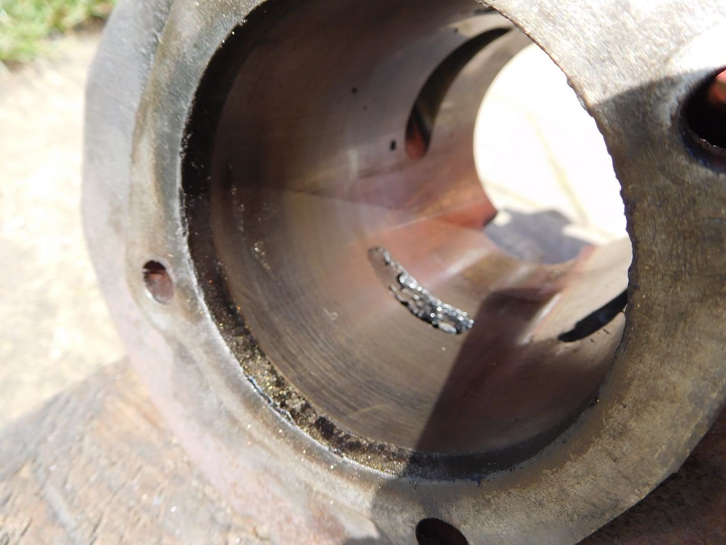

The barrel itself is very mucky and bit rusty outside too and for some reason quite a lot of silicon has been smeared around.

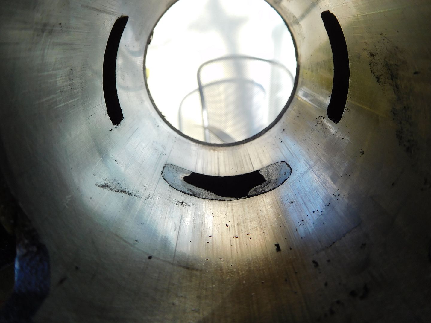

The bore itself is basically spotless though and measures up as standard. I've tried a new piston and rings in it and the tolerances are spot on.
What can cause this level of carbonisation?
What's the best way to clean up the cylinder? I don't really want to blast it as I'm not planning on a rebore.

Postby rossclark » Thu May 04, 2017 1:03 pm
That's almost exactly what mine looks like.
What thread was that?
I have to say the oil seals were bust and there was near 2 litres of oil and sludge in the chain case.
Can running with burst oil seals cause this?

Postby coaster » Thu May 04, 2017 3:55 pm
They all used to look like that after sever years without a de-coke before the advent of synthetic oils. Same with exhausts. I'd nip down to B&Q and buy a pack of Caustic Soda and a plastic bucket. Leave the barrel in the caustic solution for a few days and it should all hose off clean. Be VERY careful with it though as it gives off chlorine gas when first mixed and can also burn your skin and clothing badly

Postby Phil D » Thu May 04, 2017 7:04 pm
I found after soaking a while in paraffinImage
this worked well on the piston although mine wasn't quite as bad as yours but it took a few goes with some Scotchbrite .
Washed it off with clean water and dried it quickly with a heat gun.
I used a combination of toothpicks and Mr Muscle to clean out the ring lands.
I didn't use it on the barrel though.
I carefully scraped the thick off with a blunt Stanley blade then cleaned up the inlet & exhaust ports with a Dremmel.

coaster wrote:They all used to look like that after sever years without a de-coke before the advent of synthetic oils. Same with exhausts. I'd nip down to B&Q and buy a pack of Caustic Soda and a plastic bucket. Leave the barrel in the caustic solution for a few days and it should all hose off clean. Be VERY careful with it though as it gives off chlorine gas when first mixed and can also burn your skin and clothing badly
Good shout I need to get some caustic and spirit of salt anyway as the tank is very rusty inside too.
