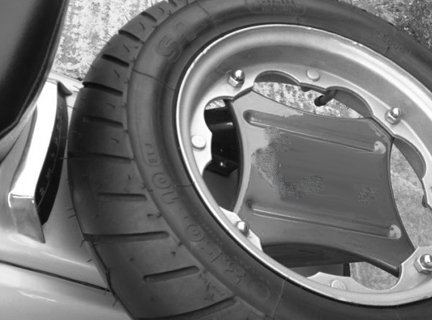

Postby foremanbob » Tue Jun 13, 2017 9:21 am
Looking for a rear wheel carrier to hold a spare SIP tubeless....
Style similar to this... obviously the studs wont fit... anyone any bright ideas other than grinding out the short studs and replacing them?

Postby Solid Air » Tue Jun 13, 2017 9:47 am
Hi Bob, I had this problem so removed the four studs from the carrier and fitted M8 rivnuts in their place then secured the wheel in position with four bolts.
Hope this helps
Mark

Postby Granty » Tue Jun 13, 2017 1:59 pm
Guys, I used 4 extended cylinder head nuts, screwed them onto the carrier and then used 4 Allen bolts to fix the rim to the carrier, worked well.

Postby burnside » Tue Jun 13, 2017 10:23 pm
I used stud extenders/connectors on each of the existing studs, then bolt the rim in with M8 bolts
