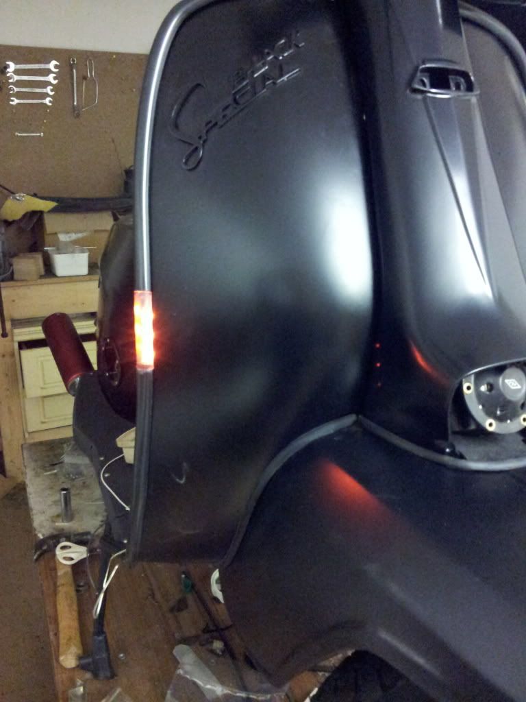

Postby Angry Bloke » Fri Aug 08, 2014 3:36 pm
^ Thanks Colin :D
Mine are fitted in the rear lens and on the front mudguard

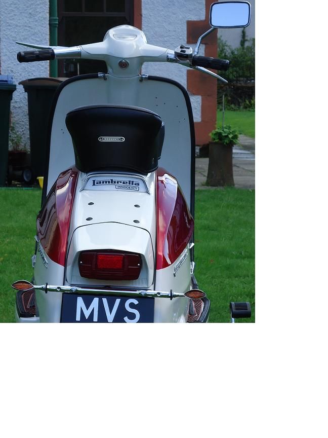

Postby carlos fandango » Fri Aug 08, 2014 10:20 pm
Heres mine , i made them myself :)
If you use LEDs make sure you get an "electronic" relay.

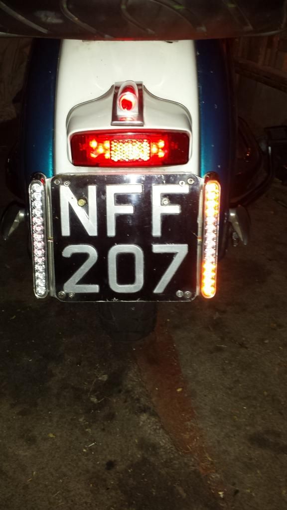

Just added these to the rear of my series 1 as I was concerned a leg down at lights would block the view of the ones at the front
They are LED and also have stop and tail lights, brighter than they look due to the flash

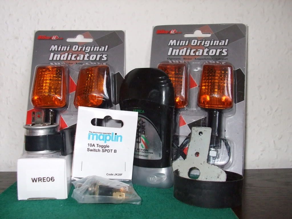

Hi Norfolk,

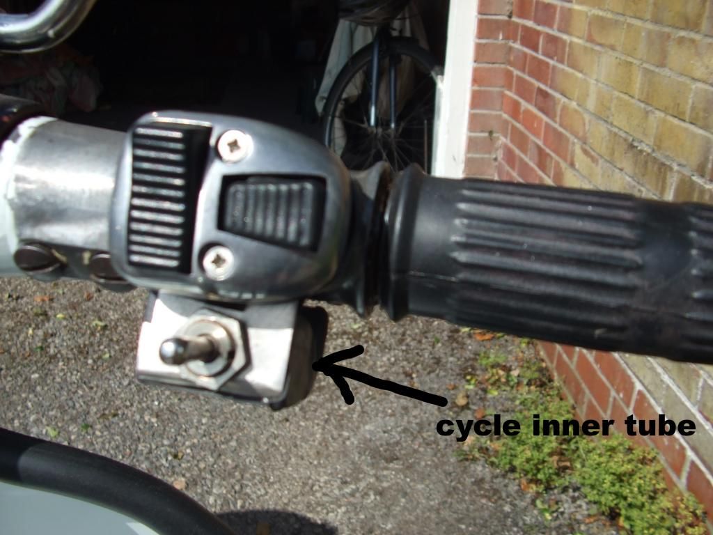

I used conventional 23 watt motorcycle indicators and mechanical relay( Bimetal strip). Note as I understand if you cant see indicators from riding position you will need a warning LED or buzzer.Carlos's neat solution would seem to bypass the the need for a warning light. A stainless steel bracket fits under light switch which means the switch is raised up out of its normal position a strip of black plastic from an aerosol cap covers the gap. I have led warning light in speedo Some one on old forum had modified Honda moped indicator switch which looked very professional.
I have used smaller switch and smaller stainless steel bracket on n0 2 scoot as shown with cycle inner tube to water proof it
Both scoots are wassel DC with battery .I assume you are going to charge battery from mains ( with long lead :D) two conventional indicator bulbs would draw 3.8 amps but only infrequently
The front indicators have longer stems than rear and cost about £6 a pair 3 pin relay about £6.A 12v motor cycle battery about £15 some used house alarm batteries to good effect.
Hope this helps

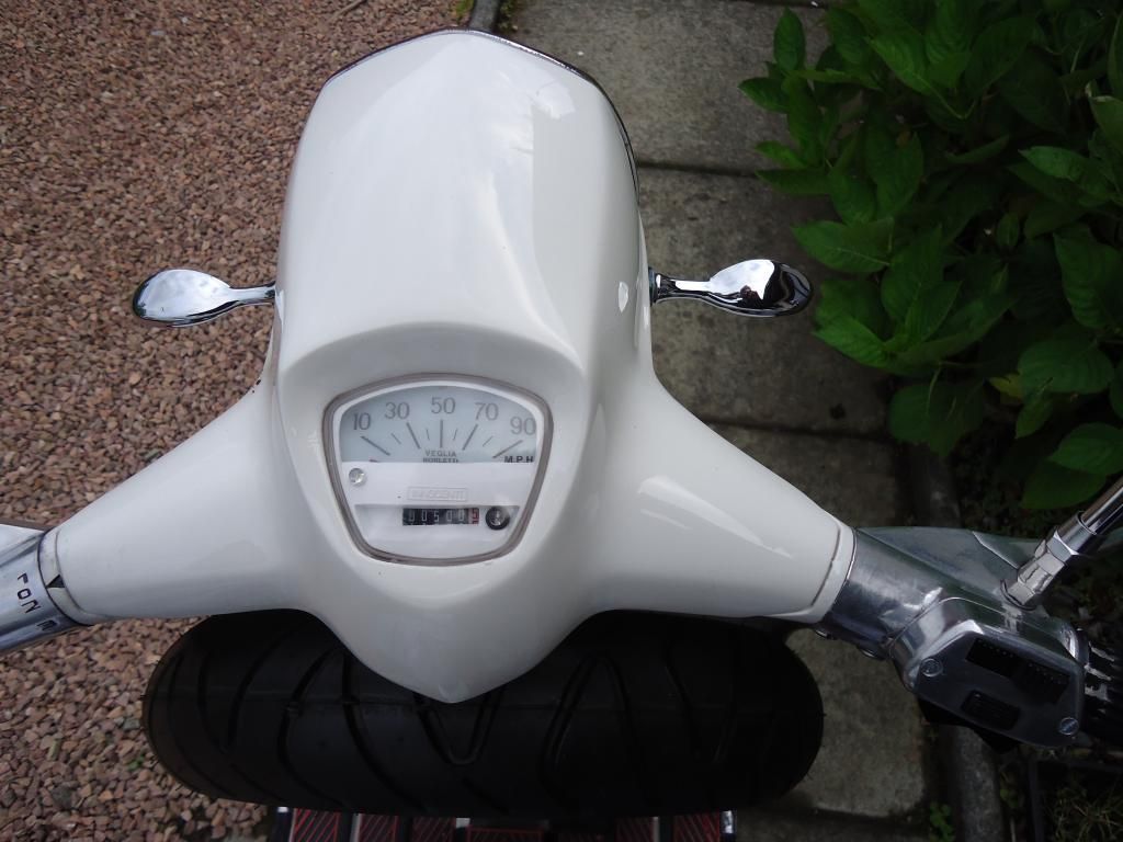

Postby Knowledge » Mon Aug 11, 2014 12:53 pm
Here are my indicators fitted: this missing bit from Oily Rag in Jetset 188.
Quite discrete

Postby MK Monty » Tue Aug 12, 2014 7:25 am
these are the black ones
http://www.ebay.co.uk/itm/Black-Motorcy ... 5afd8b1675
They do a plastic chrome ones as well. They needed the bracket cutting off and I had problems wiring them to flash both top and bottom ambers at the same time. I had to install a small diode to make sure that one flashing did not flash the stop LEDS. They are designed to fit above or under a number plate and they worked fine like that but I was going for the Bieme look.
