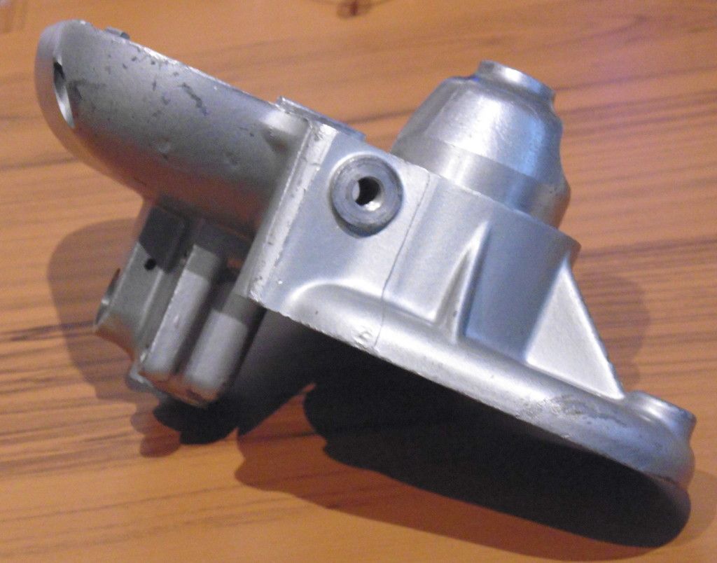

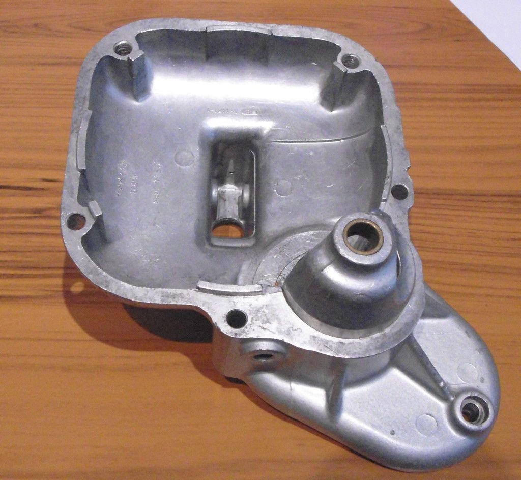

AVV clutch cover images:-
and
The hole for the level plug is the 8mm vertical threaded hole on the bottom of the cover, next to the bulge for the starter motor gears. I seem to remember that overfilling the gearbox on an AVV could lead to oil finding its way into the starter motor gearing, and the teeth on the outside of the clutch bell would probably churn up the oil if the level is too high. I reckon the level plug on the AVV will give around 1/2 pint of oil in the gearbox, about the same as the early LD models. Later (non AVV) models had a level plug on the clutch cover which was on the side of the clutch cover, giving greater oil capacity.
