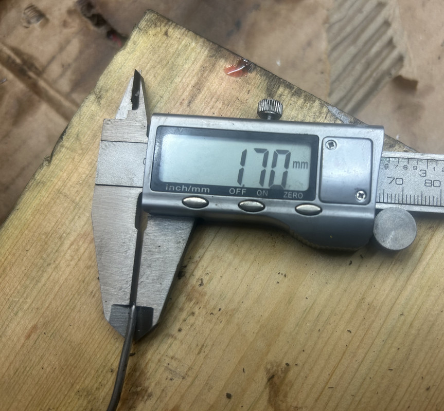

Rich T told me Saturday that the 'squish needs to be between 1.2mm and 1.8mm to aid kicking over'
I'll achieve this by ditching the 0.4mm base gasket, instead using a 1mm packer and Threebond 1215 for gasketing

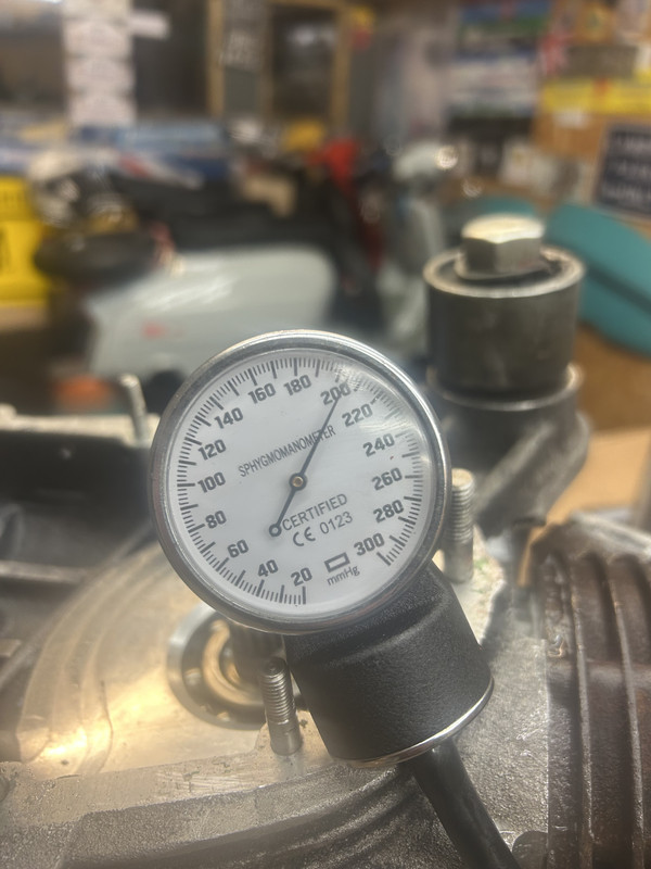

So new seals in , new piston, small end bearing , rebored cylinder, vortex fan all fitted , leakdown test holding fast, and squish at 1.70mm, towards the top end of what RT advised NSaints.
Next job new Casa Cush drive set up, chain , cowling sidecasing, oil , spray and fit exhaust then Dyno !
