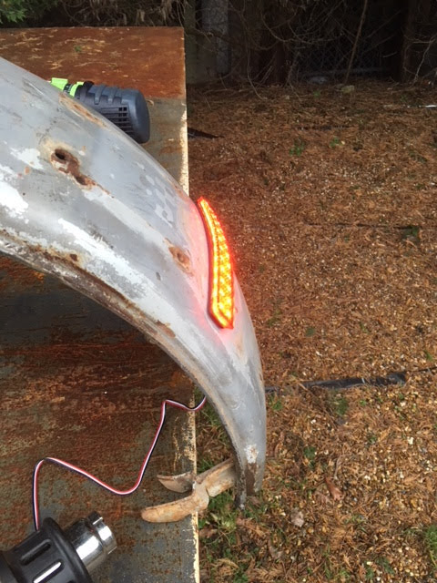

Been looking at the rear light and had a little experiment with a tail/stop led light:
Not sure if it is what I'll go for in the end but worth a try I thought.

After all the different tail lights I tried, have ended up with a S1 type, still the nicest shape in my opinion.
