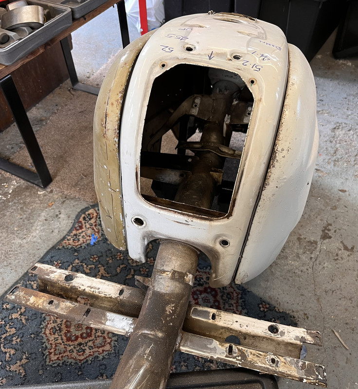

Postby Storkfoot » Fri Feb 16, 2024 12:01 pm
To me, it looks like the struts have, in the past (possibly following a side on impact) been re welded on in the wrong plane. The main strut definitely needs to come up on one side and down on the other. I think they all need to come off and be welded back on.
The bracket to attach the legshields to at the front has had some trauma too.
I’m going to get the frame jigged whilst I carry on trying to straighten the bodywork.

Postby Storkfoot » Thu Feb 22, 2024 7:37 pm
The frame goes on the jig next week. As you can just pick out, turning the frame over reveals that the main stand strut has been cut and re welded incorrectly.
The other pictures show that the panel bearing is going pretty well. Most of the dent in the loop at the back has been beaten out and the front mudguard is almost the right profile. A bit more work on both should see them good to go for the splits to be welded up.
Legshield is next. That’ll be fun :shock:
