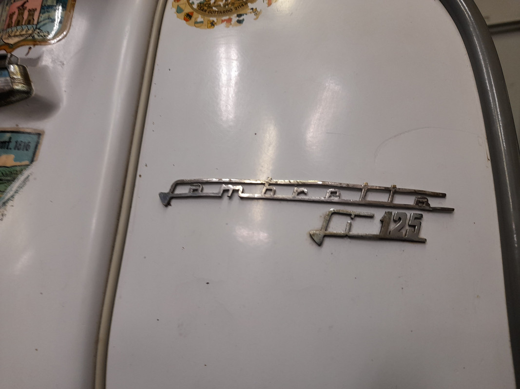

We all hang on to those stupid little parts that we'll never use, but every now and then we find a use for them....
This old badge has been in a box above the workbench for years. The original badge was still on, but the pins had broken off and it was held on by some twisted fuse wire.
Happy days.

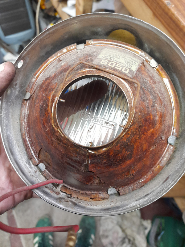

Headlamp reflector is goosed but I can't find an identical one. Does anyone know where I can find one?
There was an old reflector in my boxes of stuff that I have managed to make work but I'm not really happy with it. So it's either new identical CEV one or get it re-silvered but that's going to cost near to £100!
Are these type with notches normal? New to me, but I don't have much experience with series 2.

Postby Storkfoot » Mon Oct 25, 2021 2:40 pm
Double sided tape and silver foil it works and you can’t tell through the glass.

Postby dickie » Mon Oct 25, 2021 3:43 pm
Storkfoot wrote:Double sided tape and silver foil it works and you can’t tell through the glass.
I don't really like the idea but at a cost difference of about £99 I'll give it a whirl.
