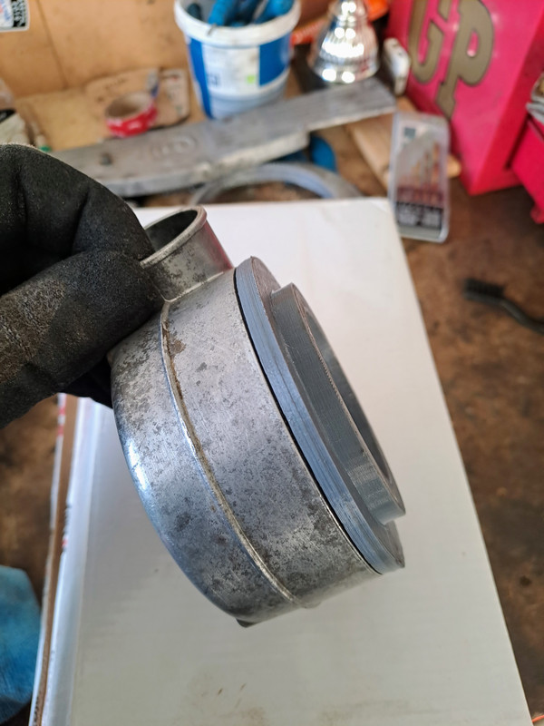

And I got Mike Bonnet to whip up a 3D print of a carb / air filter mount that I thought up, to utilise the original filter cover
Some air filter foam will cover the opening but the air box will be empty inside and probably be rotated 180° for panel clearance, and to receive some fresh air through the side panel grill
