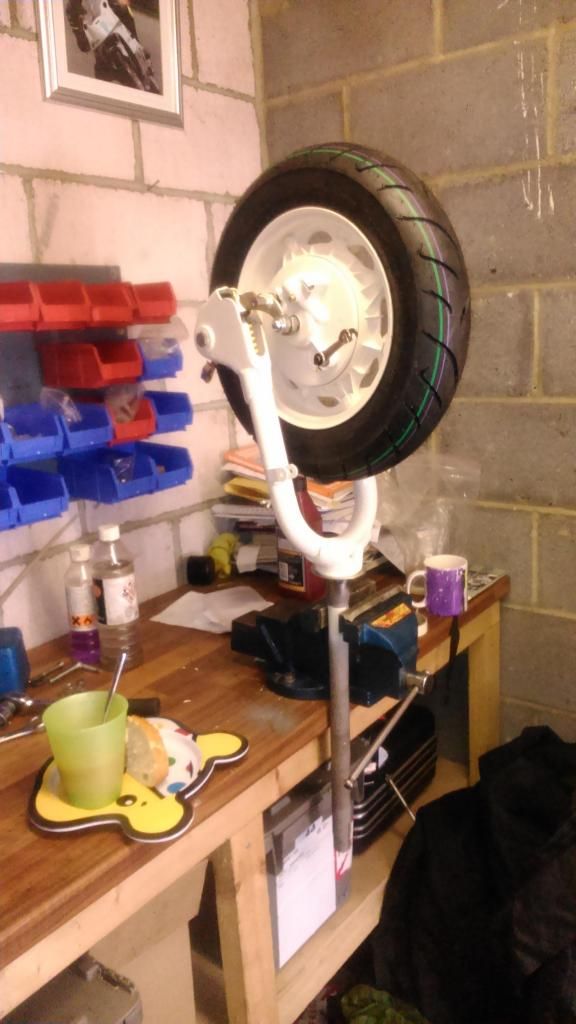

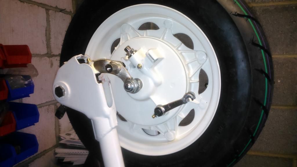

Postby dickie » Mon Jan 12, 2015 1:31 pm
I'm building my front wheel/hub and think I may have a problem with the front wheel spindle.
Mine is a plain shaft with threads on each end.
All the information I have seen shows that on one end there is a shoulder which locates in the 'fixed' side, i.e. the side that the brakes shoes are on.
Do I have a problem or are some of them without a shoulder?

Re: '64 LI125 series3
Postby dickie » Tue Jan 13, 2015 1:23 pm
Thhanks Bob, but the exploded view shows a shouldered spindle and when you click on it through SR it is without a shoulder.
Which do I believe?
Postby DaveTomo » Tue Jan 13, 2015 3:45 pm
DaveTomo
Posts: 180
Postby dickie » Wed Jan 14, 2015 10:06 pm
DaveTomo wrote:The one with the shoulder is for a disc brake http://www.scooterrestorations.com/lamb ... rake-axle/
Drum brake no shoulder http://www.scooterrestorations.com/lamb ... rum-brake/
Thanks, front wheel now built up and better than new as I've used stainless fasteners throughout and GP brake cam and shoes so I have a chance of stopping. :)

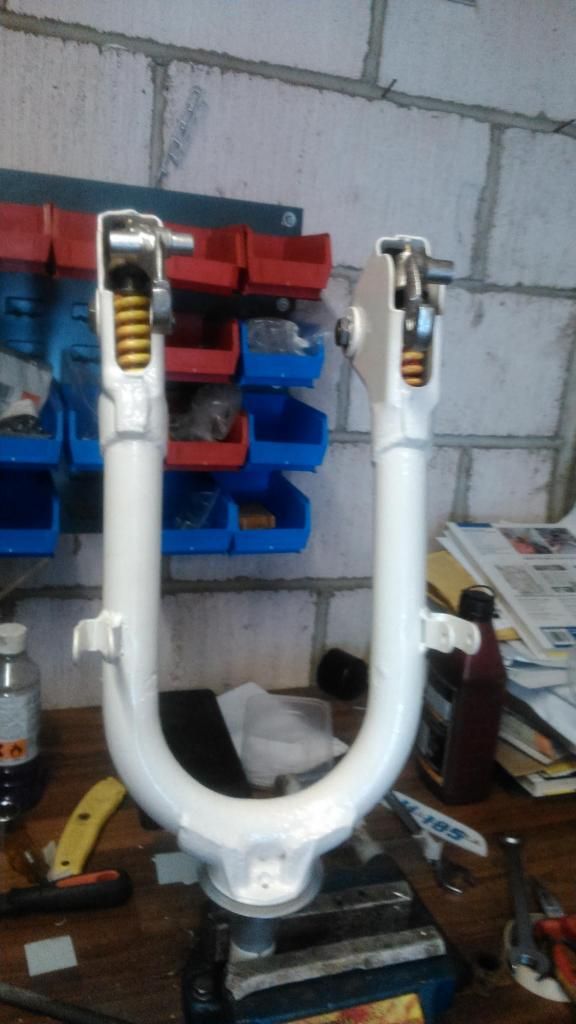

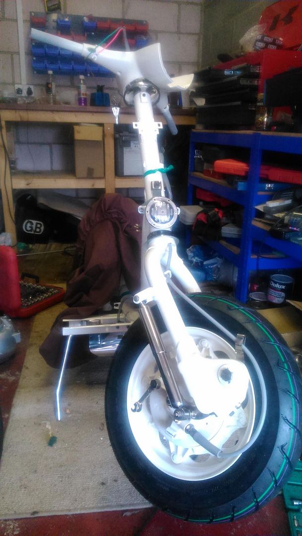

Postby dickie » Sat Jan 17, 2015 7:30 pm
Got my fork links back from the platers last night, so I built the forks up today.
First problem was that the Indian spring compressor tool I bought needed to be notched so that I could compress the spring fully.
Built the forks up with all new components or any original parts were nickel plated.
Fitted the wheel to make sure both links were straight - everything fine so far. Happy days.
Lunch was brought to me in the garage on the best crockery.
Fitted the forks to the frame............
Spot the deliberate mistake.
3 steps forward and 5 back I reckon

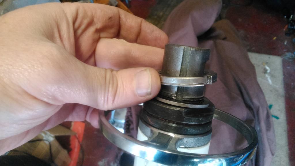

Postby dickie » Sat Feb 07, 2015 3:19 pm
Got my new forks, correct LI ones this time as the last ones I tried to fit were spanish ones. I had no idea they were 7mm shorter until then.
Anyway, they're in and I'm one small step closer to riding my Lambretta :D
Spot the subtle difference from the last photo of this............
Postby Dimitrios_231 » Sat Feb 07, 2015 4:39 pm
Steering locking ring upside-down :)

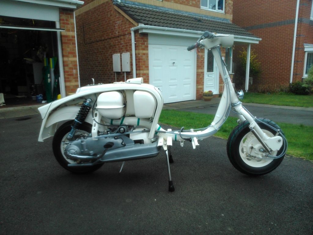

Postby dickie » Sun Mar 29, 2015 10:01 am
Making progress. Just fitted engine.
Stand was terrible. I had to cut 40mm off the bottom of each leg and slot the holes in the hooks and.splash plate. The slotting was necessary to clear the ancillotti silencer on the starboard side. The 40mm was due to the front wheel being 100mm off the ground. I also bent the stops slightly to allow the stand to go a little further forward. It's all hunky dory now.
