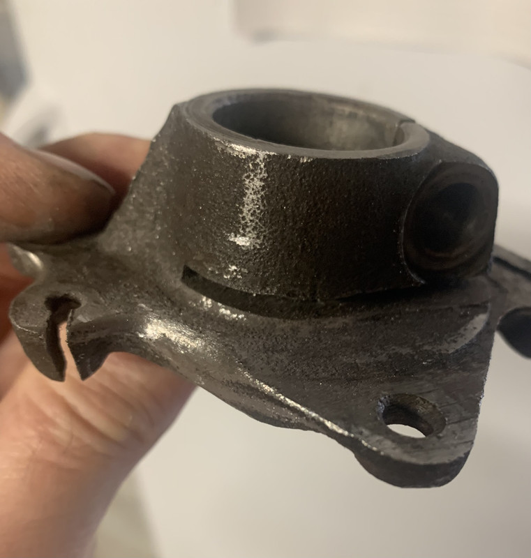

Horn bracket original to the frame complete with nut washer and bracket, cleaned up but not repainted. I want this scooter to reflect the fact that is an old bike which has been well looked after, rather than something new from 2023, hence leaving it this condition.
I've fitted it this way with the threaded sections facing forward. Somehow this seems the wrong way round to me but every image shows this as the correct way. If you have a view on the correct orientation please comment.

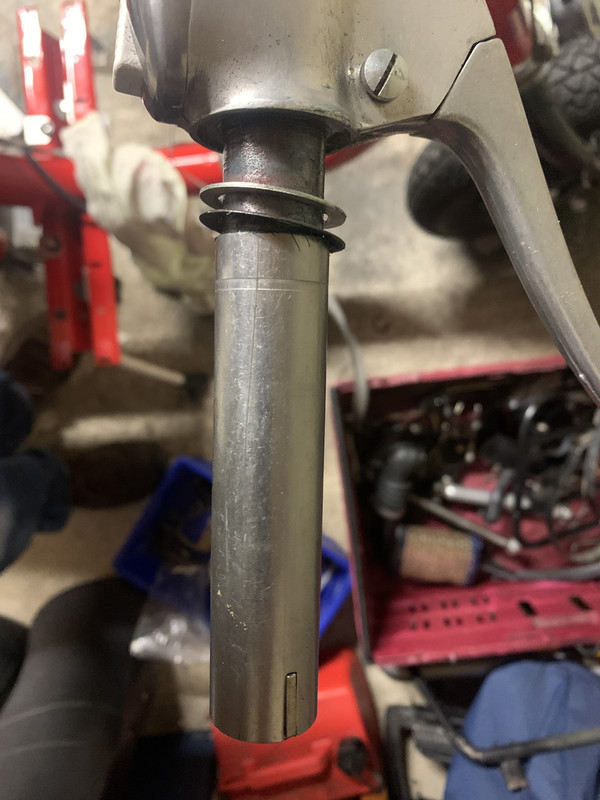

Turns out they need a bit of fettling, the 'shoulders' don't fit into the throttle tube so I will file this bit until it does. Feeling mildly disappointed whilst filing...
Don't forget the shim and wavy washer - lots of grease about to be added.

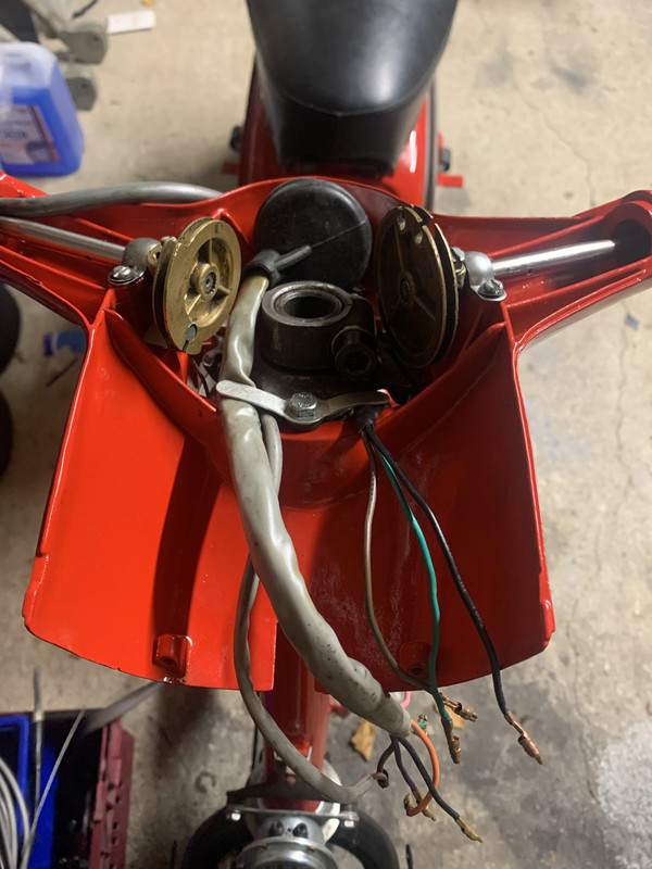

New bush, clamp on. shims on, wheel on. Now this is a Spanish headset with an Italian throttle wheel and the throttle stop doesn't line up, so under the bolt goes a short piece of metal to make it work. My obsession with neat screwheads continues...
I like to check that the cable is as straight as possible. I've seen some installations where the cable is rubbing against the headset clamp because of the relative position of the wheel. The alignment of the wheel can be altered by adding/removing shims at the throttle tube or the throttle wheel. In this case it lines up as it should, so at last a good result for Mr B.
New wiring clamp added. Everybody says that bolt is a bugger to get done up. I find using lots of grease to hold the washer onto the top of the socket is the easiest way. I've decided not to earth the headset here, we will come back to that in due course.

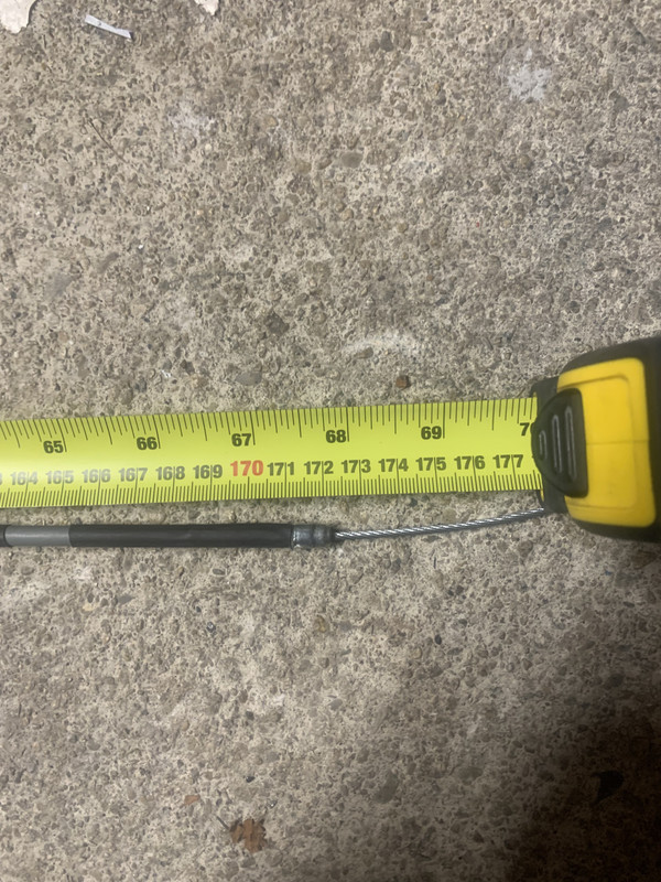

Next up will be the gear change and clutch cables. I'm going to start by measuring the cables and comparing them to manufacturer specification. It won't matter if they are too long, but quite often I find them to be too short, and this can make them impossible to fit correctly. That's the first job tomorrow.
alex_hughes
Posts: 118
Joined: Mon Apr 24, 2017 8:42 am
Re: S3 TV175 build up

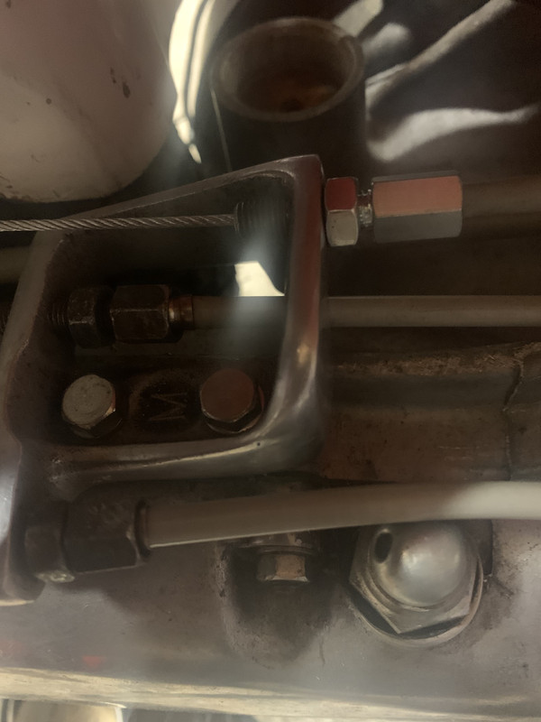

Postby alex_hughes » Wed Dec 06, 2023 8:13 pm
Gear cables. I've checked them for length and they are long enough. I've checked that the inner runs through the outer easily - they don't always and if they are sticky I'll change the inner and if they are still sticky I'll bin the outer. Not all 'friction free' outers are equal. Also I have made sure that the ends of the cables will fit right into the headset clamp plate - they don't always. I want to minimise tight bends and I tend not to fix them to the frame, leaving them to find their own way down, because this seems to give the smoothest route from top to bottom.
I've seen cables exiting the headset clamp like this...
and it does look tidy as they run down the fork tube, but really they want to be like this...
as this gives the inner a straight shot at the pulley wheel, so they cross as they leave the headset...
I've put some electrical tape around them where the fork tube joins the main frame, it will be enough for now.
This is the cable adjuster block I'm using. It's a bit of an experiment. The adjusters are in different locations to standard, the idea being to give a straighter run to the cable and therefore less friction in the cable. It has an M on it, it may stand for Mark, but I can't be sure as it was on an engine I bought some time ago. I'm going to give it a try, if it doesn't seem to work I'll change it, but I'm sure the cable runs will be different.
These trunnions are from SuperEibar. I like that they are easy to grip when doing the adjustment. When they came I was puzzled to find what appeared to be small ball bearings in the bag. I contacted Jaime (manufacturer) and he said that they were to make the clamping discs - you have to flatten them with a hammer. Not sure I would have ever worked that out - can I really be the only person who had to ask? Also in the picture is the plastic tube which goes in the middle of the run, but I've decided to omit it.
so fitted and cabled up it looks like this. I cut the cables short and use mountain bike ends to keep it tidy
Here's the pictures of the cable run. Standard down to the loop. Not using the plastic tube but I've added a bit of protection to the individual cables with shrinkfit tubing. I'm going to monitor this to see how it wears.
Through the wire clip. I'll be interested to see how easy it is to get the sparkplug in and out when the toolbox is on - but this is giving the straightest run
and either side of the engine mount
A bit of adjustment and its changing gear nicely. Clutch cable tomorrow, I want to spend some time getting it as right as it can be - there are a lot of variables and my intention is to optimise every one of them to give a light feel to the lever.

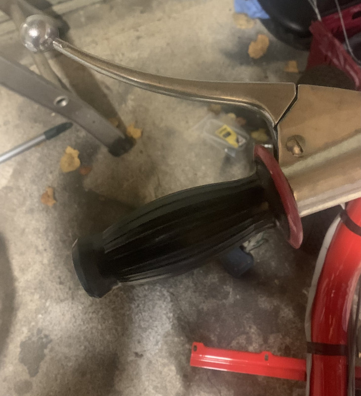

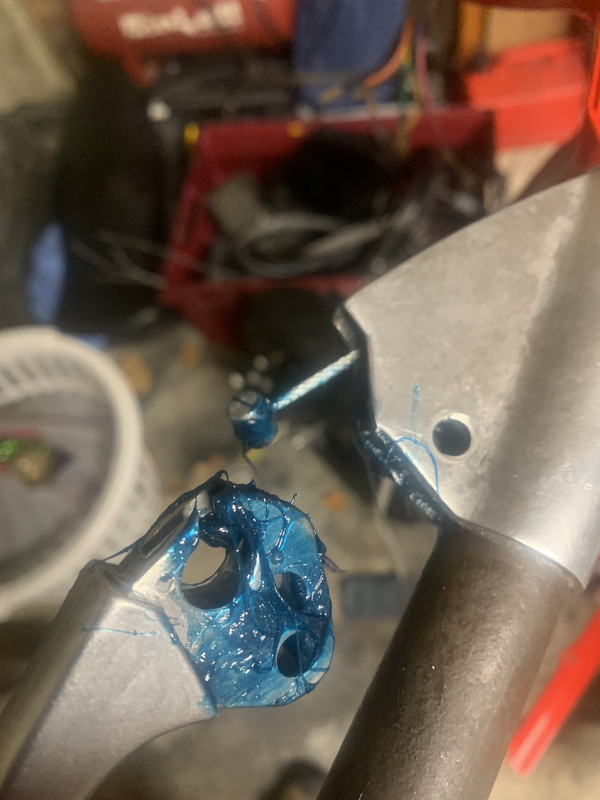

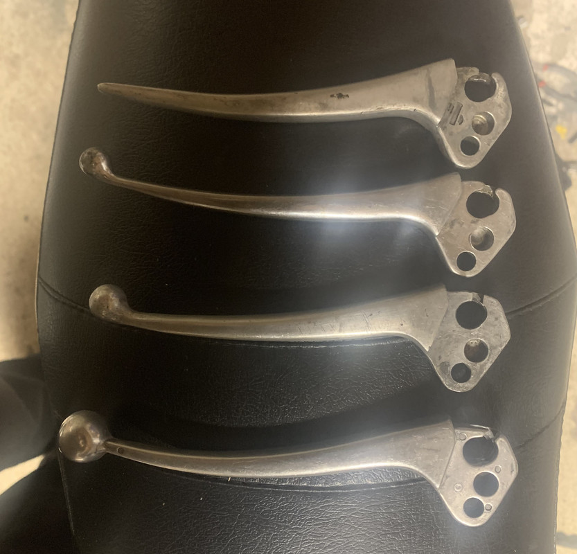

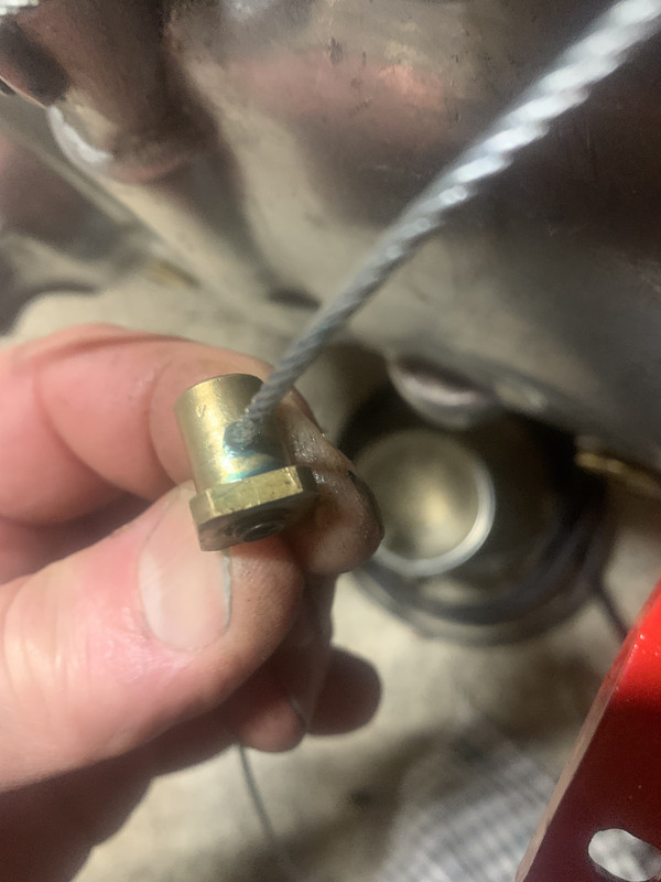

Clutch cable.
I'm going to put this into context by explaining that I have difficulty with my left hand grip following a teenage scooter accident which over the years has developed into arthritis, so I do everything I can to keep the clutch as light as possible. I'm working on making everything as optimal as it can be, believing that even tiny improvements can accumulate to make a noticeable difference.
I start with a good quality cable with a free flowing inner, and check it is the right size. Depending where you look you will see that a S3 clutch cable is either 1720mm long or 1700mm long. As long as it's not less than 1700mm it should fit. There was a batch sold by a dealer on the south coast which were 1680mm long and they just didn't fit well enough for the ends of the cables to locate into the sockets. So worth checking.
This one is fine...
Earlier in the build I selected a lever with minimal wear and a good fit into the support. Below, the Italian ball ends are spherical and Spanish are tear drop shape, the aftermarket Cuppini are the ones I'm going for. They pull the cable a fraction less than a standard lever which makes them a little lighter in action. I would say that they are angled slightly further away from the headset so you need longer fingers to reach...
Lots of grease on all of the moving elements of the lever. I make sure the cable barrel is greased too since it rotates slightly against the lever as it's pulled.
This is the grip I'm using. I find them really comfortable but if you use them and have clutch drag - it may be because the fatness of this grip stops the lever from moving as far as it should. Worth then changing to standard to see if it cures the problem. We will see how it goes with these.
Modern cables are slightly thicker than the originals and in the Sticky book there is a tip about dremeling away part of the headset to create a bit of room for the cable. MBs slightly waisted control rods mean this doesn't need to be done, there is plenty of room on the left hand side. The cable has to follow as smooth a path as possible, and if you think about it the tightest curve it follows is where it drops down out of the headset. It is amazing how much resistance this bend adds to the pull. So I like to give the cable a slightly easier time as it negotiates this bend, so before I installed the headset clamp I rounded off this section.
Loose cable runs down to the adjuster, and as previously mentioned it's a block which hangs the clutch adjuster over to one side for a straight run at the lever. You can see that I'm using a non- standard adjuster. The idea of these is to make sure the cable goes through the very centre of the adjuster, not rubbing on the sides. The straighter cable again should keep everything light. These came from Rimini but you can get them in the UK now
Finally the end trunnion. Worth making sure it is a good fit in the lever, able to rotate slightly, and grease this too.
So its all connected up. Standard clutch with Torbay springs. Scootering Dan reckoned standard Lambretta spring are good for 13hp, this motor should be slightly better than that, but not in need of full on race type springs. Torbay's are somewhere in the middle. So I tried it at the lever and it felt odd. Looking back I realised I hadn't fitted the return spring on the engine. Doh. A few minutes later I found one in a box of bits and now it feels great.
One last thing I would say about keeping my clutch light. I have a couple of engines fitted with the Chiselspeed Easy Clutch and I do really like them. Expensive, but in my case worth every penny.
