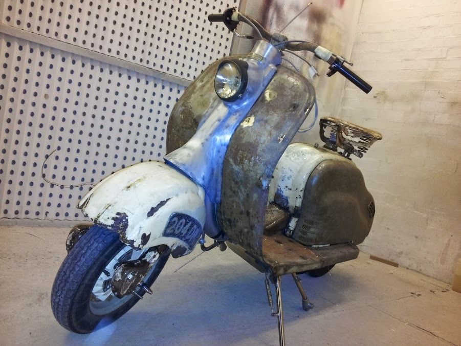

Well i stalled a bit over Christmas, but had a few hours on it this week :)
First problem was the seat , i havent seen a decent looking alternative seat on a LD. I toyed with altering an old Snetterton i had , but the most comortable position for me, is directly over the filler cap , and with a Snetterton what would of been a little uncomfortable :shock:
I love the look of the LD front seat with the two springs at the rear, the position is too far forward for me, but the position is again over the filler cap and would be impossible to access the cap :? so i came up with an idea to make the seat tilt. I tried it first with a wooden template, then went on to a carboard template to transfer to some sheet steel and fabricated a bracket .
It only needs to tilt by about 25 degrees to gain access to the tank, ive still to make a catch for it and a way to adjust it back and forth a little whilst riding :)
Another job was the fork stem, this is too short by around 12mm to reach the top of the leggies. So i found a bit of scaffold tube, turned down the id a little to get the chrome ring and race to fit , and tacked in place.
So this in turn, meant the forks were 12mm too short, but also the LD fork are threaded all the way up to the top unlike the s3 forks i had. If i used the S3 forks the LD handle bar clamp is a very sloppy fit as the diameter is reduced. So out with the grinder again and its cut and shut time. Luckily i had a piece of tube the same size and the id of the fork tube , and just needed a smidge off on the lathe for a snug fit :)

A bit more work.
I made a start on the seat catch. Take one 10mm coach bolt and one clutch spring :)
And a steel bracket some nut and a split pin :)
Ok its a little "agricultural" and needs a bit of refining :) but it works and with a seat cover on ............
And a bit of work on the panels. Fill the holes up, ready for panel clips.
And a bit of mesh for the vent holes

Postby carlos fandango » Sun Feb 15, 2015 12:19 am
Not had too much time on it recently :cry: but did a little bit.
Converted the panels to to clip on type, with some parts donated by Mr T :) thx
A little bit of reshaping
and a channel welded to the panel
Hoping to have a few more hours on it on Monday :D

Postby carlos fandango » Wed Mar 11, 2015 10:16 pm
Ive done a bit more on it over the last couple of weeks
Petrol tank needed extending. So out with the grinder, and a quick mock up to see how big i can go.
I settled on 65mm , cut a band and formed it by hand and eye, tacked it together and then got a welder to do a proper job on it.
After an initial pressure test found two pin holes, got those fixed and now holds 5psi :)
Fits a treat, extended the fuel tap rod by the same amount as well.

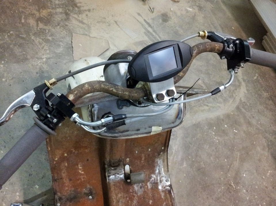

Postby carlos fandango » Mon Mar 23, 2015 12:56 am
Thanks Trev t ....usable, thats the idea :)
Ive got the cableing and speedo sorted :D
