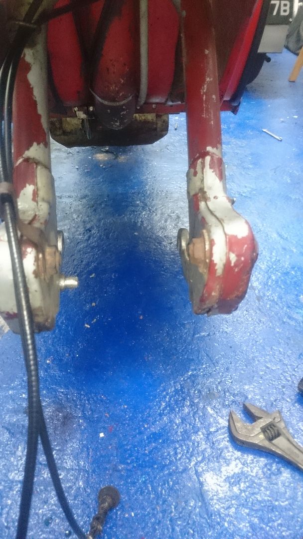

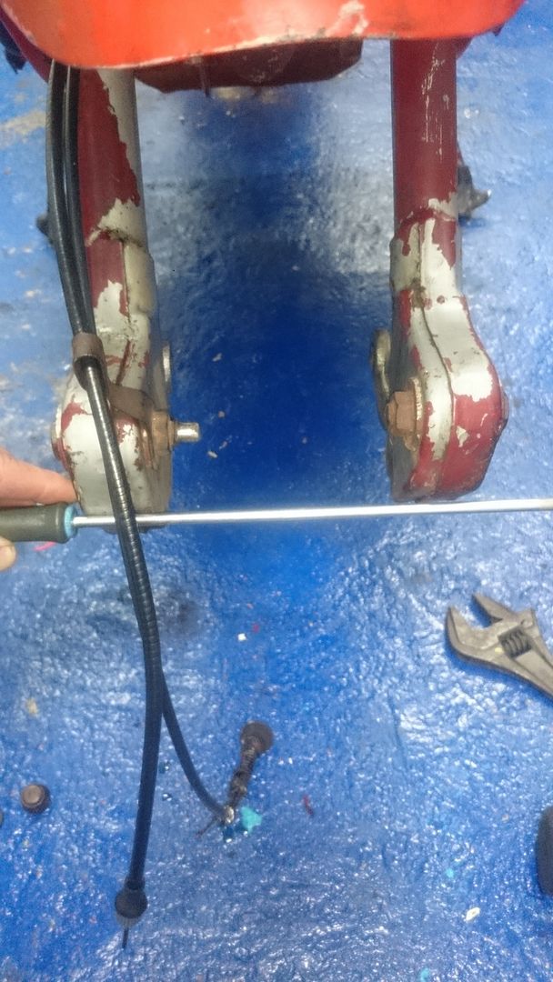

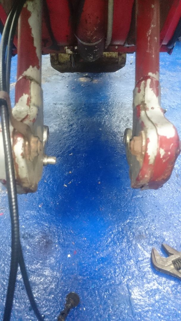

Thought I would remove the front wheel this morning and start chipping away at the horrible red paint. Whilst doing this noticed my fork seem either twisted or bent.
Not sure if you can see from the pics but they defiantly aren't right.

Postby Warkton Tornado No.1 » Tue Mar 15, 2016 6:01 pm
If it were me, I’d feel compelled to strip those out & thoroughly check.
Ideally, swap them out for another ‘known’ pair if you wish to remain mobile.
The very least I‘d advise you to do is remove the links etcetera & put a tight fitting bar through the link pivot hole of one leg to check alignment. But, TBH, they look wrong to the naked eye!

Postby Storkfoot » Tue Mar 15, 2016 7:59 pm
There are Lambretta fork jigs out there and people who have experience in straightening them. I'd, personally, pursue that option. The forks being bent does, of course, pose the question as to whether the frame is bent too?

Postby Covboy » Tue Mar 15, 2016 9:04 pm
Hi kris
As the forks are a different colour to that of the scoot itself, it would lead me to think that that have come from a different scooter . Stork-foot is correct - But I think that the frame is probably ok - just a dodgy set of forks !!!

Postby Kristof Lammy pie » Tue Mar 15, 2016 9:13 pm
I've had a good look at the frame and it appears fine to the naked eye.
But once the forks are off i will have a proper look at the headset area for any stress cracks etc.
I've just ordered some brand new Scomadi gp forks.

Postby ToBoldlyGo » Tue Mar 15, 2016 9:44 pm
Covboy wrote:Hi kris
They would have been a different colour. Silver or grey, depending on who you ask. I wouldn't take it for granted that the frame is true. It takes force to bend a pair of forks so you can't guarantee it. I think there are probably non intrusive methods of testing it.

Postby Kristof Lammy pie » Tue Mar 15, 2016 10:15 pm
Not sure what to do now, half tempted to strip the whole bloody lot, get the frame jigged, deal with the rust and rebuild it.
Nightmare as I wanted to ride it for the summer.

Postby Kristof Lammy pie » Tue Mar 15, 2016 10:55 pm
Having looked at the forks again, and considering what's happened to the motor, I don't feel comfortable not stripping it completely and going through the lot.
So I will start stripping the lot tomorrow and get the frame checked out and I can then sort the rust out on the legshields and side panels.
It needs to be done properly.
