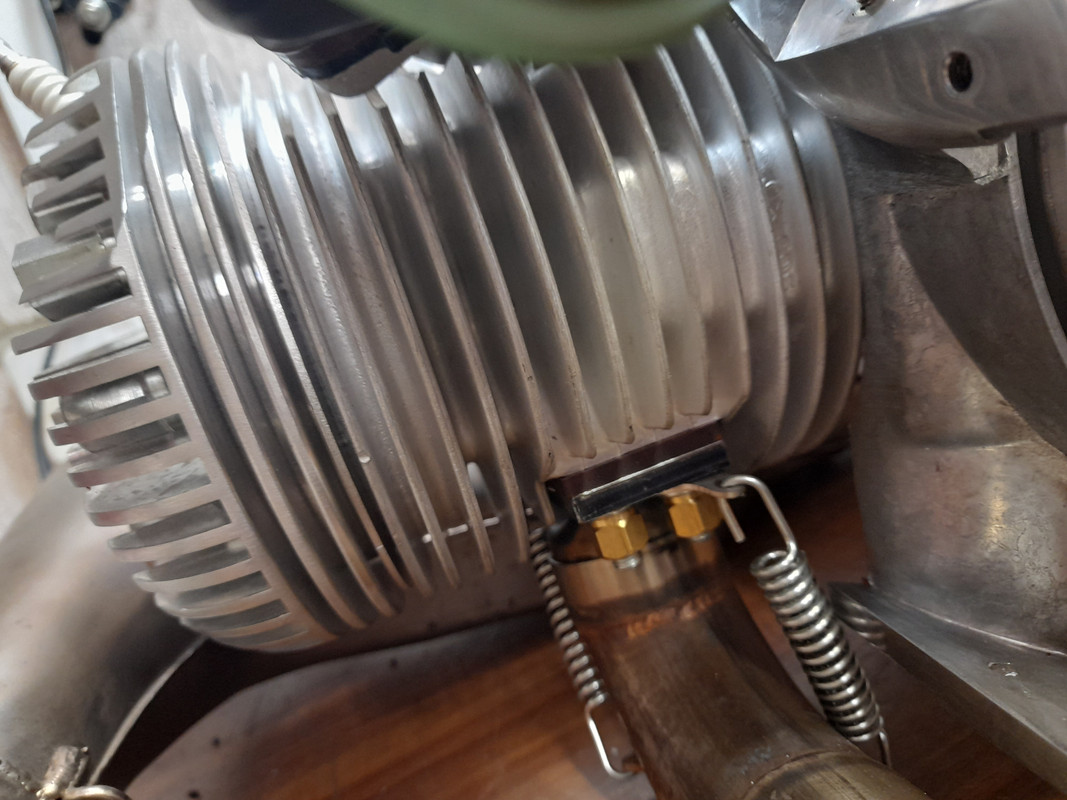

Postby dickie » Thu Jan 28, 2021 8:16 pm
So, the engine is finished and ready to put in the frame. Nothing particularly interesting, but we all like pictures of newly built motors.
Never used a 4 stud manifold before. I like it.

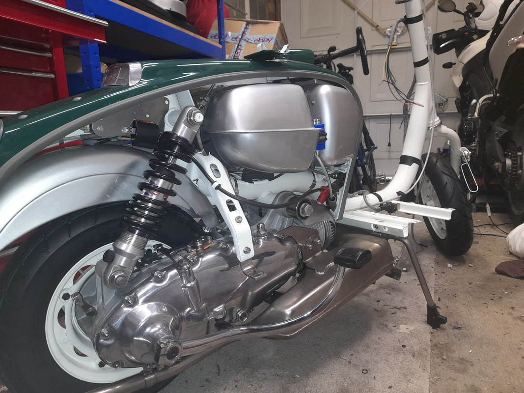

Postby dickie » Sat Feb 20, 2021 4:57 pm
Nothing special about the following image, I just think it looks nice. Rich Oswald and a couple of others saw a previous image and pointed out that my tank wasn't straight so I measured it; it was 3.4 degrees out, now 0.1. Sorry, best I could manage.
I've learned a few things about cable types and routing. So I don't follow the conventional routes. I've also found the clutch cable from chiselspeed to be excellent and no cable ties either. My 175 clutch is 2 finger with uprated springs using this method.
