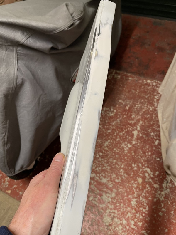

One of the other job's over winter was to repair the kick start side rear runner, which was badly split.
In fact it was worse than I thought - 3 cracks in total (I thought 2)
you can barely make out a couple of the cracks from this image, with another under the plastic floor board trim running front to back
I didn't want a local garage type repair, but rather trust a specialist whose used to working with Lambretta's, and a repair that won't need doing again.

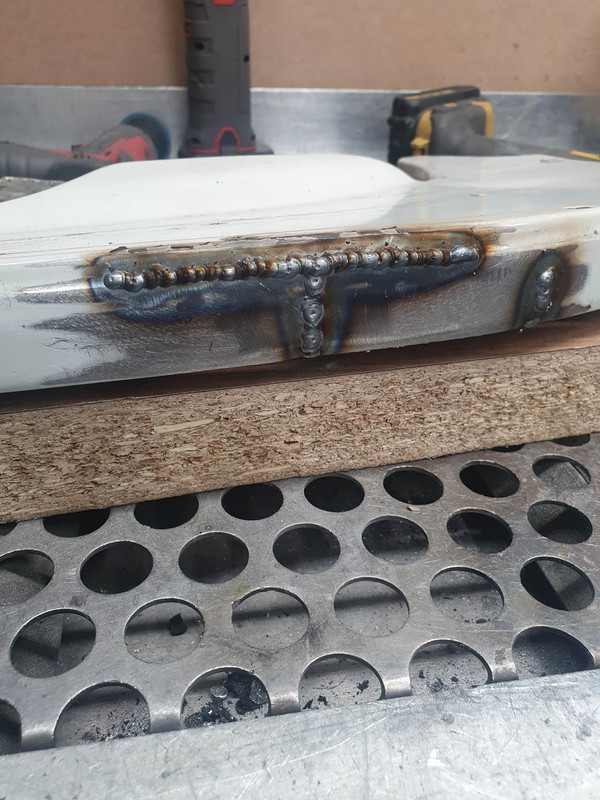

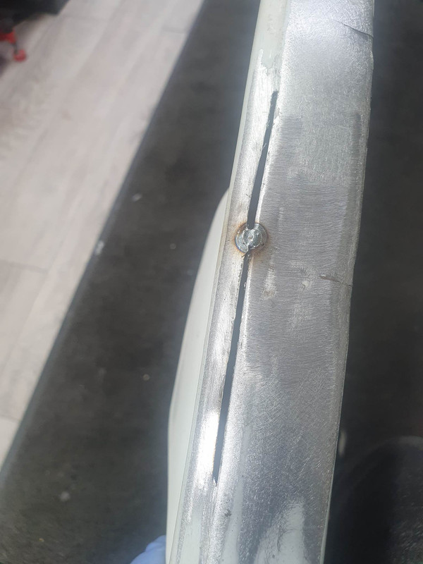

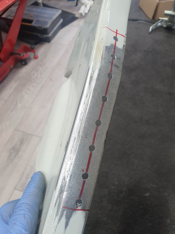

Step forward Dean Stradling. If you are not familiar with Dean's amazing repair work, check out his engine, frame, and body repairs on Facebook
Here's a summary of Dean's repair (apologies if the order isn't exact)
Over to me to touch up the paint

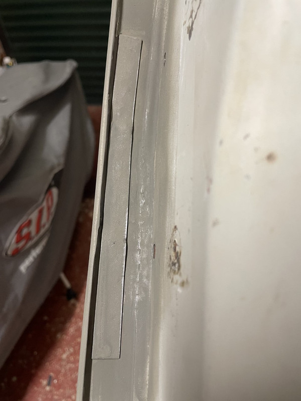

Postby nsaints » Thu Apr 20, 2023 2:20 pm

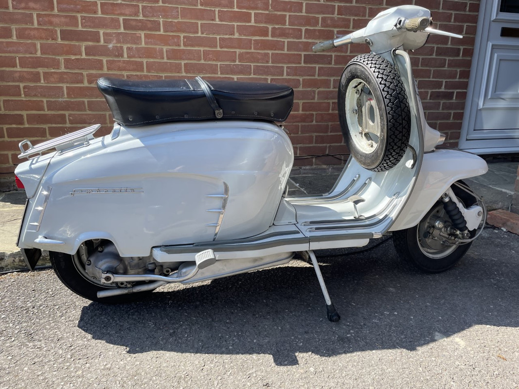

Had the paint matched, painted the repaired outside edge of rear runner and refitted.
As the old runner was a couple of inches of sheet steel from becoming 2 halves of a rear runner, I'm pleased with the outcome.

Postby shamrockexpress » Fri Apr 21, 2023 11:04 am
Is that a hairline crack appearing :o
shamrockexpress
Posts: 140
Re: SX Refresh
Postby shamrockexpress » Fri Apr 21, 2023 11:05 am
LOL :lol: :lol: :lol:
shamrockexpress
Posts: 140
Re: SX Refresh
Postby nsaints » Fri Apr 21, 2023 12:03 pm
Not unless cracks are appearing due to be pushed in and out the garage
:lol: :)
