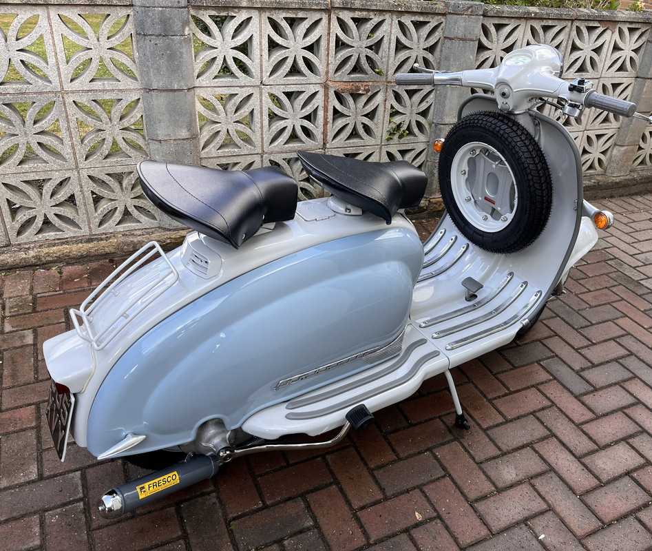

Postby Storkfoot » Sun Apr 07, 2024 11:06 am

dickie wrote:Beautiful. Is that on the Devon 150?
No. Parkgate, South Wirral. Messing around with carburettor jetting again :)
