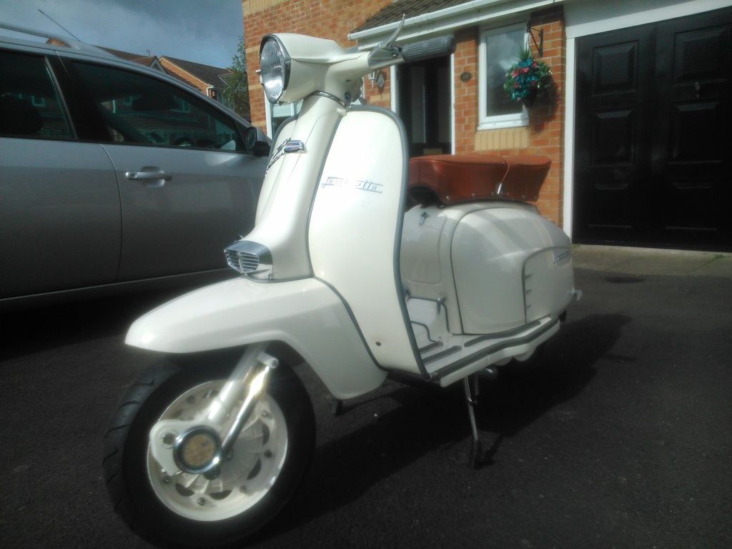

Well it's sort of finished. I've just been for the MOT and it passed.
Have to say that despite renewing every part of the brakes and "uprating" to GP stuff I nearly cacked myself every time I approached a junction! I'm a little too used to modern bikes I guess.
Anyway, I'll send my forms off to the DVLA today and they'll hopefully be back by the time I return from working away next weekend.
It's rather spluttery too as I suspect it's too rich, but that's obviously safer and I won't be doing anything until I've put at least 200 more miles on it.
Clutch is very heavy too. I thought they were just like that but the MOT chap in Motech reckons they're not normally that stiff, so I think I'll try some thinner BGM plates.

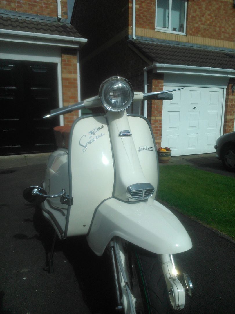

The halcyon mirror looks nice in my opinion, but is absolutely pointless :lol:
Doesn't it look lovely?
Re: '64 LI125 series3
Postby shane BBoys » Sat May 02, 2015 4:30 pm
Looks great.
If you keep turning the mirror you should get if set right . There I'd also movement on the glass itself push if down a tad. Best to do this on your drive with your car behind as if it's overtaking mine works a treat.

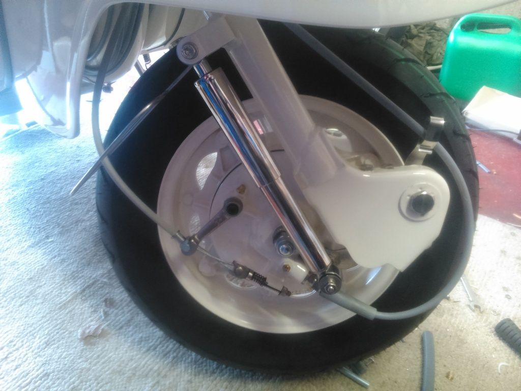

Decided to follow nobby's lead and reverse pull my front drum brake. What a difference! It's not good enough to do stoppies but it's transformed it from something that looks like a brake into something that functions like a brake; which is nice.
I also changed the pos stainless spring between the shoes for an original one which has slightly surprisingly given a MUCH nicer feel at the lever.
