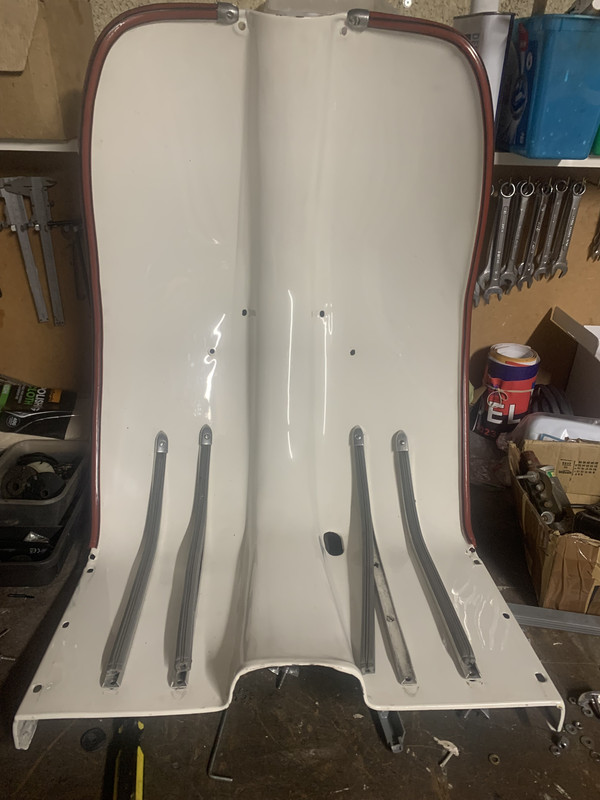

Plan B
Right back at the start of this thread I mentioned that I have enough spares to build several scooters- from a lifetime of hoarding I will admit. And a lot of this process is to use up the spares by building usable bikes. So in reserve I do have some panelwork.
If you went to Amsterdam a few years ago you might have noticed this TV200 outside the cannabis museum, a scooter called Sensi Seeds...
It went to Rimini for one of their 'Belair' builds and that involved being fitted with genuine New Old Stock Innocenti panels. Well those original Sensi Seeds panels changed hands a few times and some of them ended up with me. I had toyed with the idea of recreating Sensi Seeds but it was impossible to match the artwork. And it really was artwork - a shame to paint over it really. But I did, and I used them on this scooter, which was on the road as recently as the Arundel rally this year...
well that scooter is also being reworked, but I do still have the panels, so for now they will go onto the TV175. They may stay on there, I may rework the sidepanels, I don't know for sure - but pragmatically I want the scooter on the road as soon as possible and this is a quick fix to the blasted blasting probelm.
So here they are on the bench and I'm wiping off the dust of the Arundel rally. That was a good rally. Even with the Friday night rain. I bloody love LCGB rallies. Especially the Derby 150.
Having been on a rally bike for a while they are not pristine but I won't have to worry about getting that 'first scratch' on immaculate paintwork.

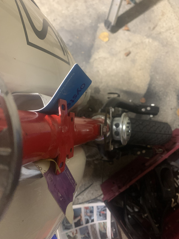

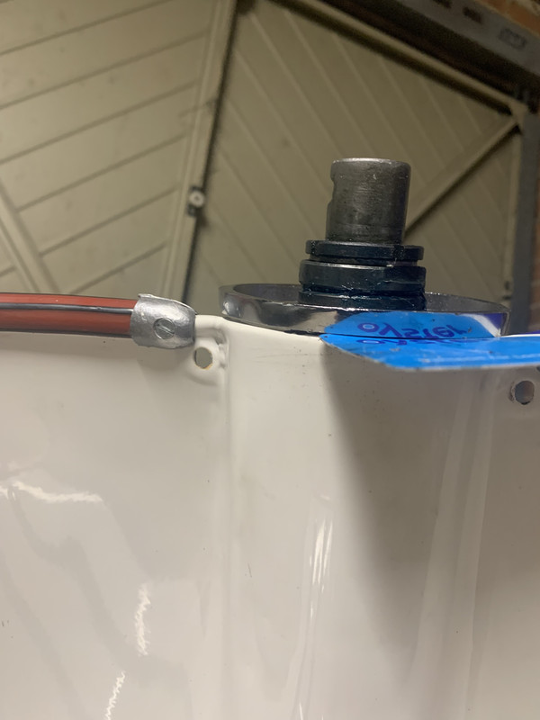

First things first - I TOOK THE HEADSET OFF!
Once it was mentioned that leggie installation could scratch the headset I couldn't get it out of my mind. I have previously installed them safely but with you lot watching there was every chance that I would mess up. Decision made on that basis.

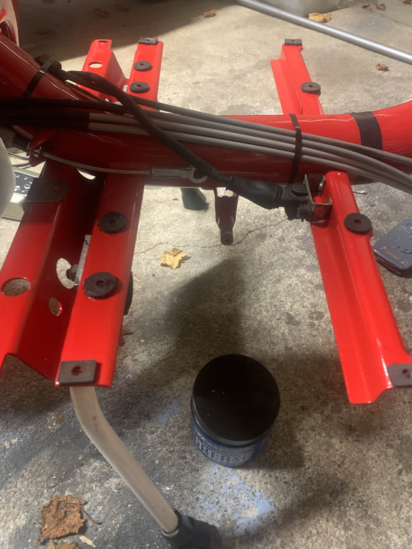

I've put the rubbers in place, held there with a dab of grease. But they can still get knocked out of the way no matter how careful you are. The factory glued them into place but I think you need to be able to move them around to align the holes.

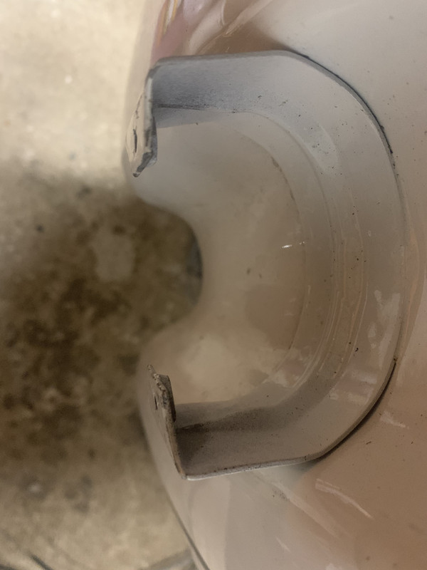

Getting the legshield top bracket around the steering tube can be tight, so before painting I file the bracket back as far as the nuts to make the gap as wide as possible.
So putting it on, base more or less into position, then ease the bracket around the steering tube. Those credit cards again...
and hold the top of the leggies loosely in place with the two bolts through the top bracket.

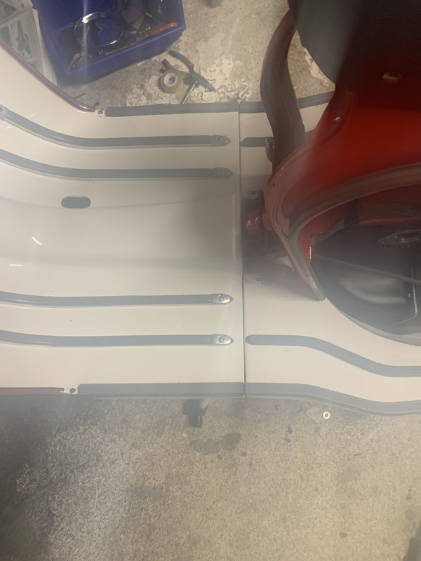

What I prefer to do is get all the nuts and bolts loosely fitted, but of course some of the rubbers will be dislodged. To get them all into place ready for the screws I use a scribe, the credit card (again!) and half a dozen tie wraps which are looped with a long tail, you can see them in the photo below. I push a rubber into place using the credit card underneath and centralise it from above using the scribe. Then, using a looped tie wrap, I keep the rubber in place by dropping the end of the tie wrap through the hole. The loop stops it dropping through and it will hold the rubber where it is meant to be until you have got them all in place. Once they are all in place you can remove one tie wrap at a time and drop the screw through the hole and put the nut/washer on to it.
The idea is similar to the way aircraft are built, the ali panels are held in place by clips called clicos which locate through the hole until ready for the rivet. Years ago I built a Lotus 7 type car and the clicos were really useful to get the ali panels on - this was the source of the idea.
One tip from Dean is not to put the legshields hard up against the chrome ring because he believes it will inevitably cause paint damage as the panels flex. He suggests a good gap to leave is the thickness of a credit card! That's it for the credit cards, we won't see them again on this build!
So everything tightened up and rear runners put in place to check the gap, I'm happy with that so a tidy up and that's it for today.

Last few sets of Sil panels I have got seem to be slightly too long on the corner. Could mould have stretched over time. Sorry Alex for butting in. Definitely grey with the grey floor runners too. Looks good
