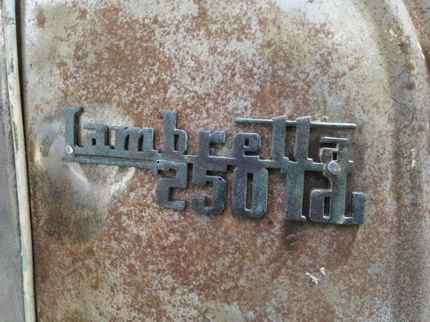

Postby carlos fandango » Thu Apr 30, 2015 11:27 pm
While im waiting for my docs to come back from DVLA ...for a third time....... hopefully with a reg number this time :)
I thought id fit my badge :)
