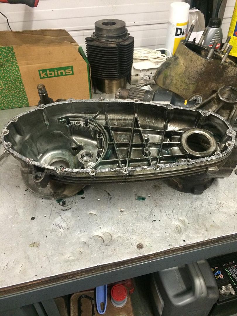

Well,engine is completely stripped.Casings are ready to be de greased and then off to be Aqua Blasted.

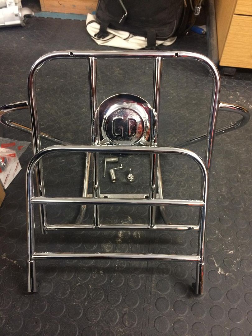

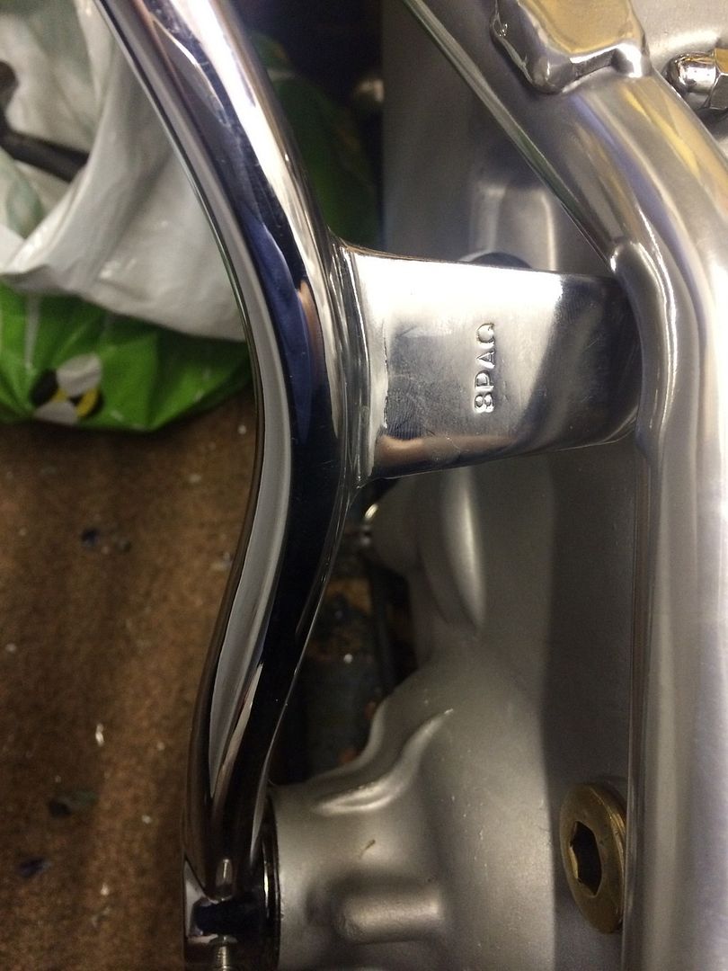

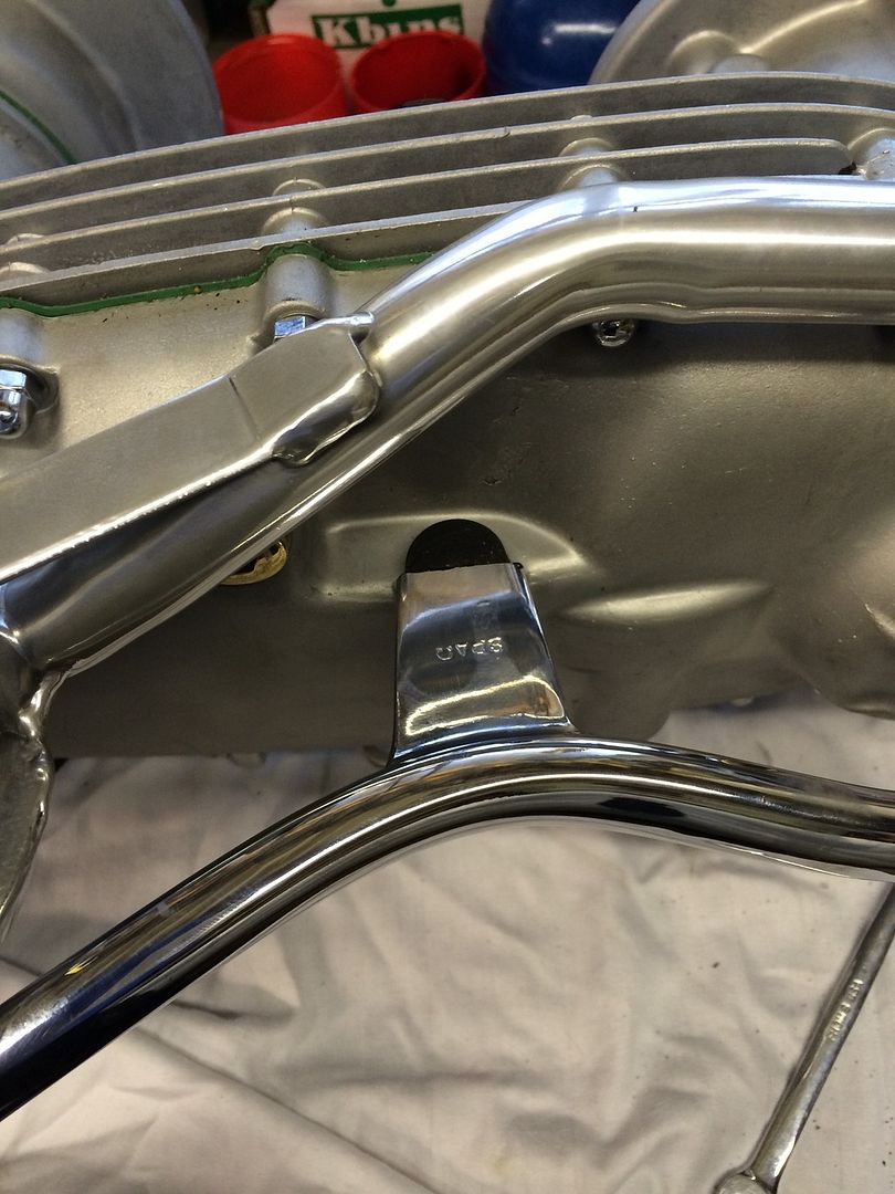

Had this back from the chromers too.Looks good.Now,I know some of you will say,"you could have bougth a new one for much less than it cost to have it Chromed".And you would be correct.But as this came on the Scoot,I thought it could be an old one,so that's why I did it.I have looked at loads of these type of rack,but haven't seen any with the letters on the round bit that holds the stud that holds the spare wheel.
Right,whos going to tell me its a Chinese one :lol:

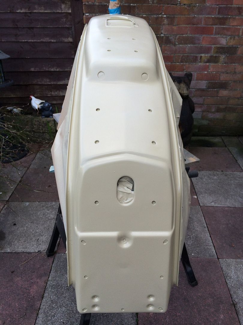

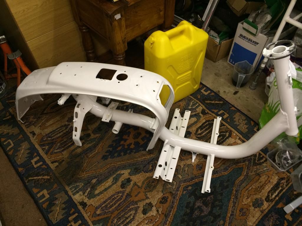

Postby dave411 » Tue Dec 23, 2014 9:03 am

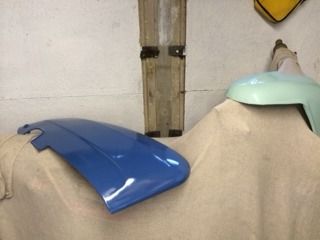

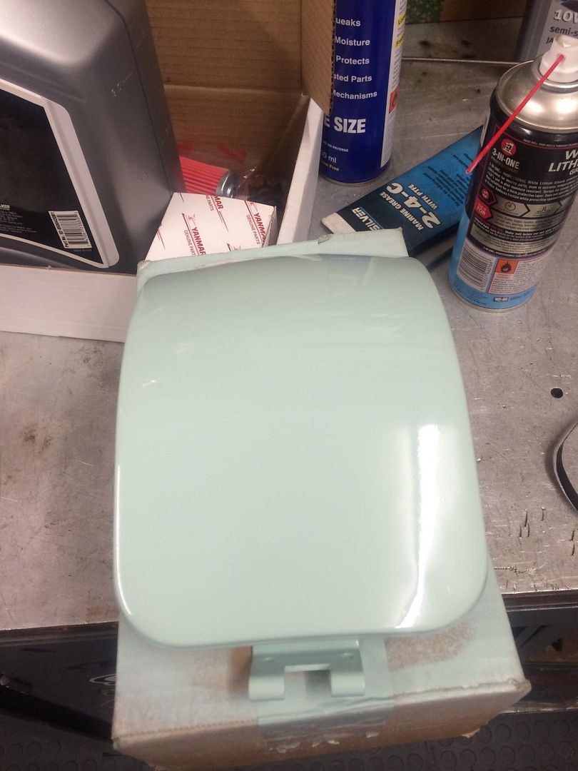

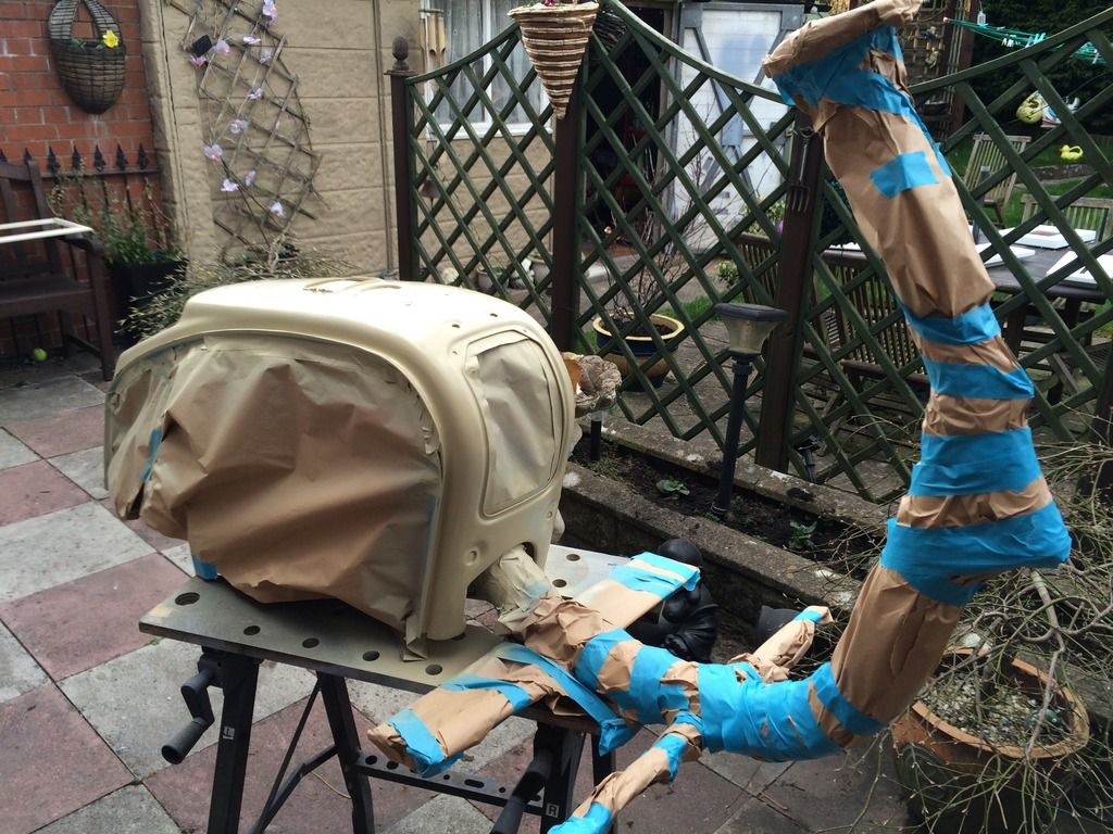

Finished painting the tool box door.If the rest turns out the same I will be well pleased.

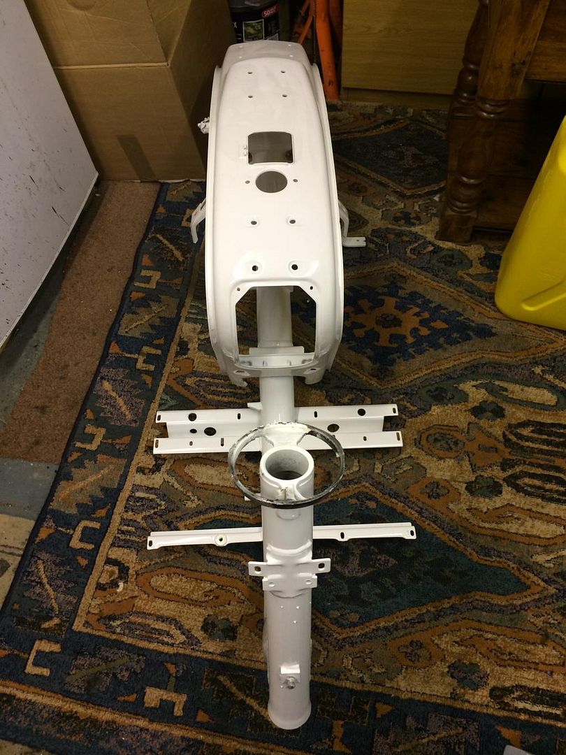

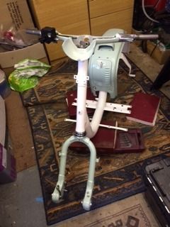

Got the frame back yesterday too.Just need to paint the "outside" bit,if you know what I mean.

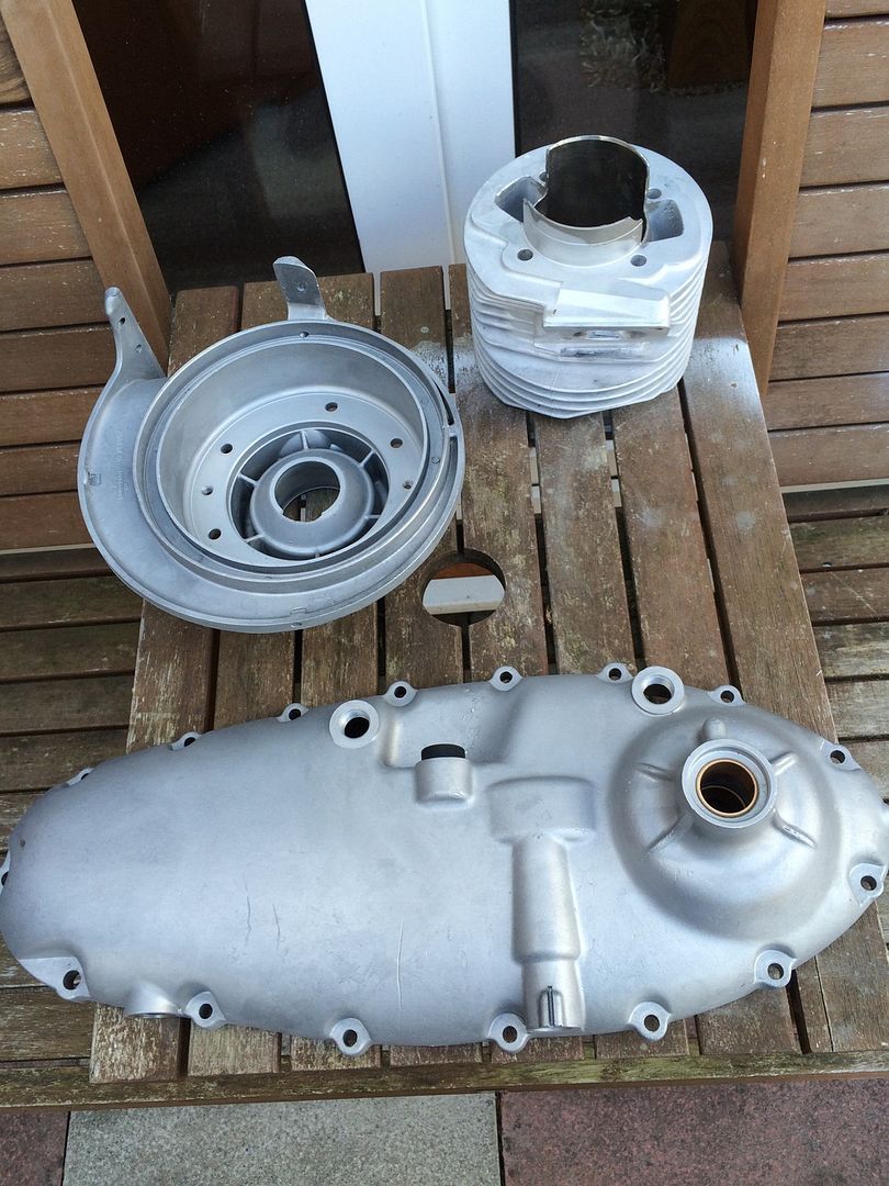

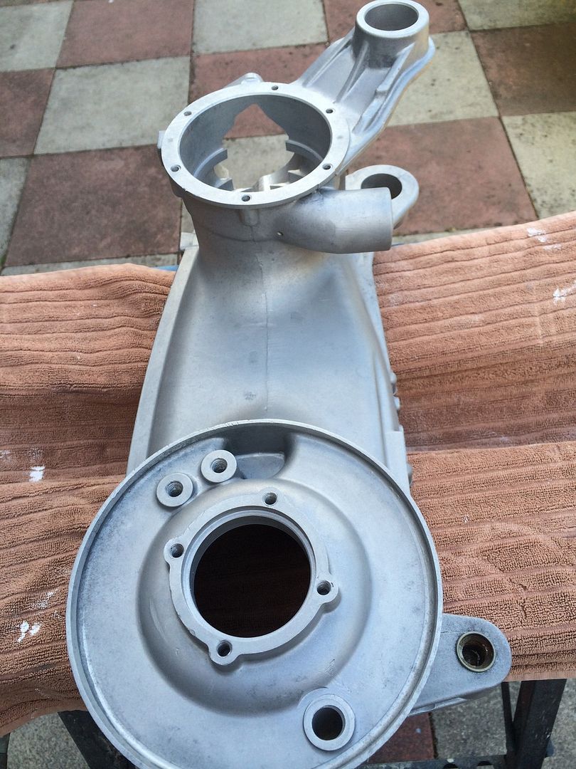

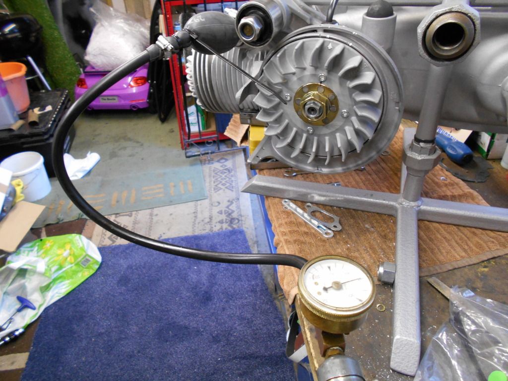

Had the casings vapour blasted.

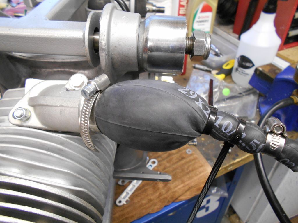

Did a pressure test,no leaks,thank goodness.

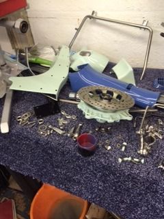

Postby dave411 » Thu Nov 26, 2015 2:38 pm
A bit of primer.
A splash of paint from a spray can.
dave411
i'm interested! anyone?

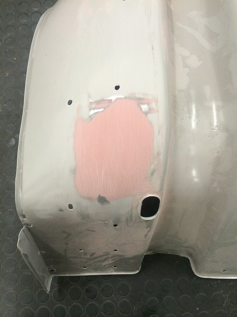

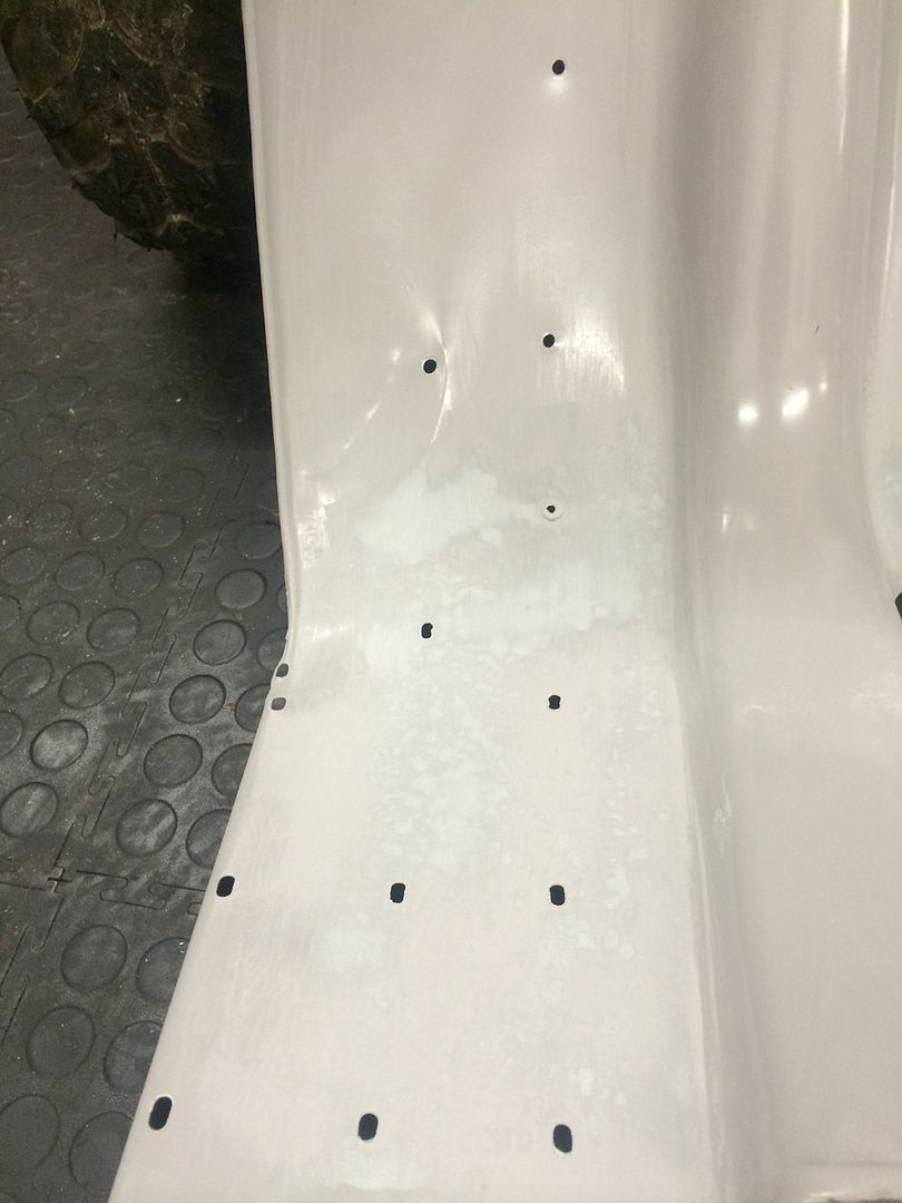

Postby dave411 » Mon Nov 30, 2015 10:34 am

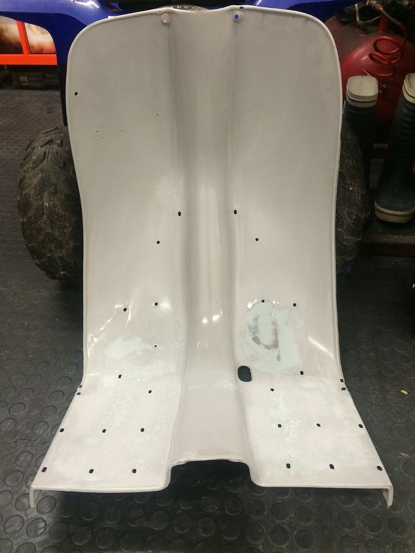

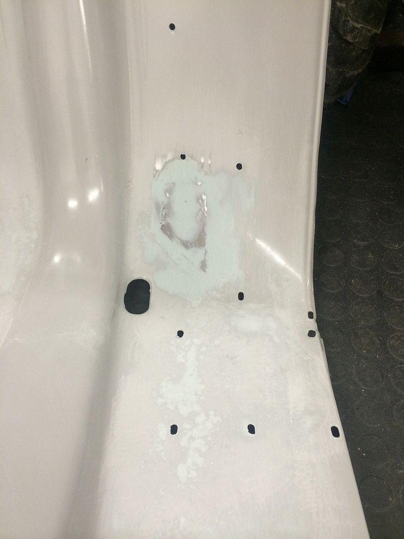

Did a bit of work on the legshields yesterday.Welded a small plate in where is had rusted through,
And a small amount of filler on the floor where it was peppered with rust.
All in all,they are not so bad considering their age.Alot better than some of the floor was on my 2CV,and that's 1989 :lol:

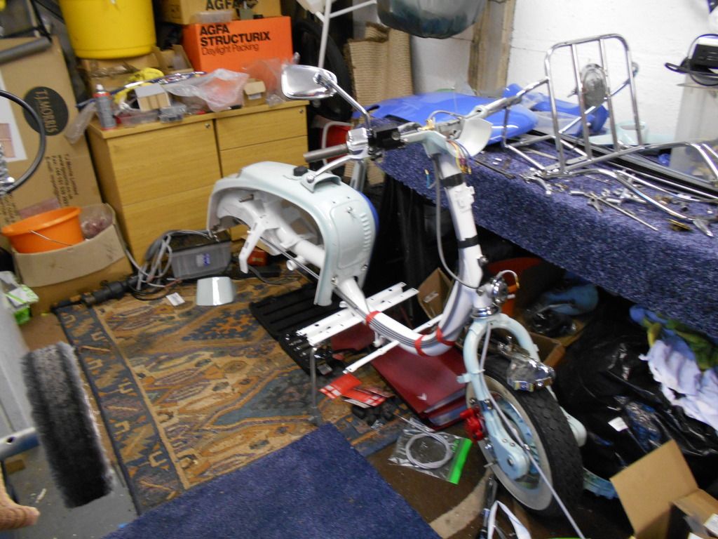

Postby dave411 » Mon Dec 28, 2015 9:47 am
Had to put all the pics up in one go,for some reason my Computer has decieded it doesn't like Photobucket,keeps shutting it down :shock:

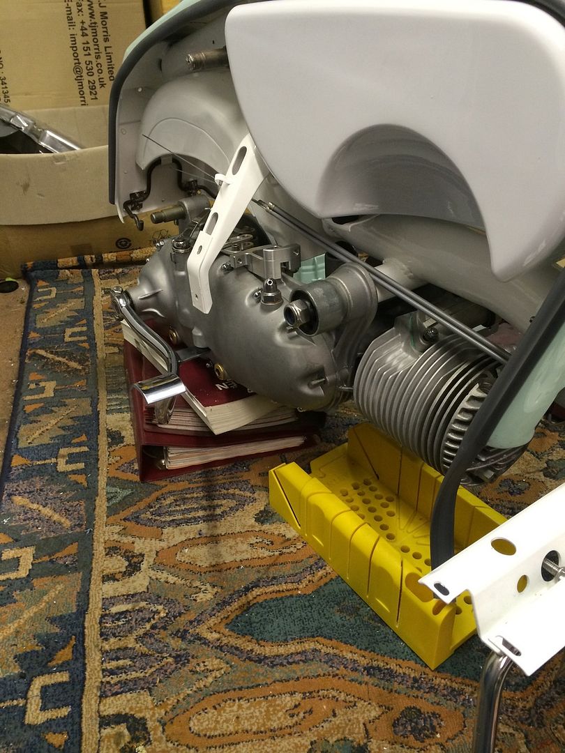

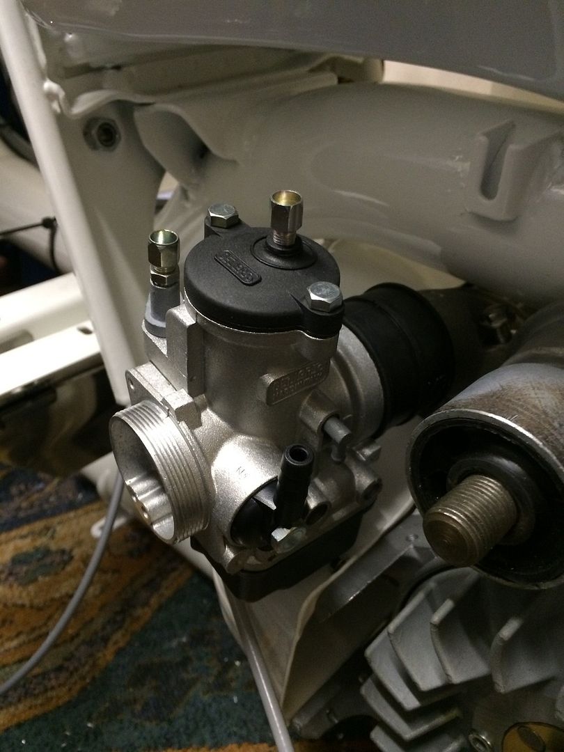

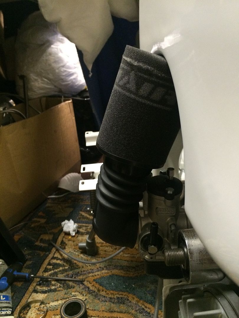

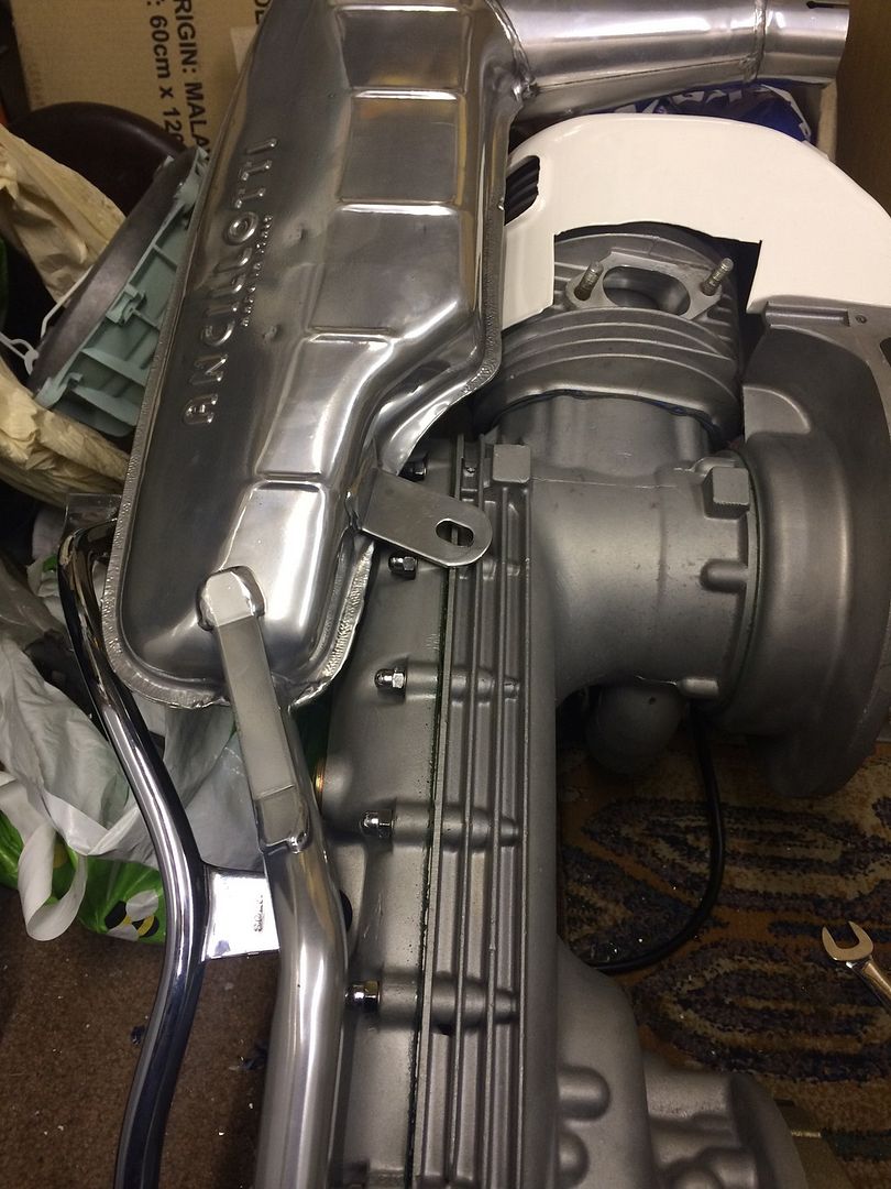

Anyway,got the engine in,fitted the inlet manifold,but the carb seemed to be on an odd angle.I was told that this was quite normal,and that the engine would run ok,but to me it just doesn't look right.Also,the air filter wouldn't fit properly.
Bought a new manifold from Rimmini Lambretta,looks much better,and the filter fits ok now.

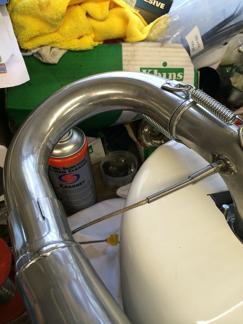

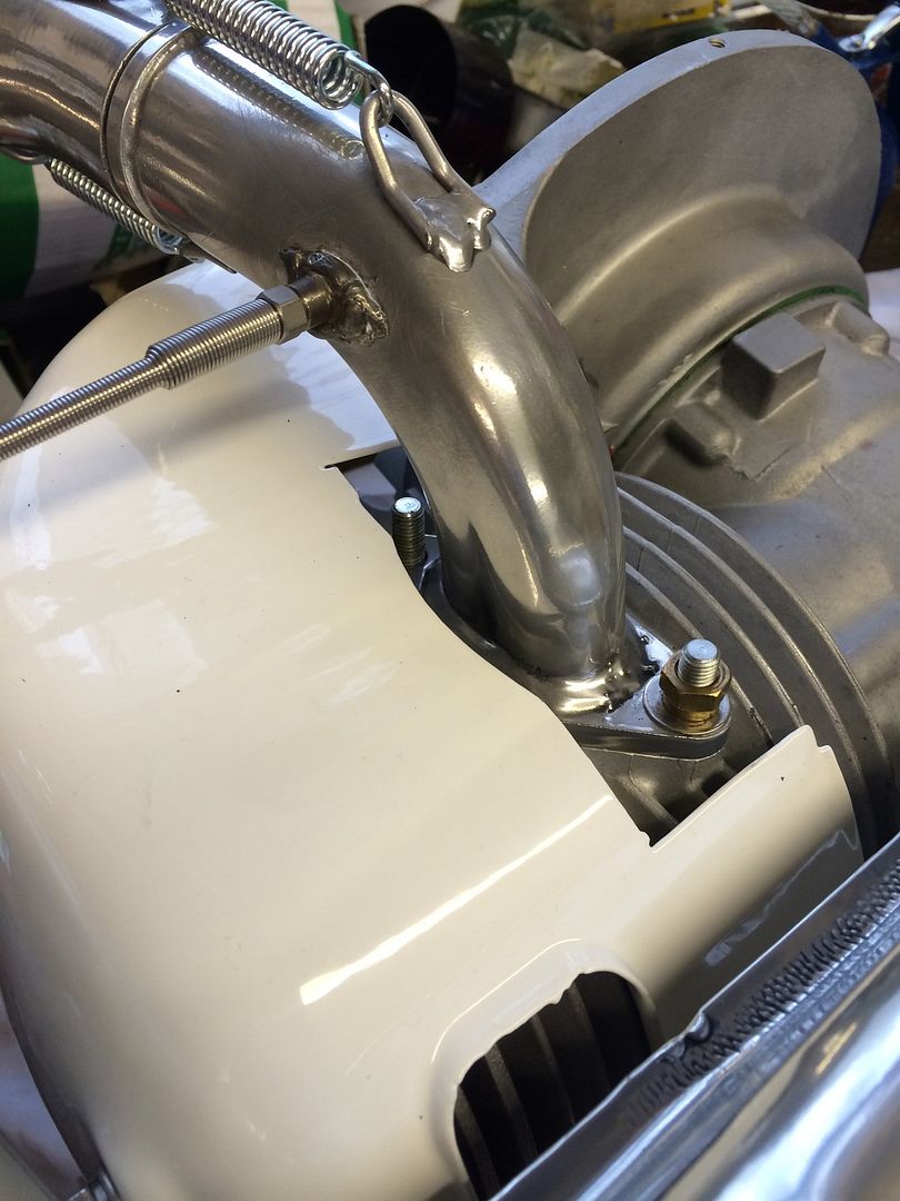

Next was the exhaust.Managed to get it to fit,after more advice,but I will need to cut that tab off and re weld it.Also need to drill and tap a new hole for it.
Now a bigger problem has reared its ugly head.I had some work done on the cylinder by a Dealer,they also set the timimg,but they didn't mark the stator housing,so I decieded to buy a degree wheel (which came without any numbers marked on it :roll:).First job,undo the flywheel nut.Left hand thread,no probs,it moved a few turns then locked up solid ?????
Turned it back the same amount,locked up solid again????? New Crank,new nut,only been tightened twice :cry: :cry: :cry: :cry:

Newbie question, but can you tell me what the sensor is for inserted in the manifold please?
Kristof Lammy pie
Posts: 298
Re: Daves Li resto
Postby dave411 » Tue Dec 29, 2015 9:47 am
Its for the Exhaust Gas Temp gauge.I hope its in the right place.
