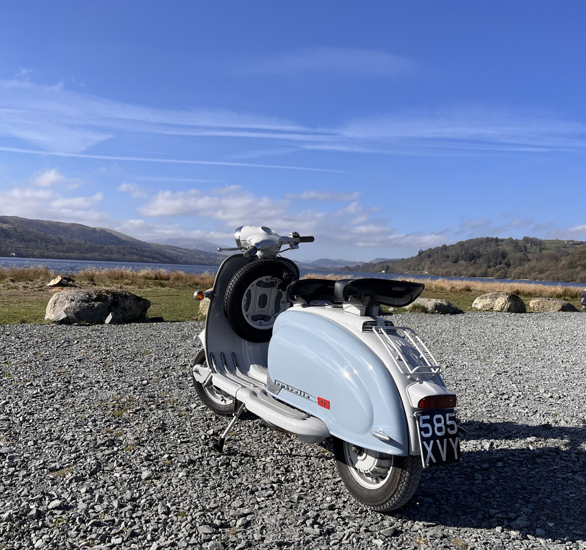

Postby Storkfoot » Sun Apr 06, 2025 8:11 pm
102 mile round trip to Bala Lake this morning. Messed around, yet again, with the jetting on route. Went from a d22 needle, second clip, to a D26 needle second clip and then finished the day on the second clip of the d22 with a 1/2 washer. I wasn’t doing plug chops, just listening to the engine. I’ll have to do a few chops before Scarborough though.
If only there was a dyno within 70 miles :(
It’s a Stage 4 200 with a PHBL25 - pilot50, slide 40, atomiser AQ266, main 102. AF 42mm Clubman.
I have to say that the indicators are a joy to use and make any longer journeys so much more relaxed. The tiny LED ones at the back may be out of keeping with a 1960 vehicle but I know that they are so bright that anyone behind cannot fail to see them. I had to add the back ones as I found that I couldn’t be sure that drivers behind could see the ones on the legshield.

Re: Series 2 With Jet engine
Postby gaz_powell » Mon Apr 07, 2025 7:36 pm
Another lovely job there Paul
