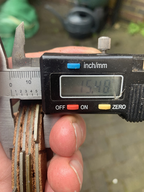

Well for a variety of reasons I’ve not put the miles in on this engine but with the dyno deadline approaching I need to knuckle down.
The test ride/maiden voyage highlighted a major problem with the clutch. Massive drag. I didn’t build the engine, if I had built it I might have checked the clutch a bit more thoroughly.
So pulled it apart and the first thing to check is the thickness of the friction plates, which should be no more than 14mm.
Oh dear. That’s almost certainly the problem

What make plates?

Postby alex_hughes » Sun Mar 10, 2024 6:16 pm
Unfortunately I don't know, sourced by my mate who built the motor.
Camlam say the thickness of clutch friction plates is so random now that they always recommend 1.2mm steels. However even if I substitute the steels for 1.2mm that only gains me 3 x .3mm = .9mm so that is not enough to solve this problem with these plates.
Putting the clutch under the microscope reveals a certain amount of wear and tear. I have decided to bite the bullet and upgrade this clutch.
My S1 uses an AF six plate cassette, first consideration was buying another of these but on reflection I'm going for the Andy Francis five plate which uses standard shaped plates (but obviously thinner) and its the same sort of price.
Four reasons for this choice... my mate Andy recommends it - he has one in his red GP200. Second reason is that if I'm broken down on a rally I've got a better chance of getting standard clutch plates that I have of getting replacement AF cassette parts. Third, I've heard of people cracking their AF clutches using the AF holding tool. Fourth, Andy Francis uses standard shape springs and I may be able to experiment with lighter springs - balancing off clutch slip against a lighter pull.
So clutch ordered, waiting on Andy Francis now.

Postby gaz_powell » Sun Mar 10, 2024 8:14 pm
Just measured a set of 4x plates Readspeed Supergrip, bang on the 14mm.
Will be using these in next 4 plate rebuild
