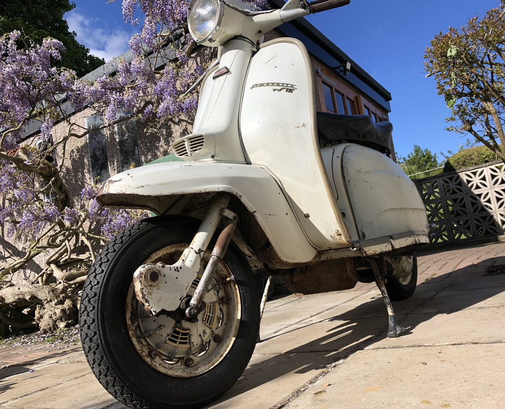

Standard Series 3 TV 175 rebuild. Trying to keep as much of original engine as practicable. That said, I am treating it to a Vape DC static electronic ignition, bearings, seals, a new Conrod and NOS piston too.
It is still on the original 62mm bore and had the original white engine mounts too.
At some point in its Italian past it looks like legshields and front mudguard have been replaced, as has one of the side panels. Probably at this time, years ago, it received a blow over in white too.

Postby Storkfoot » Sat Jun 26, 2021 2:10 pm
Toddy wrote:You have some projects on the go Paul ;) looks tidy that one
Sold a Vespa and couldn’t resist this :shock:
