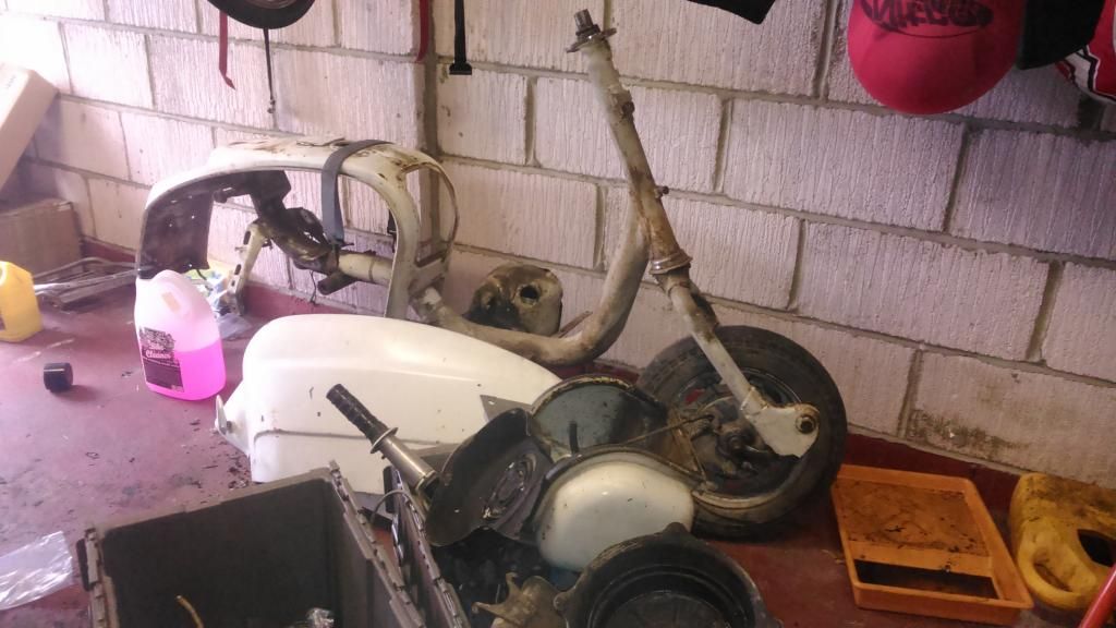

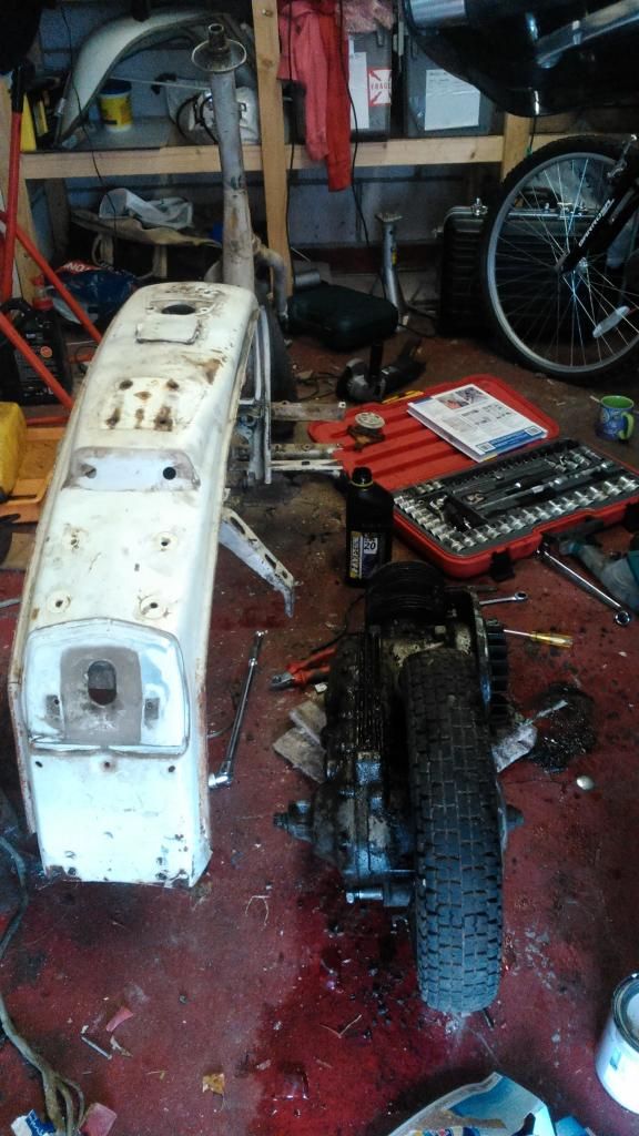

I'm a Lambretta novice (had a few vespas in the 80s, but sports bikes ever since). I bought this for something to tinker with in the garage and have ended up doing a full rebuild. I'm not really restoring it as I'm not a purist, so fasteners will be plated to my liking and the final colour won't necessarily be original Lambretta, but to the untrained eye it will look original.
The day after I got it:
A couple of days later:

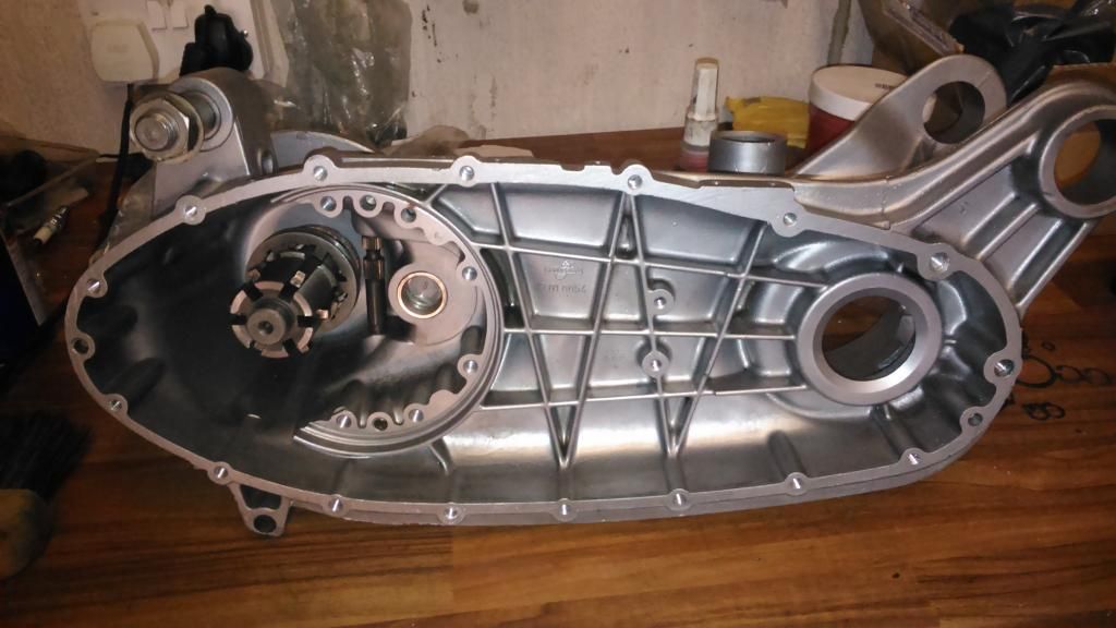

A terrible photo, but gives a general idea of the state of the engine:

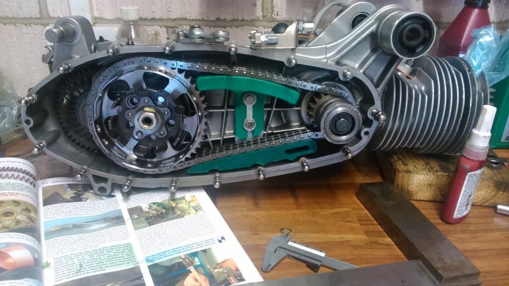

The start of its resurrection:
Don't buy cheap chain guides if you want them to fit:
Ready to go into the frame:

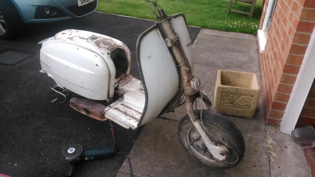

Not sure if you're being sarcastic or not, but it was a wreck before I stripped it:
Seized top end, snapped exhaust, bent forks and frame, splits in every panel, rear hub rubbing on engine case etc etc
The only thing that 'worked' was the rear brake and the hub was full of gearbox oil!

Postby dickie » Tue Oct 14, 2014 7:43 pm
dave411 wrote:how did you clean the casings?
I spent hours chipping off what seemed to be a combination of oil and dust caked hard onto the casings, then when they were reasonable, I had them vapour blasted at North East vapour blasting.
He's a decent chap (his brother is a Lambretta enthusiast/painter/blaster/panel beater/frame jigger)
Cost £65 for all 3 casings as he charged me extra as they were so filthy. Normally £50

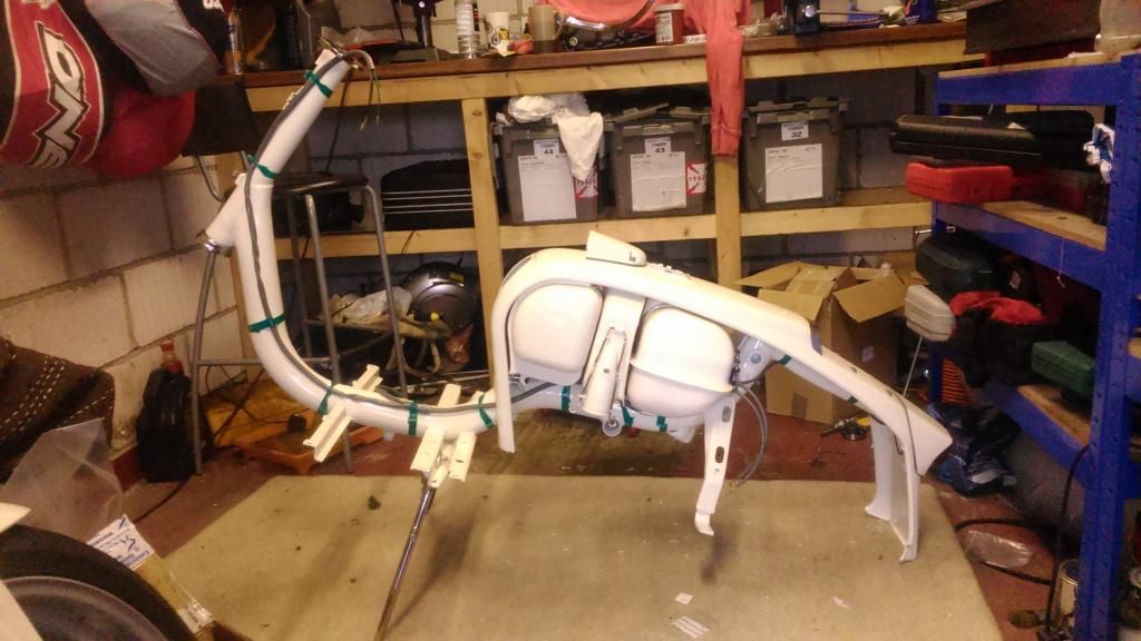

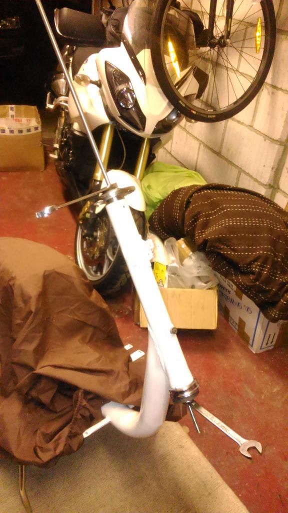

Postby dickie » Sun Dec 14, 2014 1:05 pm
Pulling the bearing cups and chrome ring (actually a stainless aftermarket one) into the frame tube.
I started by using M10 studding, but to be honest it wasn't really up to the job and I could feel it beginning to yield, so I finished the job with a 3lb hammer and drift. M10 studding is good for 6tonnes, so I was surprised that it wasn't strong enough. Anyway, brute force and ignorance won the day
And now it's starting to look like a Lambretta.
Hardest job since I started to the chassis build has been the plastic drip tray! It must have taken 3 hours to get the little bastard in place!
Anyway, onwards and upwards.

Postby dickie » Tue Dec 16, 2014 6:28 pm
As mentioned earlier, I had a real nightmare trying to get the drip tray in.
I ended up trimming quite a lot from the top of it to make it fit, but it's in now and neat.
However, I just fitted the fuel flap and I can't get it closed as the drip tray stops the 'springs' from entering the square hole for the fuel cap.
I'm now wondering whether or not I should have a drip tray; as far as I'm aware, series 2s didn't have one and I'm wondering if early series 3s are supposed to have them.
Or maybe I've just got a poorly fitting one?
If it's any help, the drip dray is made by Atomic

Nowt special, just an Indian 190 barrel with a mild tune and blueprint. I spent a LOT of time shimming everything, matching ports/manifolds etc. It's got some mildly interesting stuff like lightweight rear sprocket, gp crank, varitronic but broadly speaking it's been built using quality components and been well set up.
I was after reliability and low down torque more than power. That said, I wish I'd bought a quality cylinder kit like mb195 or mugello as the rest of the motor is top quality but with a cheap top end!

Postby Wack » Wed Dec 17, 2014 10:11 pm
Buy the drip tray from Restorations as they do one that fits well. http://www.scooterrestorations.com/lamb ... ash-cover/
