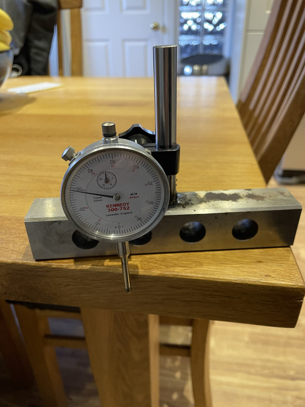

Checking crank for throw as a possible cause. Looking at this picture I see the DTI mag stand if fixed to the surface plate I made as a 17 year old apprentice.
Sprocket alignment was checked using this home made DTI stand using an old parallel and a length of silver steel welded to it.
I could find nothing wrong, and nothing I tried made any difference or influenced the vibration, it still persisted.
In the end I tried removing the engine for the 2nd time and replace the new BGM engine mounts from the recent rebuild using SIL engine mounts from Scooter Restorations.
I did say to leave the difficult stuff until last!
Instantly that solved the issue - it can have been nothing else but the BGM engine mounts.
