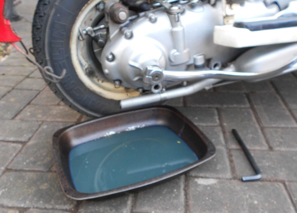

Postby Chadley » Sat Oct 29, 2016 2:12 pm
Did it look like this?
That's about 800 miles on Putolene SAE90. I thought it looked a funny colour but that's how it always looks when used on mine.

Postby citydaz » Wed Nov 02, 2016 11:08 pm
Yes a similar colour to that.
I have topped it up with new Rock oil.
I think I will leave it and see what happens
cheers
