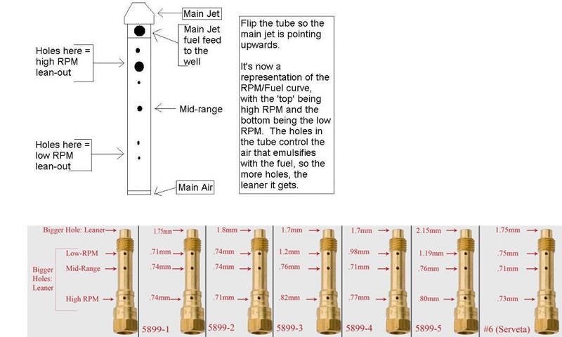

What is the best way to richen up the mid range on these carbs?
Thanks for any pointers.

there's something somewhere regarding the 5 different atomisors in the 'sh' range bud 8-)

I've found the sht but forgot how to upload on here cgt75b
so here goes:-
weakest midrange - 5899-4 & #6 (servetta) = 0.71mm
middle midrange - 5899-1 & -2 = 0.74mm
richest midrange - 5899-3 & -5 = 0.76mm
hope this helps bud 8-)

I looked for this the other day and couldn’t find it. I have now :)

thats the filly I was reading from storkfoot 8-)
