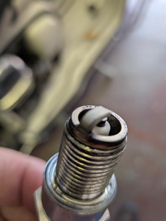

Obviously the plug is far too lean so I suggest firstly checking that the airbox hasn't been gutted, ie the swan neck removed as this will drastically alter the airflow and would need far bigger jets.Next is to try a 5899-1 as this has smaller air bleed holes so richens the mixture up even though the atomiser bore is slightly smaller than the 5899-2.Lastly.the motor could have an air leak.

I've just done another plug chop 2nd gear uphill for 15 sec and it looks like it too weak. I think I will take my exhaust off and measure the bore Image

I've just done another chop and it looks like it too weak I will have to take the exhaust off and measure the bore Image

It's advisable to do plug chops on an older, used plug. They give a far better picture of the mix.

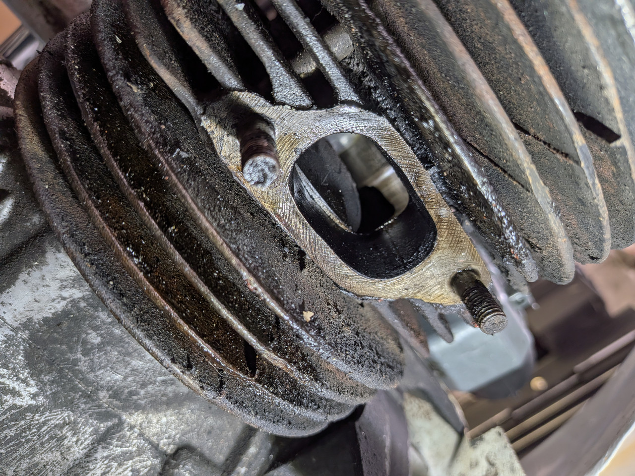

Postby Storkfoot » Sun Aug 09, 2026 10:43 am
Rushy wrote:I've just taken the exhaust off and measured the bore and it 62mm. Dose it mean it's a 175
Yes it does. It could be a rebore on the original barrel or an Indian conversion barrel. I’ve never checked the timings on one of the Indian barrels but I have heard that they can be a bit hit and miss. If the timings are alll over the place, it can be a struggle to jet the carburettor.
Please post some pictures of the outside of the barrel, showing exhaust and inlet and also some pictures inside the bore showing the ports inside.
Posts: 2539
Re: Carb problem
Postby Rushy » Sun Aug 09, 2026 4:07 pm
Here is the photo of the exhaust port. Image. I've managed to find an airbox with the swan neck still in so I am going to fit that and start from scratch and set up for a 175.
