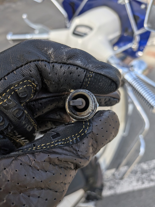

I've just done another plug chop 2nd gear uphill for 15 sec and it looks like it too weak. I think I will take my exhaust off and measure the bore Image

Postby Rich Oswald » Sat Aug 08, 2026 8:02 pm
It's advisable to do plug chops on an older, used plug. They give a far better picture of the mix.

Postby Rushy » Tue Aug 25, 2026 6:12 pm
Just done another plug chop what do you think Image

Re: Carb problem
Postby Rich Oswald » Wed Aug 26, 2026 9:25 am
Still very slightly weak, imo.
