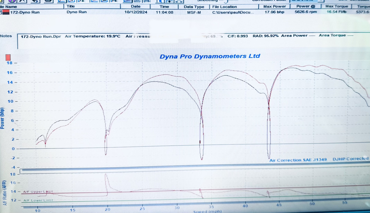

Postby Pompeydave » Sun Oct 13, 2024 7:29 pm
Imagecdn images
Hi all, here’s yesterday’s dyno run. The revs are doubled and the HP figure is 7BHP over actual due to a software glitch apparently so it’s making only about 10bhp currently. Thoughts?

Postby Storkfoot » Sun Oct 13, 2024 8:30 pm
The Air Fuel ratio seems okay. It’s on the rich side of the line but not so far out that it should be the cause of poor running.

Postby Pompeydave » Sun Oct 13, 2024 9:28 pm
Yep, the 30 slide seems to have been what caused it. This run was with the 40 fitted.
