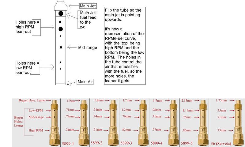

Am I reading this correctly in terms of the influence of the main jet? The main jet will only influence running over, say, 3/4 throttle and not before?

Isn't that the same for other carbs too, with the main only having influence below 3/4 if that influence is that the main is too small and poses a restriction when it shouldn't be?
SH carbs are slightly odd though because the atomisers do not function in the same way as needle carbs as an atomiser with a bigger diameter central drilling can be weaker for most of the range than one with a smaller drilling, which takes far less air-flow over the end to suck up the column of fuel (easy to suck through a thin straw than a big diameter one).
SH carbs are quite different to get your head around their function. When others ask 'which is richer?' that show that they have yet to grasp their function as the question should be 'which is richer at what revs or air-flow?' as that's the function of the size, number and vertical position of side drillings... all being influenced by diameter of central drilling.
NB: it is very common to find that 200 (5899-2) atomisers provide too much too soon, meaning that the correctly sized big main for big motor will flood out at 1/2 to 3/4 and never get to WOT. In which case you often find that a weaker atomiser keeps it weak enough through the rev range, without begging, to then run correctly at WOT with the bigger main. A common example is 225s blogging out with any main over 123'ish and -2 atomiser but will happily run the weaker GP150 -4 with much bigger main 125-135, running clean throughout.
SH... not as simple as rich vs weak. Rather, rich vs weak where?
