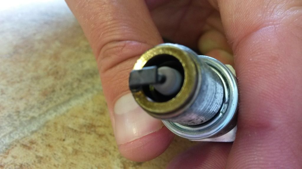

continual problems with the 6 volt ignition so upgraded to 12 volt variatronic ignition, was advised by cam lam to up the jets.
the barrel is at 67 mm
the original jetting is pilot 45 main 118.
increased the pilot to 48 and the main to 122 then 123 then 125 and now at 128 after plug chops it still shows its running lean
tried 130 main and it wont rev into it
it starts fine and ticks over ok but up to half throttle its 4 stroking when you open up the throttle it fly's

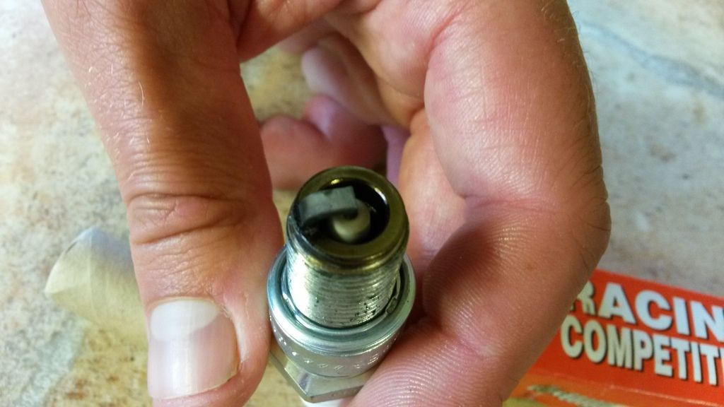

fitted a brand new plug rode 19 miles quite hard riding and then rode this 1 mile straight road into a head wind over 3 quarter throttle, pulled clutch in turned off coasted then checked plug looked lean
is anyone running a variatronic on a standard 200?
