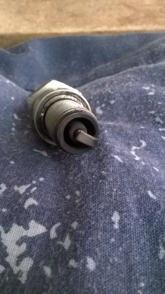

been trying to jet a 26 phbh, pic of plug was taken at 1/4 throttle run.

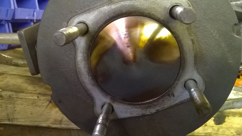

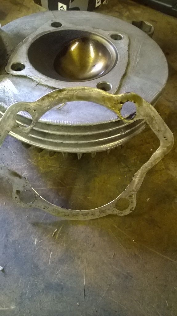

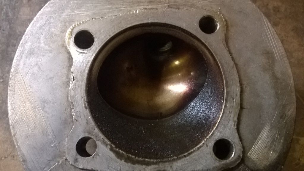

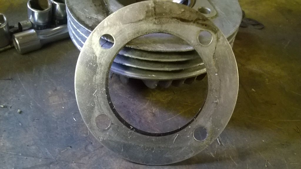

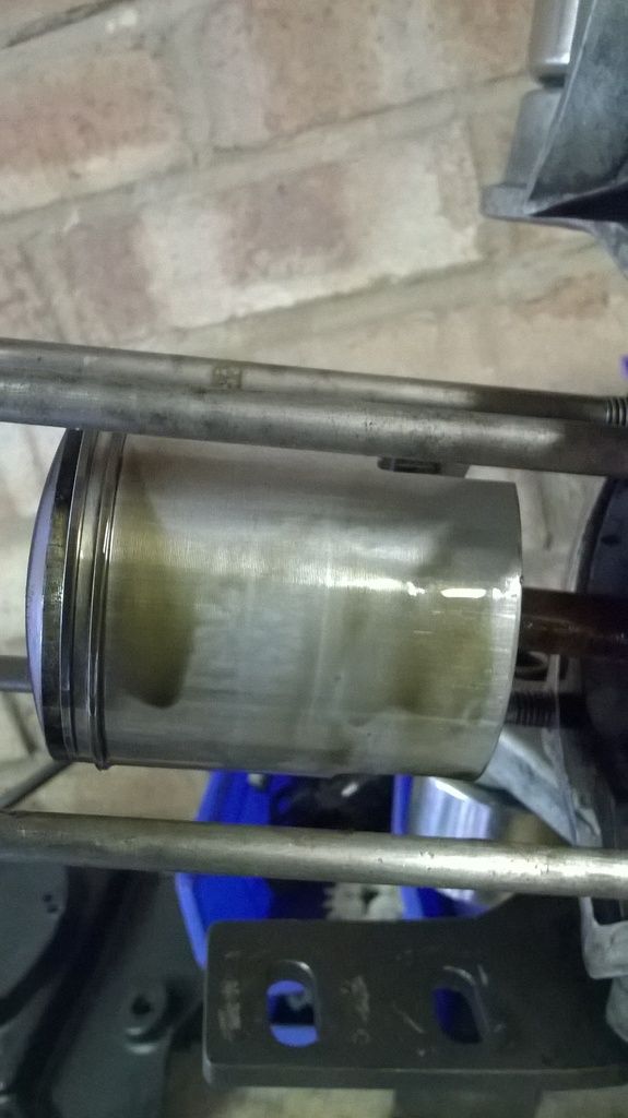

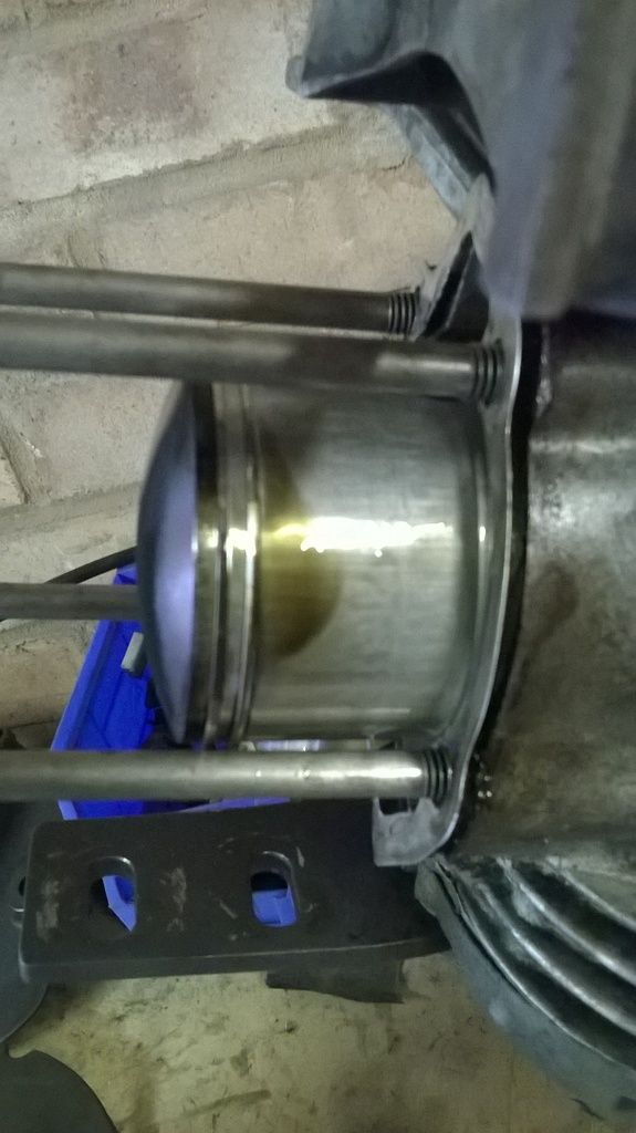

Postby skinnerwill » Tue Aug 18, 2015 3:19 pm
stripped top end, seems to be a fair bit of oil on piston skirt although bike doesn't seem to smoke when been ridden
any other tell tale signs ?

Postby coaster » Tue Aug 18, 2015 4:40 pm
The oil deposits look healthy, there is some slight blow by below the rings so maybe compression is down a bit but air leak wise the base gasket looks a bit suspect around one of the stud holes :?

Postby skinnerwill » Tue Aug 18, 2015 6:51 pm
I had a chat with lad at MB, he said pretty much same. told me to ride it quite hard for a while and then try doing some more plug chops as really couldn't tell from one that's in with it being new
