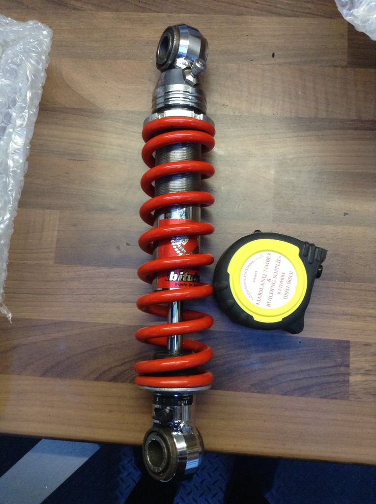

I have an adjustable shock to fit but which way? I would think it is piston shaft to top and adjuster nuts to bottom, but all the writing on the shocker is upside down? Perhaps it's Australian!

it will work either way.
the R1 shocks on some series 1/2's are sometimes fitted "upside down" for clearance issues.

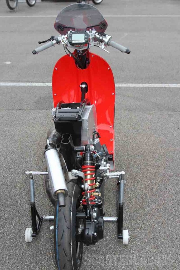

[url][/[URL=http://s1260.photobucket.com/user/MickyTapp/media/image.jpg1_zpskbdz2qxt.jpg.html]Image[/url]url]
I think this answers it just found it on SLUk's site picture taken by Lee Hollick http://leehollickphotography.zenfolio.com/f1010273017

Postby Scooterlam » Tue Mar 22, 2016 11:41 pm
The current perceived wisdom is the heaviest end attaches to the frame.
It's all to do with minimising unsprung weight.

Postby MJD » Wed Mar 23, 2016 7:53 pm
Scooterlam wrote:The current perceived wisdom is the heaviest end attaches to the frame.
I can get to that Scooterlam, gonna fit as in the pic, heavy end to frame and pogo to Whitby this weekend and report back

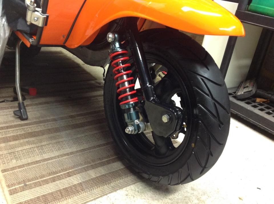

[url][[URL=http://s1260.photobucket.com/user/MickyTapp/media/image_zps0qsn9txi.jpeg.html]Image[/url]/url]
Eco ado mount their's t'other way up, seems as though Mickyork is correct, either way works
