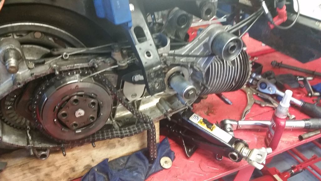

Hi, I;m trying to change front sprocket without removing top end and engine in bike. have in 2nd gear and daughter stamping on the rear brake but i just seem to be winding against the spring with no give in the bolt..bike also sliding along the bench and rear wheel slightly turning at max elbow torque!
any quick tips or tricks out there, hoping to sort out tonight..next plan is clutch plates out and clutch holding tool bolted in place
cant find my impact driver as was planning to give that a go also

I would sooner use an impact gun, too, but as you say....
I can't really recommend this, but have done so myself, so:
Jam something alloy or copper, brass in the chain to clutch sprocket 'nip'
You shouldn't damage anything if the material used is softer than steel.
Gulp! :?

bit of a "roadside repair" and not really recommended but !! we jammed a cloth in the chain which jammed everything up nicely....
....................or use a flywheel holding tool

likely to twist the crank using a flywheel holding tool.
Not sure why your not just using the clutch basket holder, you must have one if you are planning on removing the clutch?

Once you've stopped the chain turning use a good 6 sided socket then take up the spring tension and give the ratchet a sharp jab with the palm of your hand. The shock should break the threads grip, other than that someone has over tightened the bolt in the past. Torque to 25 ft/lb up to 30 on a tuned motor.

thanks everyone, really swift replies..much appreciated, ...will be trying clutch holding tool now, but really like that last gadget..someone should make and sell those..the 6 sided (and i read elsewhere on here) grinded down socket will be next on my shopping list for future use

clutch out and clutch holding tool it was, a doddle thereafter..btw, I replaced with a Jockey Boxenstop chain guide, with it pushing down and then measured the float/slack at top near the front sprocket..set to between 6m and 8mm, loctited two screws in place...stickys book says 6m is about right ..just interested what others do
