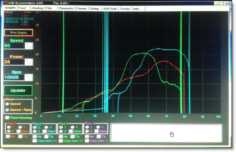

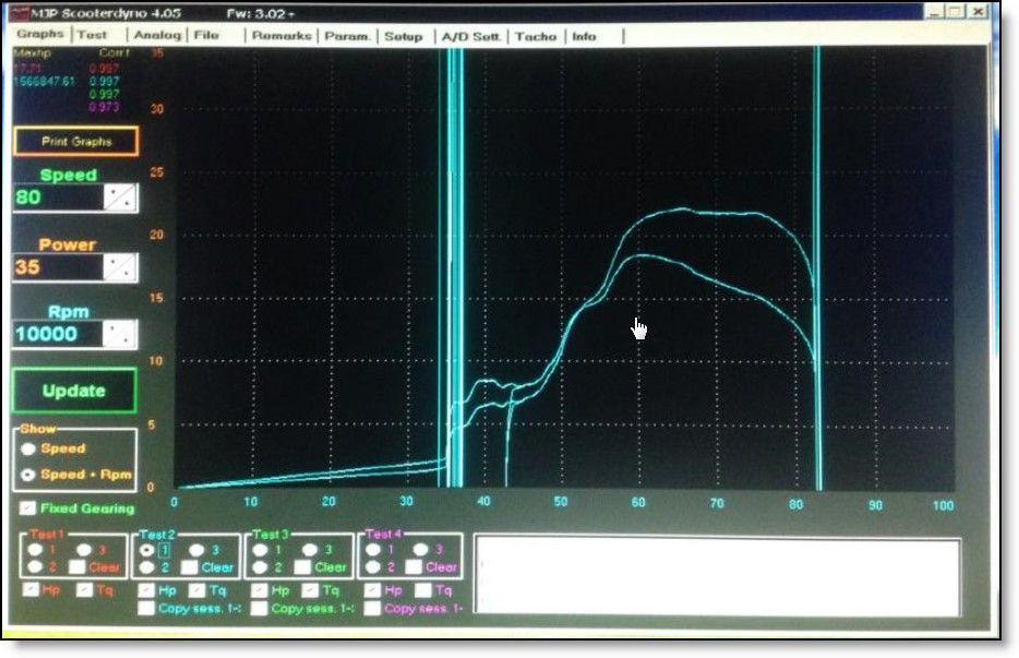

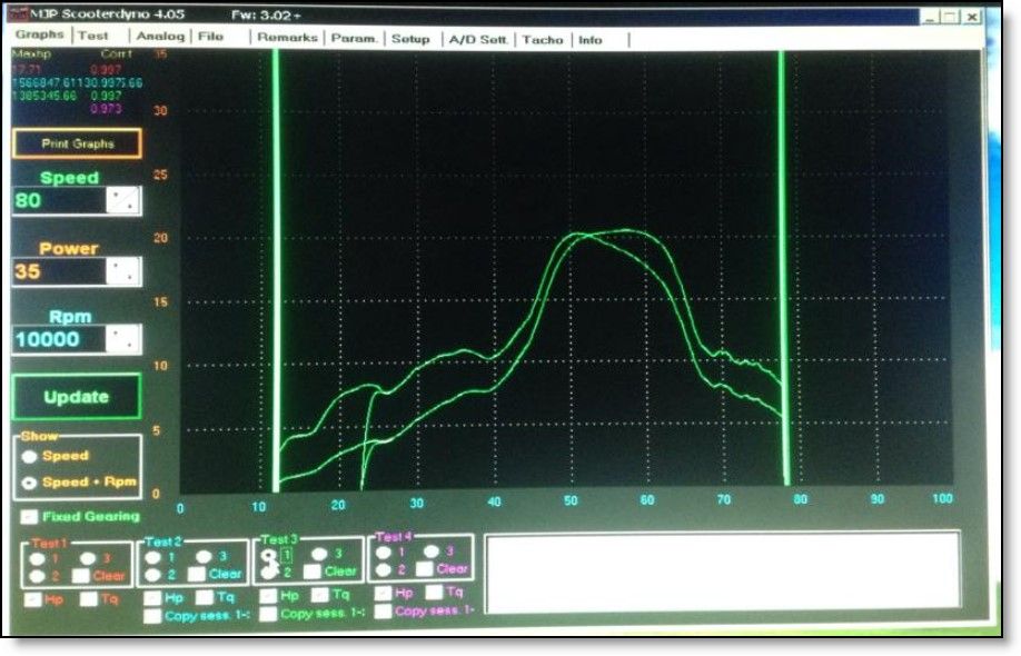

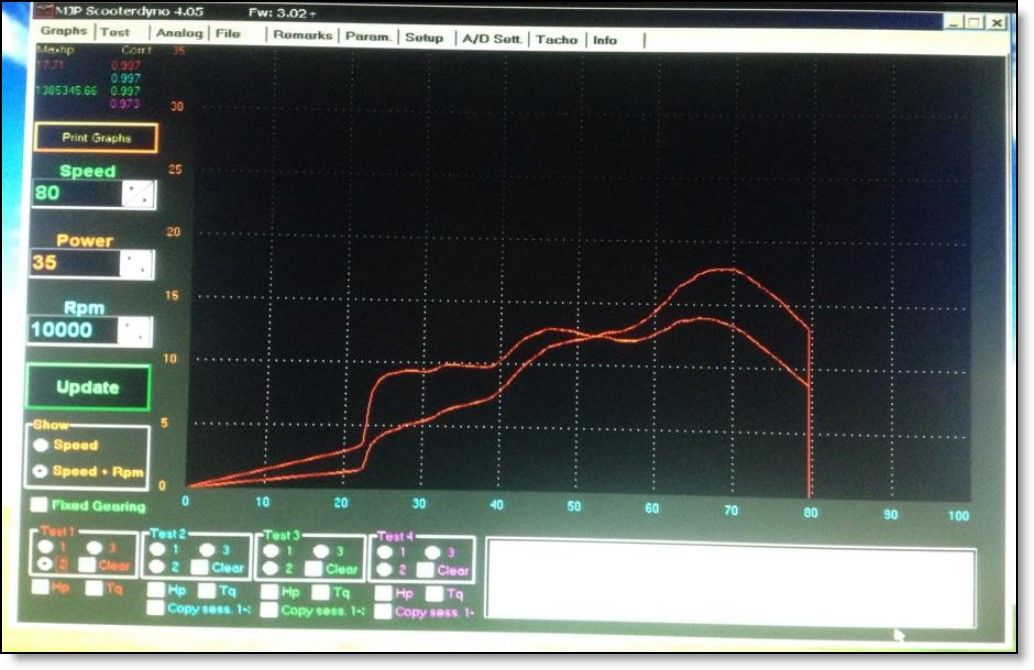

Of interest when it was setup on the Dyno - The exhaust was swapped to measure the difference
here's the figures
Red graph is with a BGM big bore.17.7hp 13.8ftlbs
Green is ADS3 20.2hp & 20.2ftlbs
Blue is a Franspeed Race 22.1hp & 18.4ftlbs
