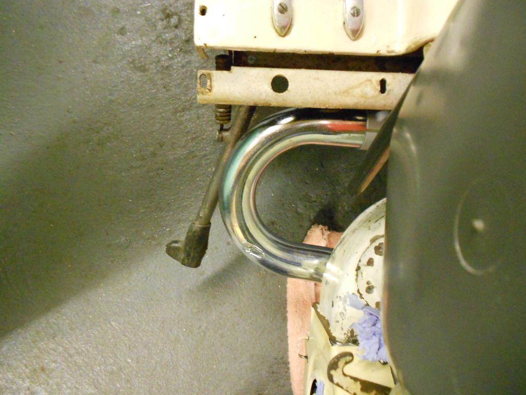

Postby Chadley » Sat Mar 18, 2017 2:58 pm
I fitted one in 2013 and that fouled the stand. I think the newer ones may to a revised design.
This was the problem:

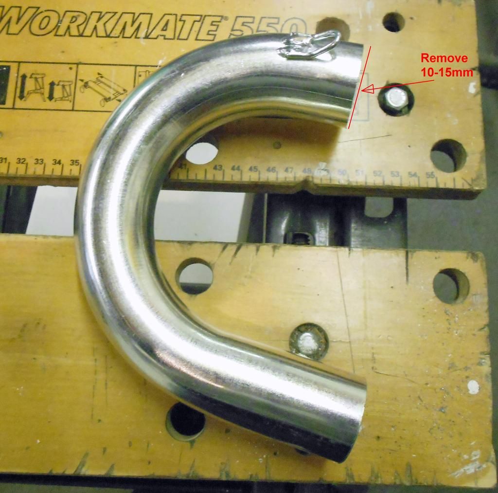

This was the workaround I used:
