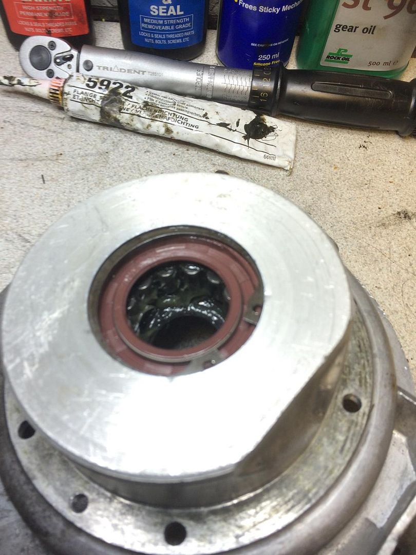

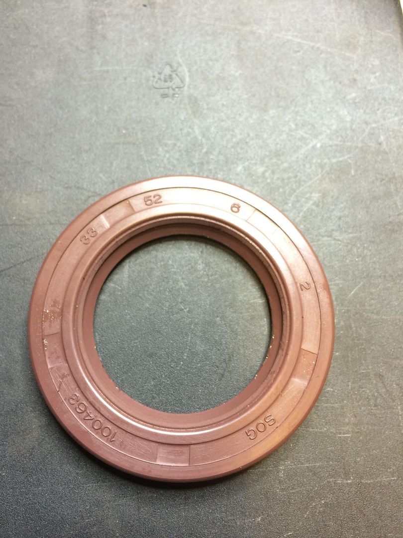

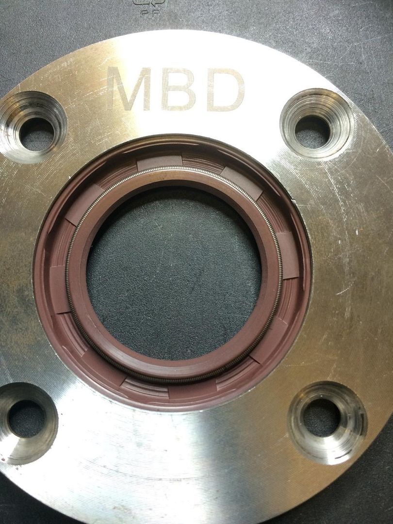

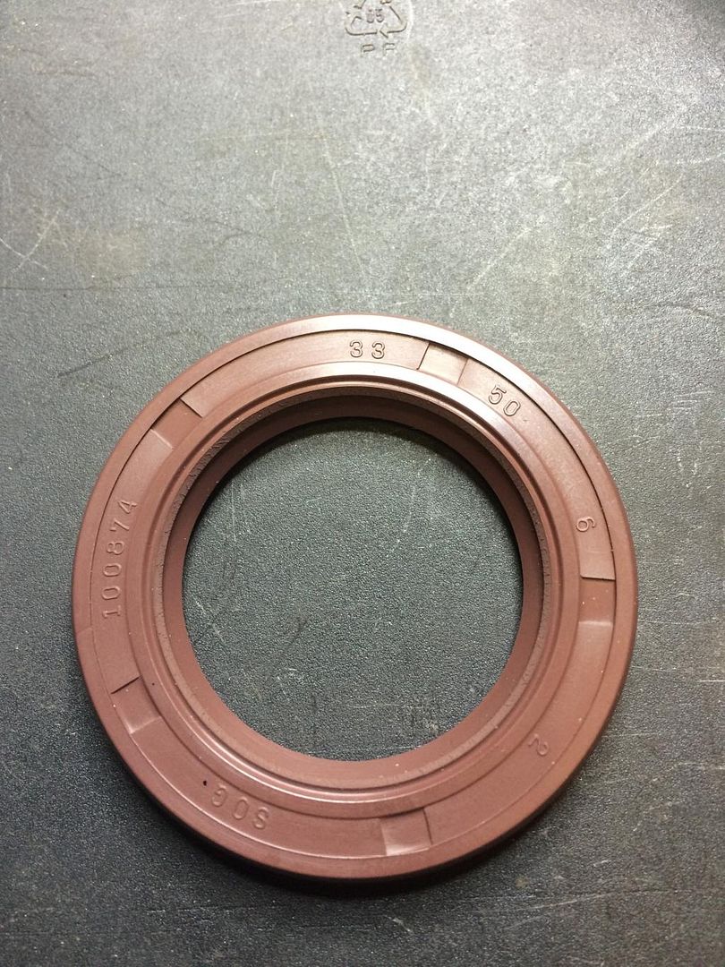

Bought some Viton "A" seals for the rebuild, the set I bought are from Reedspeeds.

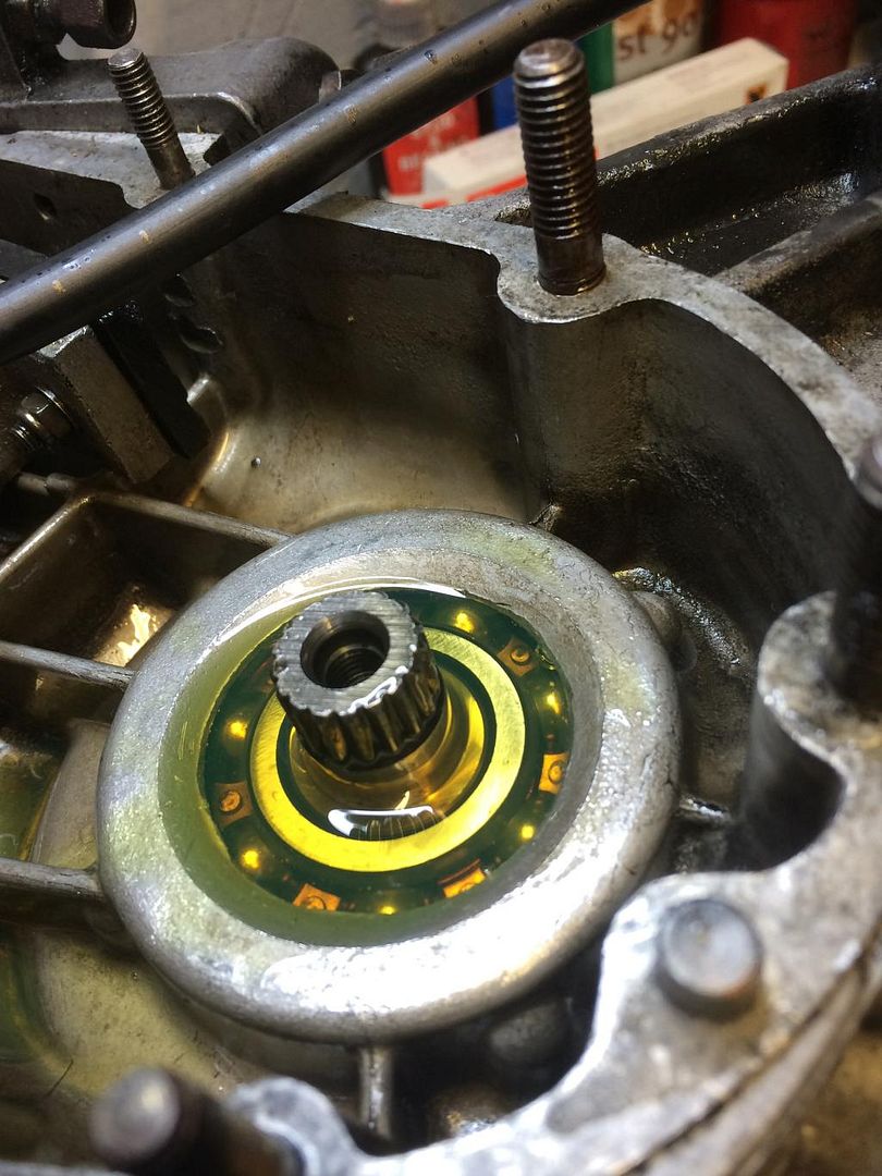

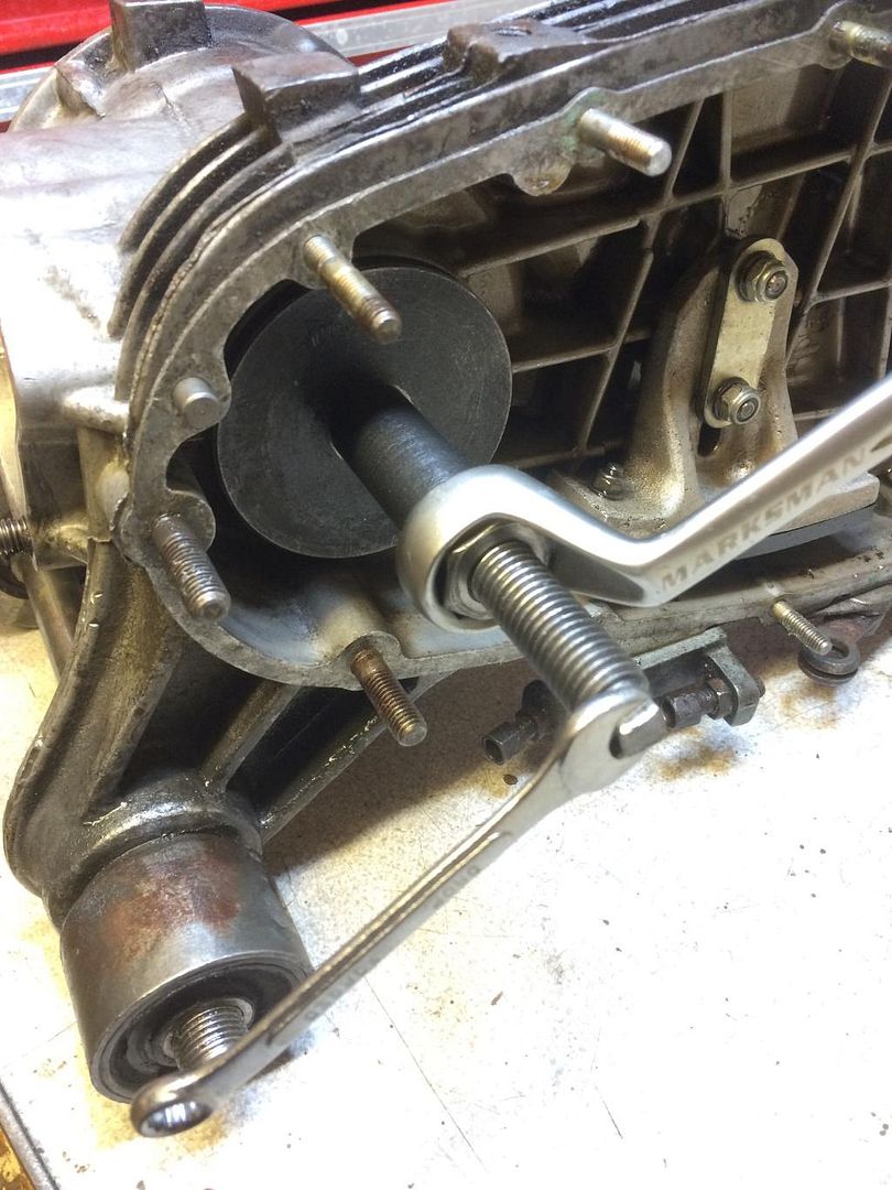

As the seal plate is out i might as well fit a new drive bearing.
This made easy using the bearing fitting removing tool.
Viton seals large mag seal 52.33.6 and drive seal 50.33.6. Both marked up with another number 2 which to my knowledge is the spring strength.

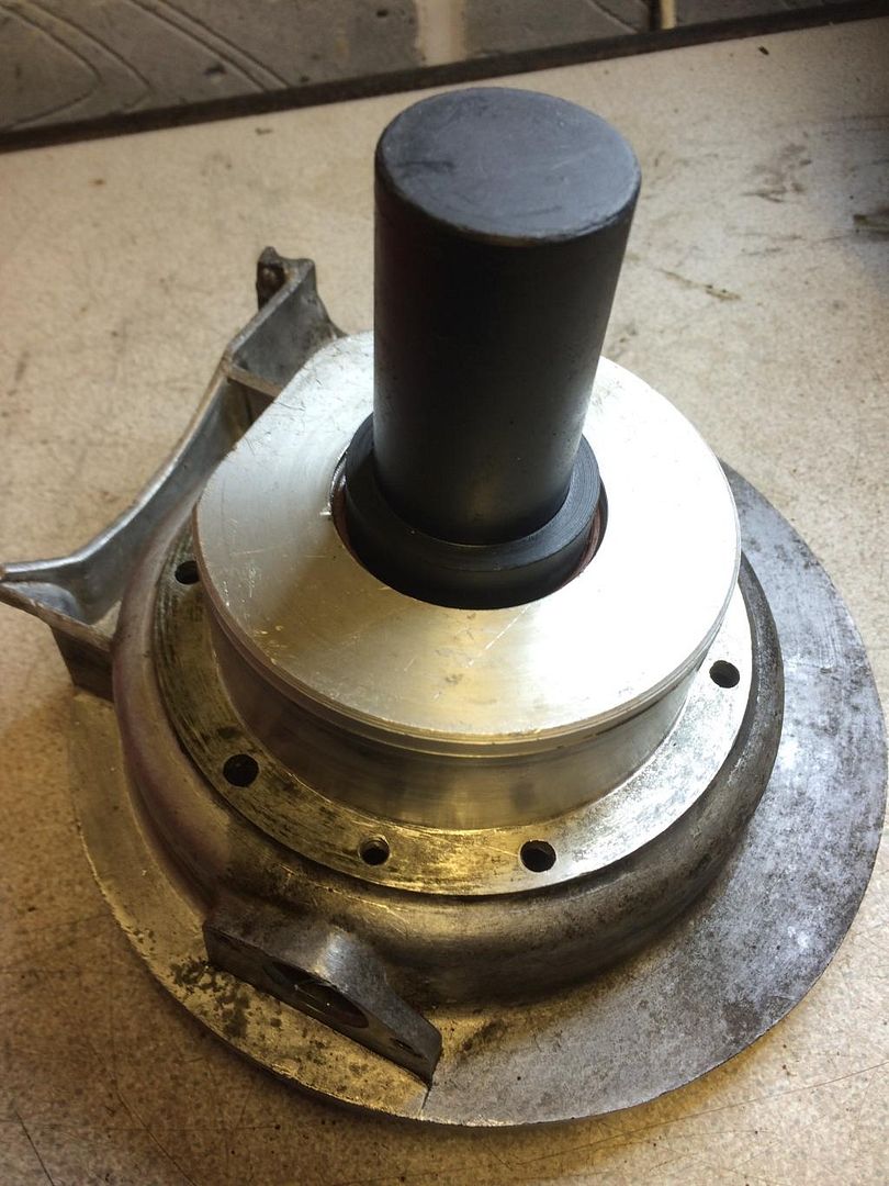

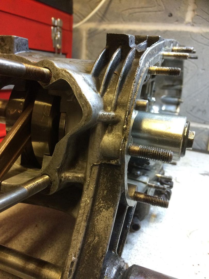

Drive seal pressed in
Mag seal fitted using an MB seal drift.

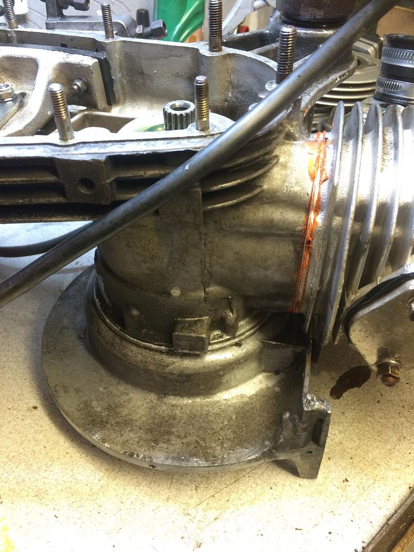

Drive seal plate loctite & torqued up.

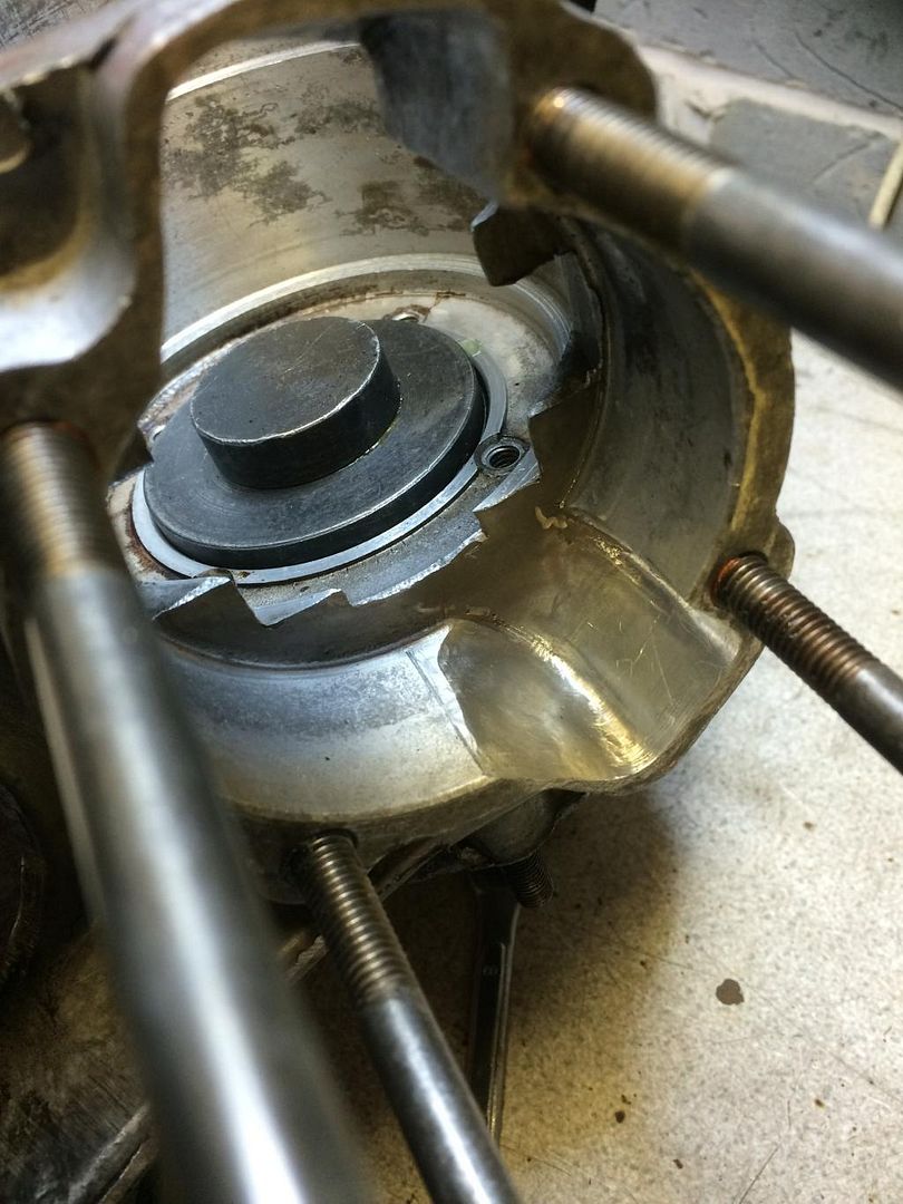

And the crankshaft pulled in with an MB drive side pulling sleeve.

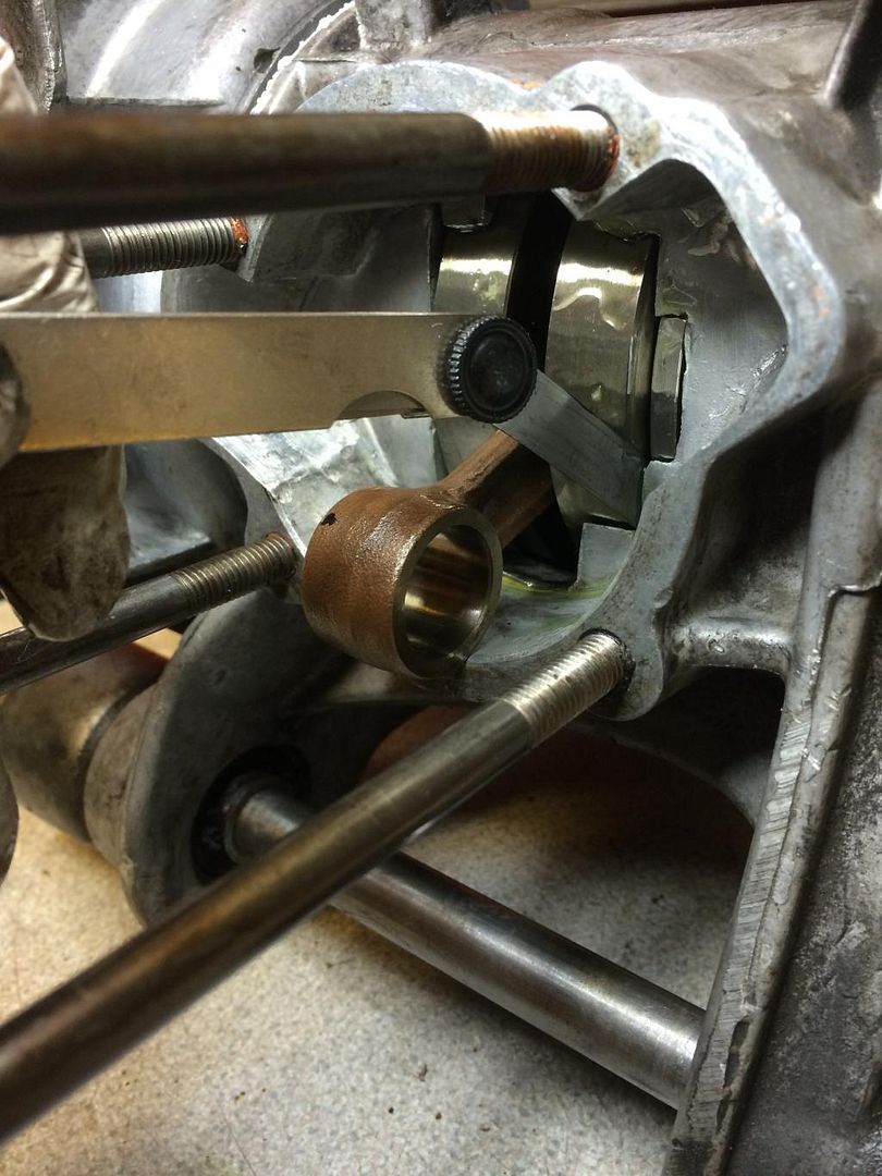

Free run of the crankshaft checked with a 12 thou feeler gauge.
Crank checked on both webbs for even clearance between case at the top and bottom and also down both sides of the crank webbs while slowly spinning the crank.

Postby vintage65scoot » Sat Dec 06, 2014 7:11 pm
Hi i remember reading that the last number is the spring strength and the number should be above 6 ie 7 or 8 etc.
I say this as i fitted some from Reedspeed and the drive side one lasted all of 1 week. All had to be pulled apart again very annoying . This is just a cautionary tale not trying to tell you what to do as your rebuilds and engine builds are what people should aspire to cheers

vintage65scoot wrote:Hi i remember reading that the last number is the spring strength and the number should be above 6 ie 7 or 8 etc.
I had spoken to Reedspeeds prior to fitting these, and I also read quite a bit about spring strength and different Viton compounds. When you ask some dealers what type of Viton oilseals they are selling there does seems to be some confusion.
I also have some oilseals on order from MB to try in another engine and I'm going to order from Scooter restorations.
Mark.
Hi mate,
Your post made me recheck my old and new seals, and it seems I've never used a seal with a higher number than 3 in a Lambretta engine.
The Nitrile seals I normally use on the crank are number 2 for the large mag and drive seals, and the small mag seal its number 3
In the MB seal kit the large Viton crankshaft seals are both numbered 1. They changed the spring strength to a softer spring after customers suffered from failed drive seals on or just after assembly.
But like yourself I really don't want to be stripping down my engine a week after building it just to replace another failed seal, it's a wasted day in the garage when I could be doing something much more rewarding.
But that's the thing with oilseals we usually just fit whatever is supplied, I've never really known what should be in there for the best reliability and I doubt that many others do either.
reading up on Viton seals has given me a better understanding of seals but I'm still no wiser as to which ones to fit for the best results.
If you read up on Viton seals the type ive bought from Reedspeeds (Viton A) are the least resistant to ethanol fuels of all the Viton seals available, so I'm kind of questioning why did they choose them.
There does seem to be very little factual info available to us other than use VITON.
Some basic information stating which type of Viton to choose and why and which spring strength would be helpful.
Plus some basic health warnings that really should go with the Viton seals once they've been used that's just incase they get overheated (300 degrees C) which no doubt some will do heating the mag housing up to remove the old seals at some time.
I would be greatful if you could find any info on the seal springs and if you do could you let me know, as I'm just trying to make my engine a little more reliable.
Cheers, Mark. 8-)

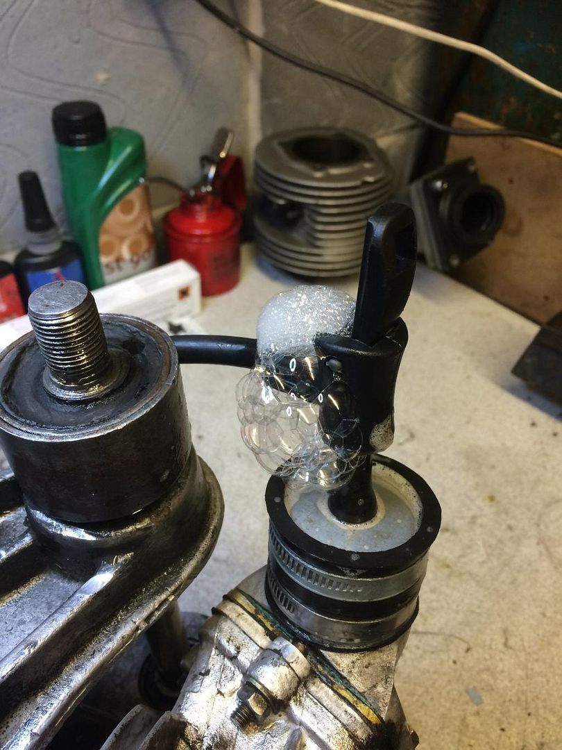

Postby Captain Pugwash » Sun Dec 14, 2014 2:31 pm

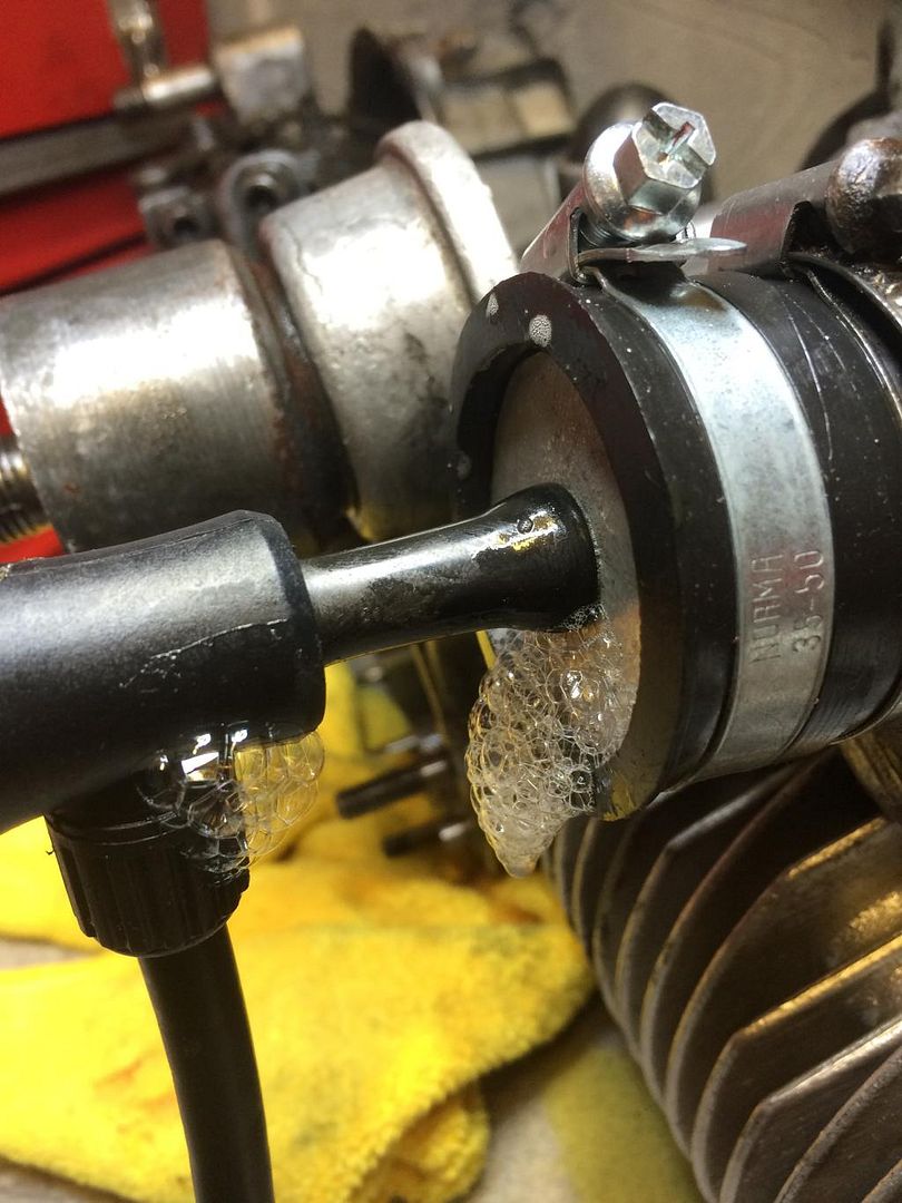

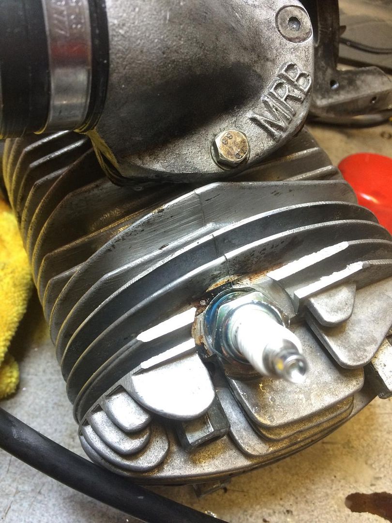

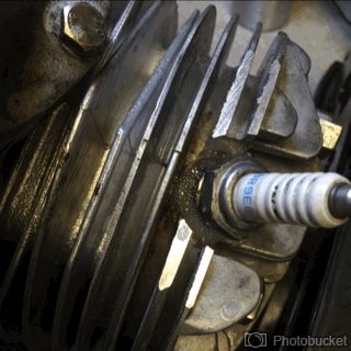

Rebuilt the top end of the TS1.
Pressure tested and found an air leak at the plug.
Cleaned up the plug seat and fitted a new plug and that fixed the leak so pressure tested again.
It was still loosing pressure so I checked the drive and mag seals with oil.
No leaks but the engines still slowly loosing pressure.
I checked every gasket face spraying with soapy water but no leaks anywhere but it is loosing pressure.
The only thing to check was the pump itself and this is what I found.
I've always noticed a slight air loss using this kit but I had guessed it was loosing air through the pump, but I know the engine is air tight.
After 1 hour the pressure was down from about 7.5psi to 5psi but the only signs of any air leaks are at the pump and tyre valve.
