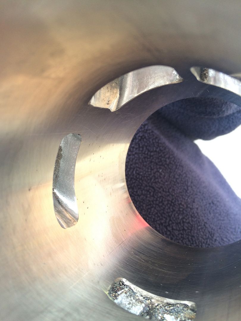

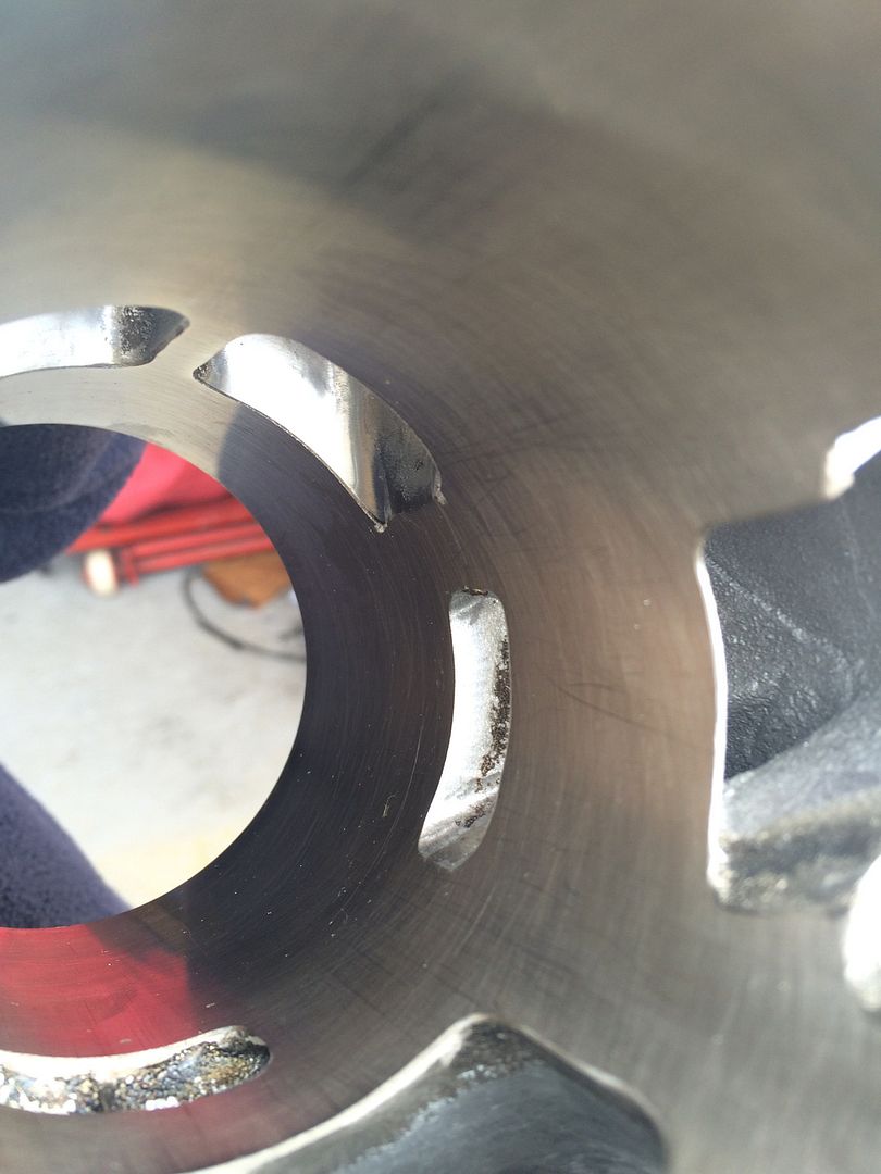

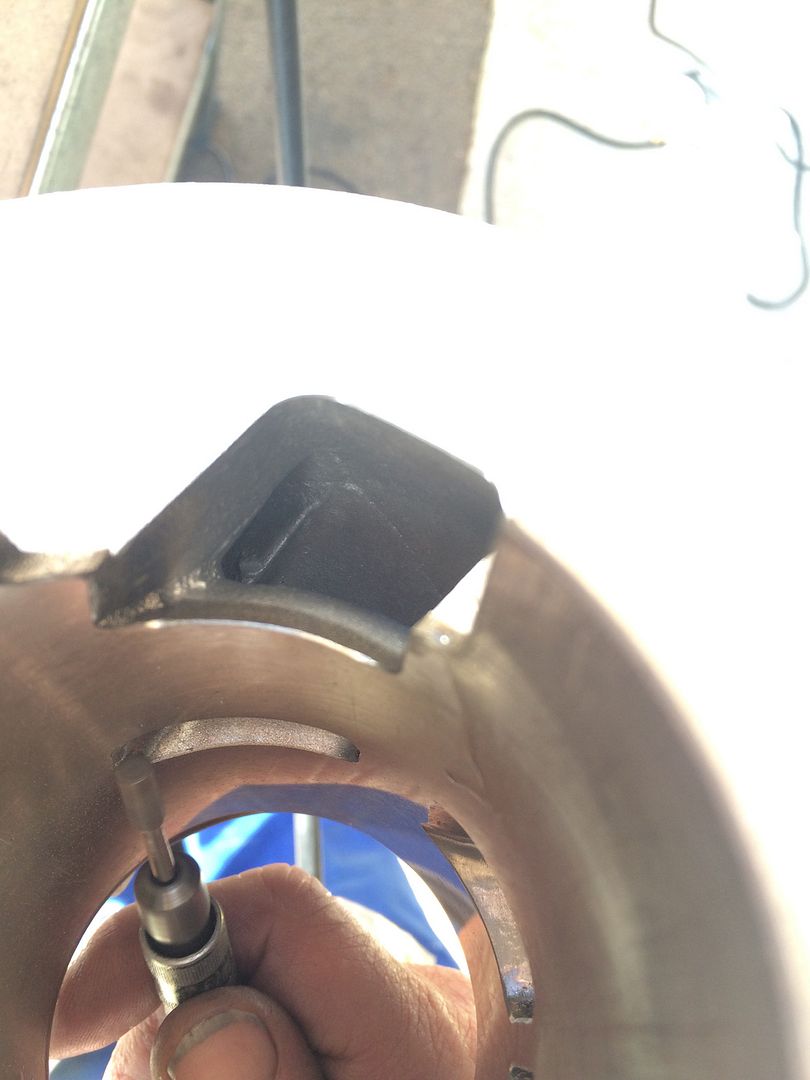

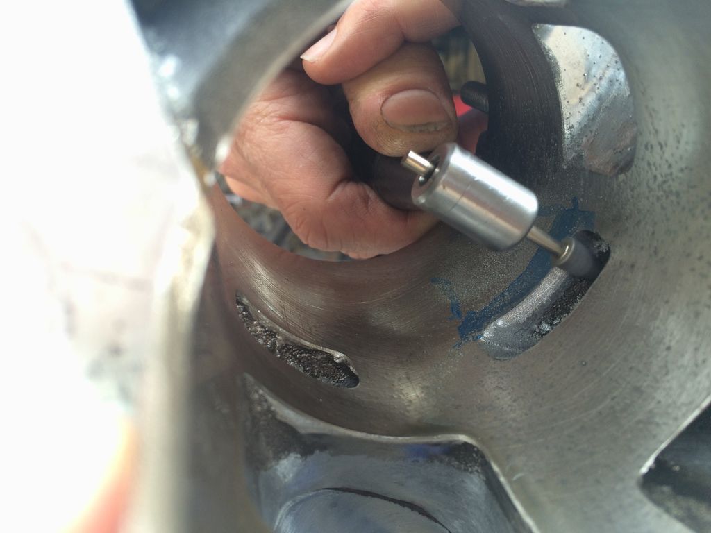

A little more done today.
Barrel held in a rotating jig, it's easier to port.

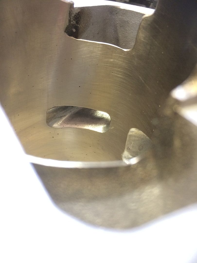

Diamond coated burr 600 grit, starting on the first transfer port.
First transfer. Cut
Second transfer. Cut
Putting a chamfer back on on all the cut edges.

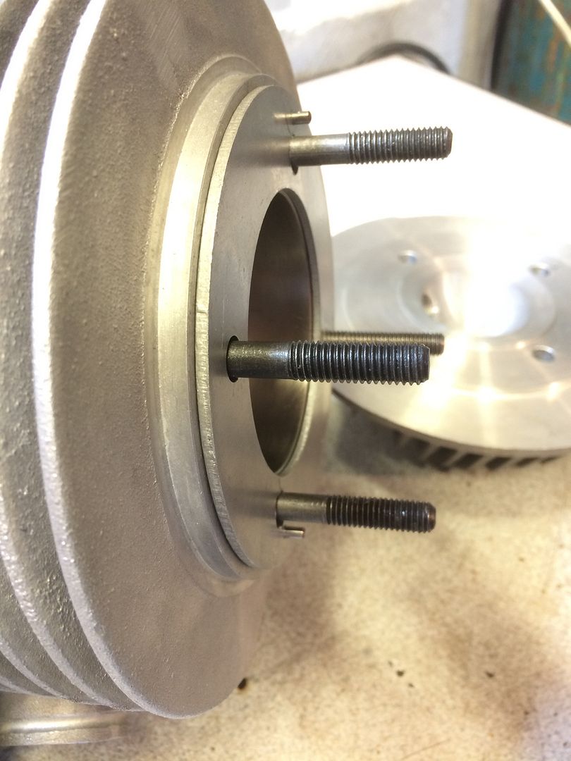

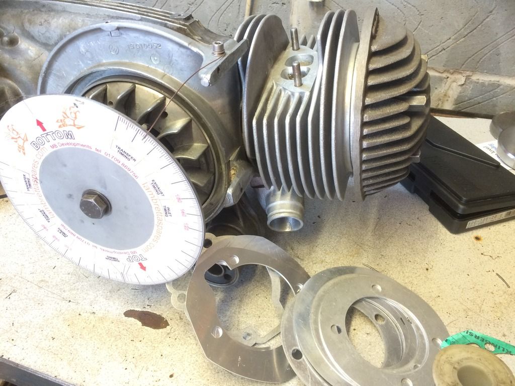

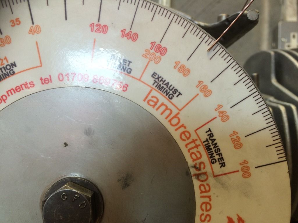

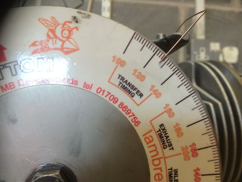

Postby Captain Pugwash » Sat Jul 18, 2015 9:54 pm
After fitting a longer 110 rodded 60mm stroke HB crank I now needed to set the transfer heights as these are now raised a couple of degrees over standard.
New longer barrel studs fitted 170mm, and several differing thickness base packers and head gaskets.
Changing the entry angles of the transfers has increased their duration, fitting a 110 rod and the 60mm stroke helps lower the raised and re-angled transfers.
Choosing a packer to set the transfer timings while using a degree disc.
This is the Exhaust port timing with the packer setting the transfers.
Which seems a low exhaust port height relative to the transfer port timings, but there's more port time area on the wide bridged exhaust port.

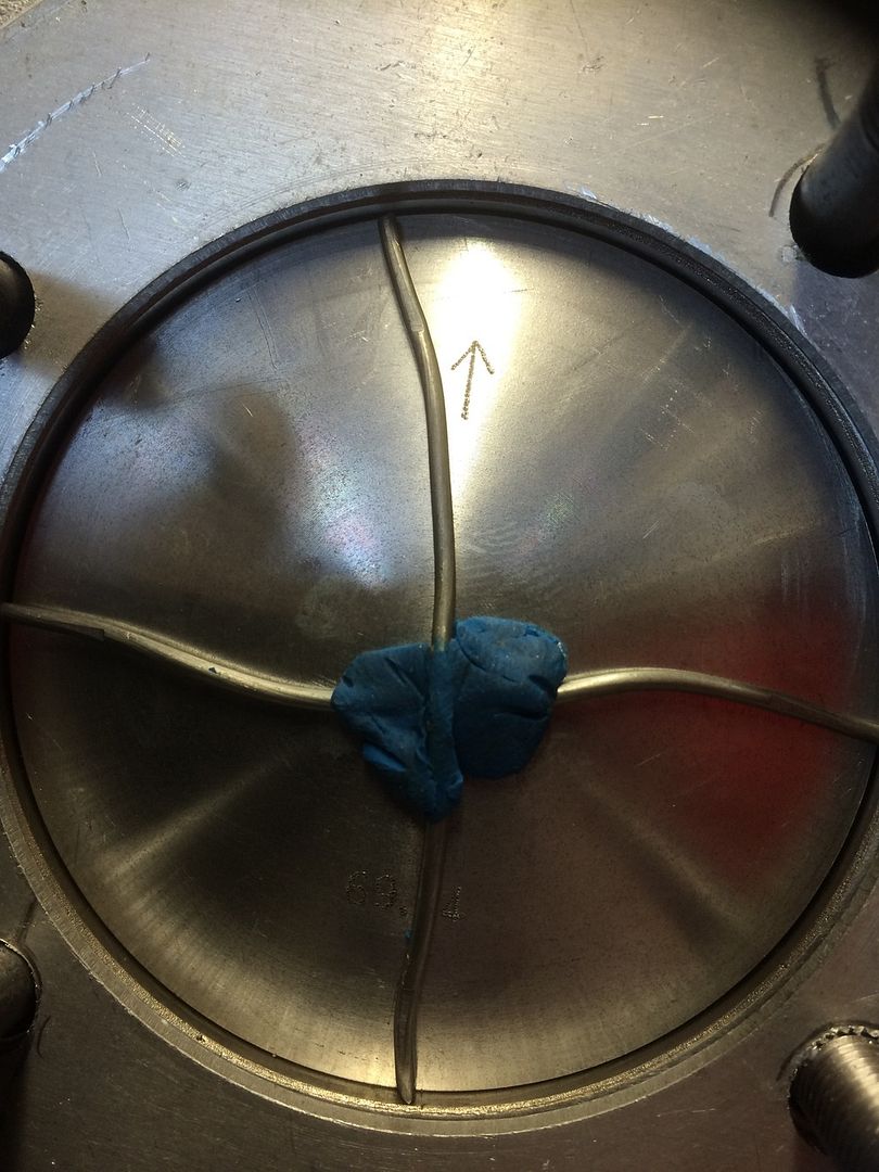

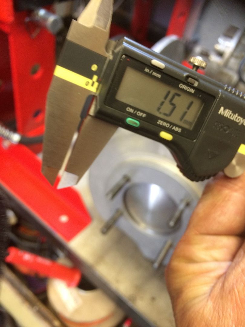

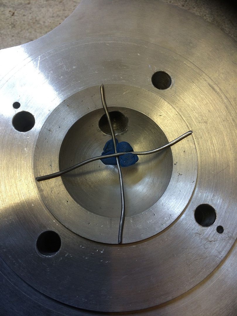

Next I needed to set the squish clearance and after trying a couple of different thicknesses I had a set of base and head gasket/packers. 2mm and 2.5mm
Next I needed to dowell the cylinder-head to the barrel, this is because the thick head packer/gasket now prevents the cylinder head sitting into the bore.
Once the head is dowelled and Centralised the squish can be checked more accurately.

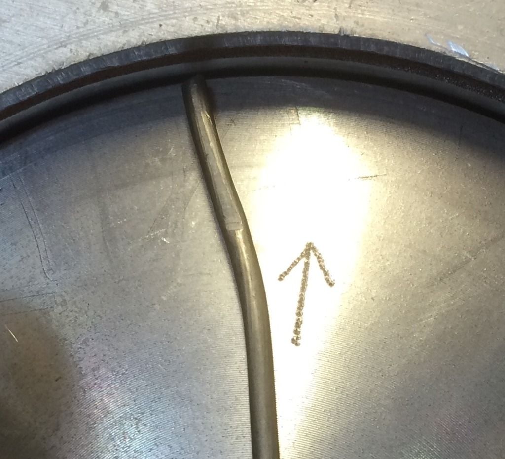

Measuring at four points near centre of squish band.
And measuring the same four points at the edge of the squish band.
The difference can be seen in the impression made in the solder as the solder has been squeezed between the piston and the head, it shows that the profile of the head doesn't completely match the piston, I already knew this from my first dry build. It might look like its a massive difference but it's only a few thou of an inch.
I was trying for close to 1.5mm squish as the extra length on the stroke will raise the compression ratio, where the increased squish clearance will lower the compression ratio.

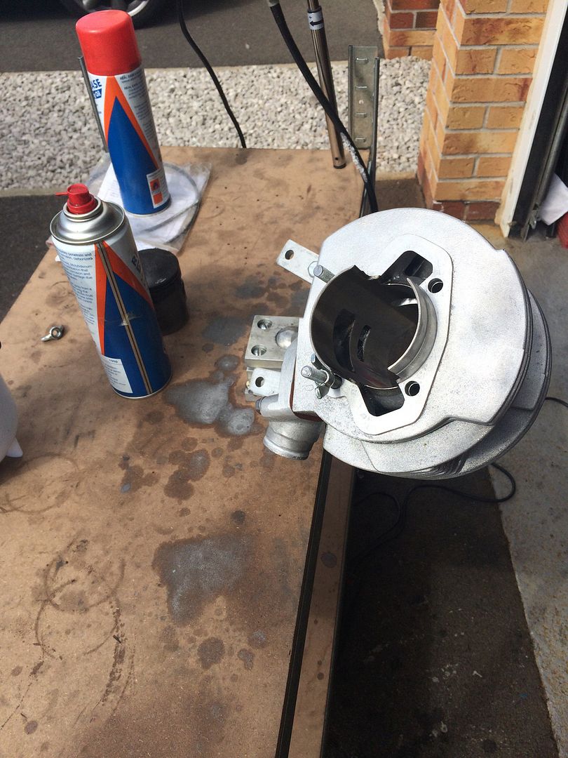

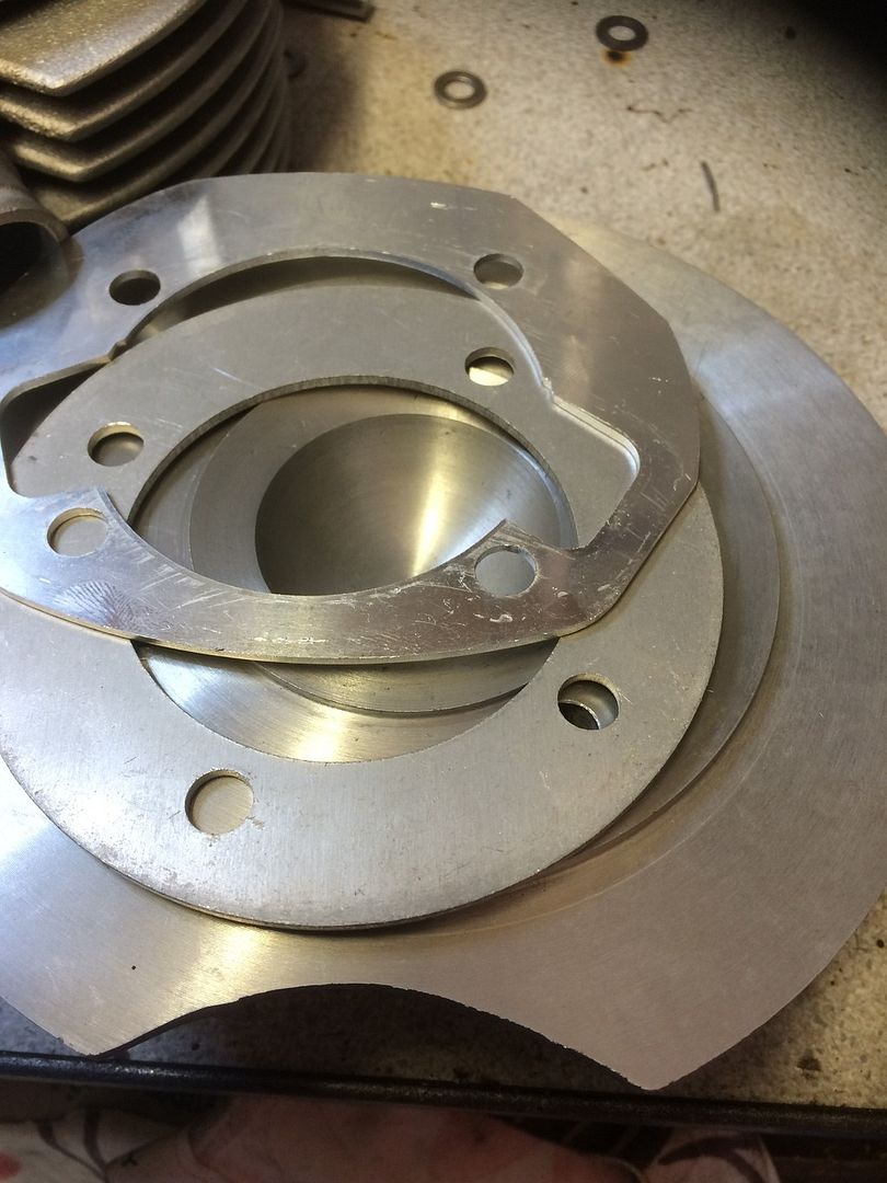

Had a couple of hours in the Garage after getting home from work today, I took this picture before I took the engine apart after the dry build stage.
It shows the head packer/gasket aligned using the head dowels.
It really needs to be done if the cylinder runs a negative deck height as the piston will most likely hit the edge of the gasket if it isn't central to the bore.
A standard Avanti would never need this but mine is stroked out to 60mm with the cylinder lowered this means I have a couple of mm extra piston travel at the top of the barrel.
All parts were cleaned up and checked prior to re-assembly, it was pressure tested at 6psi, it did slowly loose pressure over a One hour time period, dropping to 5 psi.
I hope to find time to Burette the cylinder head tomorrow which will check the trapped volume above the piston, looking for close to 10-1 geometric compression ratio.
