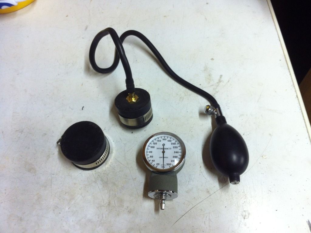

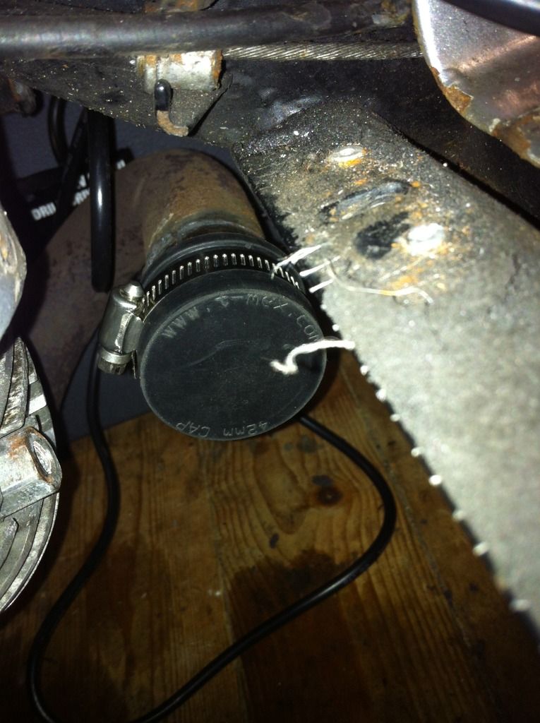

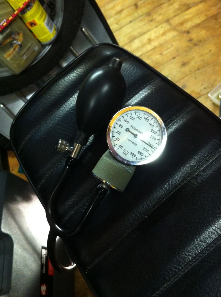

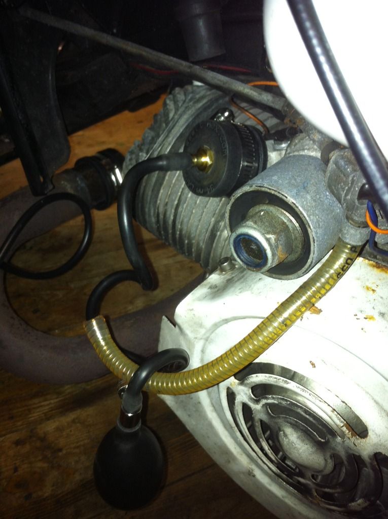

Feersum Injun wrote:I struggled with the inner tube method, I think I just had the wrong size! It would always leak at the carb manifold. Here's the kit I rustled up on ebay for about £15 and it works a treat. Sticky is right about using the blood pressure bulb and gauge. It measures up to 300mmHG which is about 6lb/in2. I used 32mm and 42mm plumbing blanks to fit over the manifold and exhaust stub with air fittings going through the one onto the carb manifold.

That's the one you need. If you look in my first photo I used the the 'y' piece off the stethoscope to the gauge and pump with the longer piece going down to the manifold bung. Use hot water on the rubber tube, it helps getting on and off the fitting ends. I can post my ebay shopping list if you need?

Just to clarify, you need the 60064 1/4" BSP Male and the 53003 1/4" BSP Female air fittings from the drop down menu...

Just checked my order and I did order the 40 / 32 caps and the ones I received where 42mm and 34mm as you can see on my photo. But as it states they are to 'fit pipe size' so they must add a couple of millimetres on. They fit perfectly on my MB manifold and exhaust pipe.

Feersum Injun wrote:Just checked my order and I did order the 40 / 32 caps and the ones I received where 42mm and 34mm as you can see on my photo. But as it states they are to 'fit pipe size' so they must add a couple of millimetres on. They fit perfectly on my MB manifold and exhaust pipe.
Just finished my pressure test with the kit Feersum Indian brilliant bit of kit ,
Only leek I had was on the old manifold pipe wich was a bit pitted so just put a bit of gaskit seal on first before putting the Bung on , I also put a big washer Eather side of the brass air hose fitting again with sealant just to make sure I had a good seal .

Hi could'nt help noticing on pic 3 your engine mounting nut seems very loose . regards Phil. :shock:
